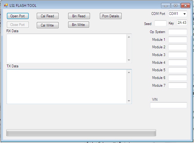

I have been working on this for a while now .
I have designed a cable and software that will :
Read full bin in bin format
Read cal in bin format
Write the calibration section direct from bin file
Only remaining issue to sort out is writing a full bin file so os can be changed ,just need to tweek the bootloader file a bit more when i get time .
No licences are required giving freedom to flash as many pcms as you wish
Watch this space.

- ls1 flashtool.jpg (56.98 KiB) Viewed 13692 times
