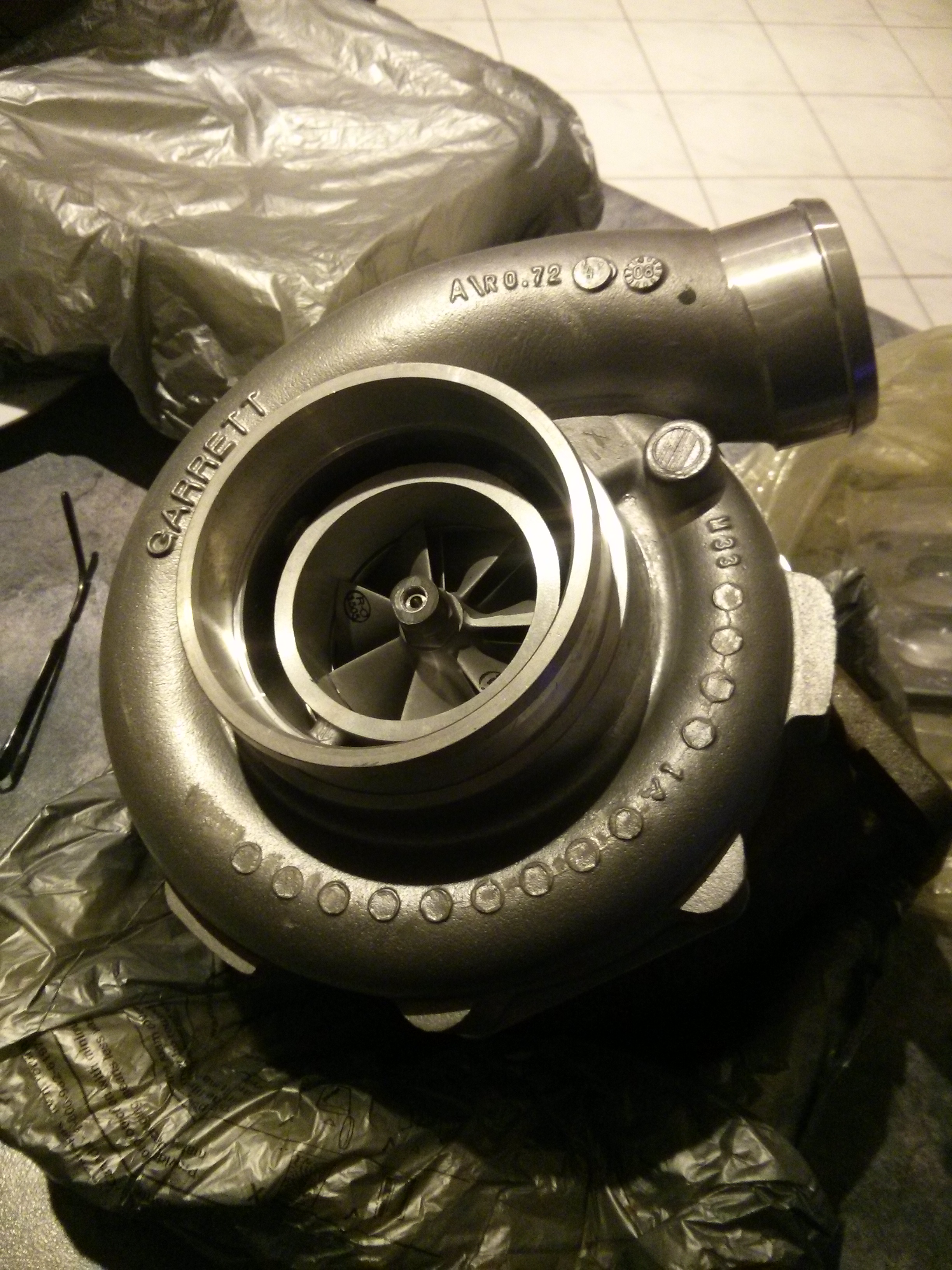

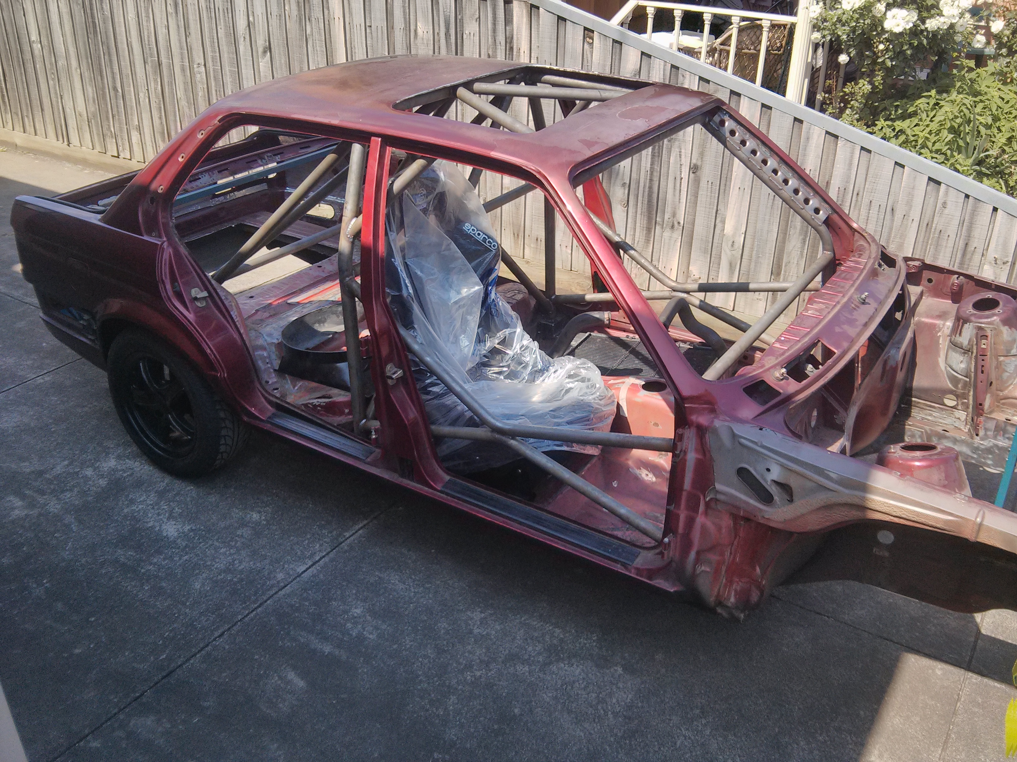

Just an update,
Got myself a turbo GT3788R, roll cage, rear coilovers and some other goodies..
now i just have to put it all together!

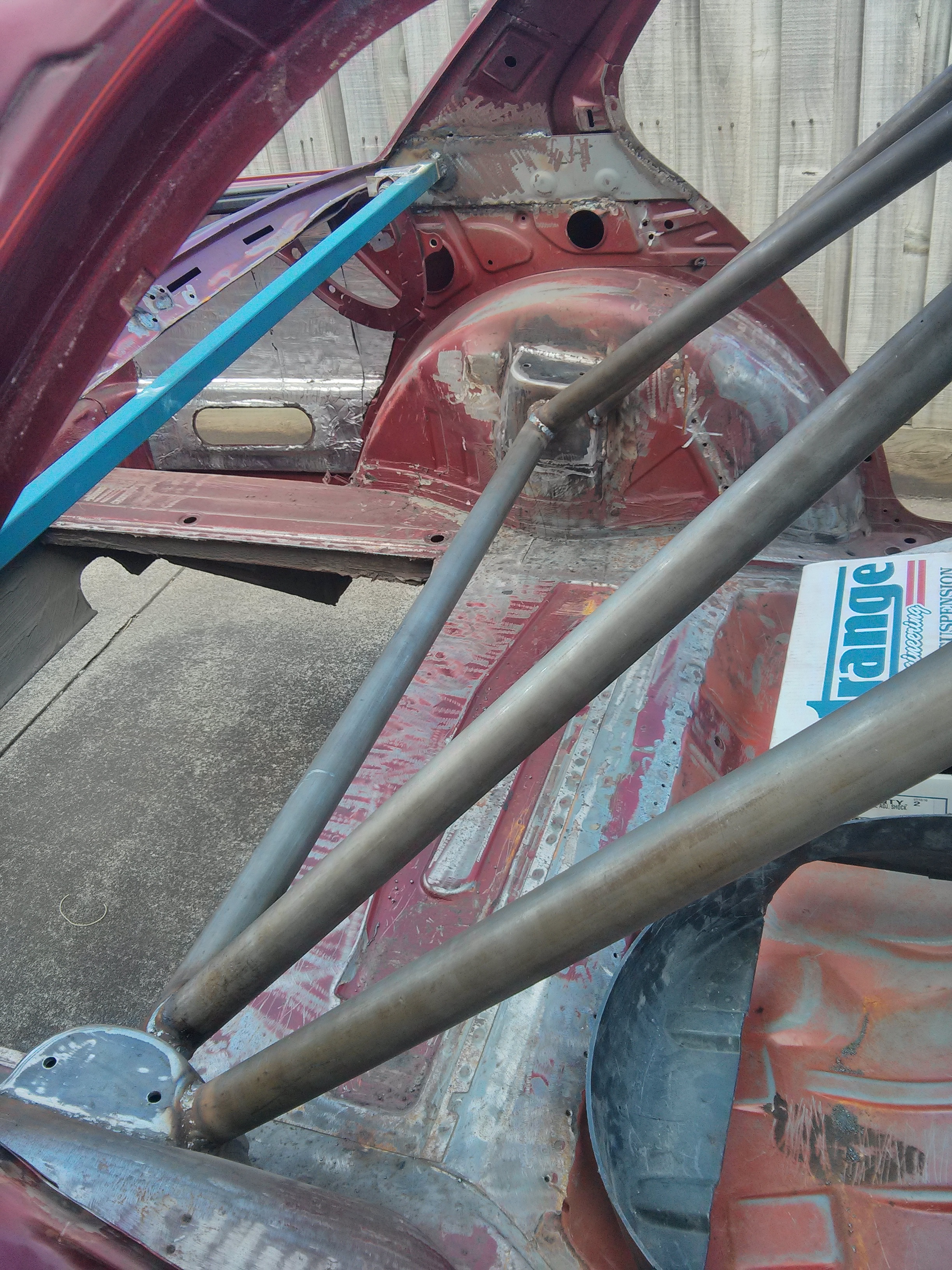

Some nice fab work on the cage, gonna be a fun track car when its all done!
