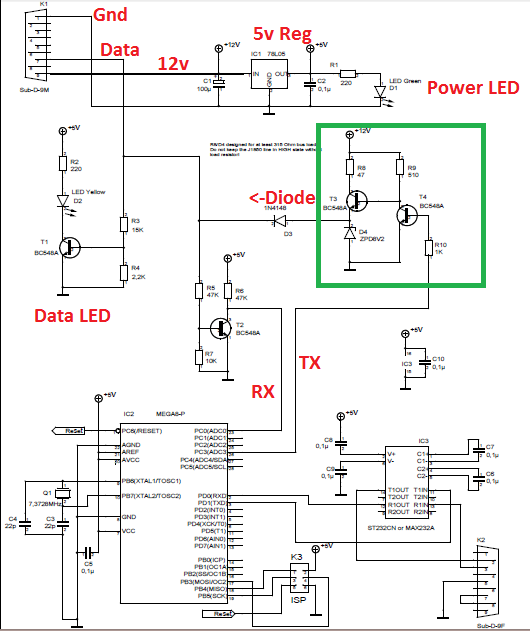

Was going over the schematic, added a few labels to see if there was any parts I can toss for the moment for simple test designs. It probably is a good idea to keep it as is since it would be nice to see when data is passing through, and when the device is powered up.
But, highlighted in the green square.. Im a little lost whats happening there? I thought this would be connected to 5v, since well.. its not really a constant 12v from the car, this can fluctuate from 10v to 14ish volts, any idea if this will be an issue?
Also, I not too experienced with Eagle or pcb designing software, really appreciate if someone could draft up the diagram below for an arduino shield of some sort. Just dont need the atmega8 chip or max232 chip. Board only needs to connect to the rx/tx pin, power and gnd.
Re: AVR to Arduino - VPW
Its a buffer/driver that clamps the battery voltage using the zener (8.2V) and current limiting resistor. The forward volt drop of the diode D3 drops it another 0.7V or so to keep it within the VPW spec of (I think) a nominal 7V for a high.
