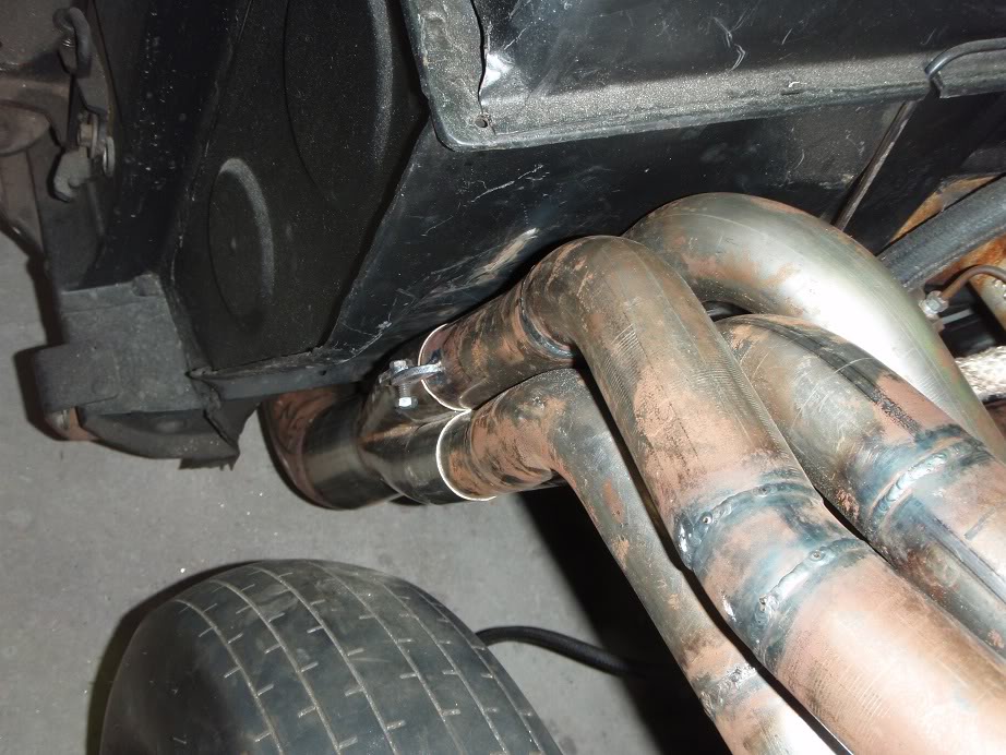

Got some new equal length pipes installed - 34" primaries, 1" 7/8 pipe, 4-1 collector with 3.5" outlet ...

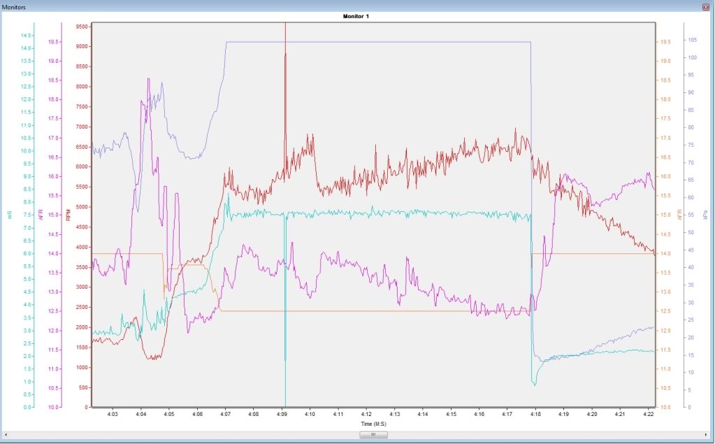

Then went racing :thumbup: Finally had a chance to give this new logger a test on the car I built it for! Logging a custom message at 30Hz it has showed up some serious short comings of the current setup :( The RPM signal is crap (noisy and occasional misfire with a super high RPM reading) and we are seeing possible fuel surge/pump issues where it leans out at half track (peak VE) on some passes and not others yet inj PW is identical. So we will add a fuel pressure sensor and log that next meeting. So here are two pics, the first is TP showing the RPM, target AFR, wideband (logged via one of the loggers analog inputs), MAP and fuel PW...

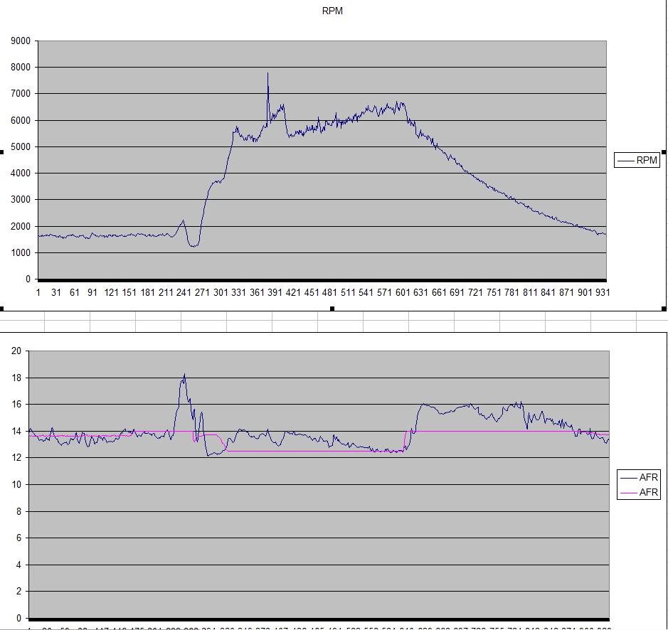

And and half the sample rate so has less noise but still rubbish...
Going to change heaps of the ignition parts, running the wrong leads to start with, so hopefully can get a nice clean RPM signal. Have added more fuel for the next time out as its leaned out heaps (as can be seen with the target vs actual AFR) with the new pipes, needed about 7% more fuel to bring it close, prob going to be closeer to 10% when all done. The upside was, even with the poor tune and issues it ran 10.23 @ 129 MPH :thumbup:

good results with the logger by the looks of it!
the old val isn't far off a 9!

Had a test and tune yesterday, spent the day trying a few things to get the RPM signal nice and clean but was not able to improve it at all - new leads made it worse so went back to the original ones, moved the wiring all around for the reluctor pickup and even disconnected the alternator. Next up is to try a different ECU and camira ign module. Even the tacho went spastic on one of the runs.
Wired up a pressure sensor on the fuel rail and logged it via the Logger, can see fuel pressure dropping right off during the run so ordered a new 044 pump for it. Currently runs a second hand 984 which has proved itself well over the last 4-5 seasons - just cant cut it now with more cubes. We run 42lb inj at 55psi rail pressure, works out to around 48lb. Injector duty cycle peaks at 80% at which point its needing around 180l/hr of fuel, the 984 is rated at 165l/hr at 5 bar. Its prob close to what we need at near on 4bar but being a second hand pump that was pulled from an old merc I doubt its still pumping like new.
Had 8 passes in 35deg heat and ran 10.25-10.33 all day - 10.25 was with no alternator and two 10.33's were with the new leads. The rest were all 10.27.
