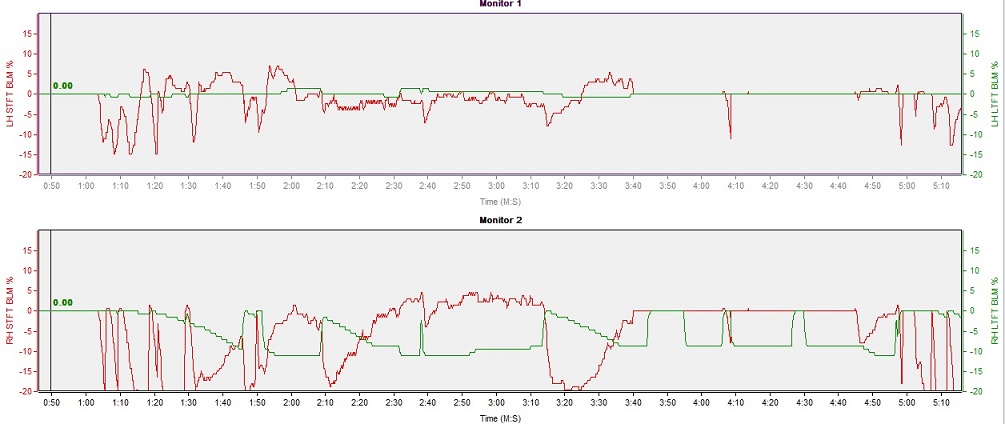

So, chasing the mystery of the rich bank on the fuel trims.
This morning I performed a compression test. 170psi all around, give or take 5.
Swapped the injectors from the side to side.
Even swapped the plugs to a different set. Gapped and cleaned to 1.3mm.
Its rather scary to watch the RH STFT go over -20% after an ecm reset. You can watch it learn and update LTFT.
Something has to be wrong, but I'm out of ideas.
Except maybe,
Exhaust manifold leak contaminating the sensor?
Rocker arm or lifter not opening a valve fully....
Might just leave the laptop unplugged and forget I even noticed. But that is poor workmanship.
