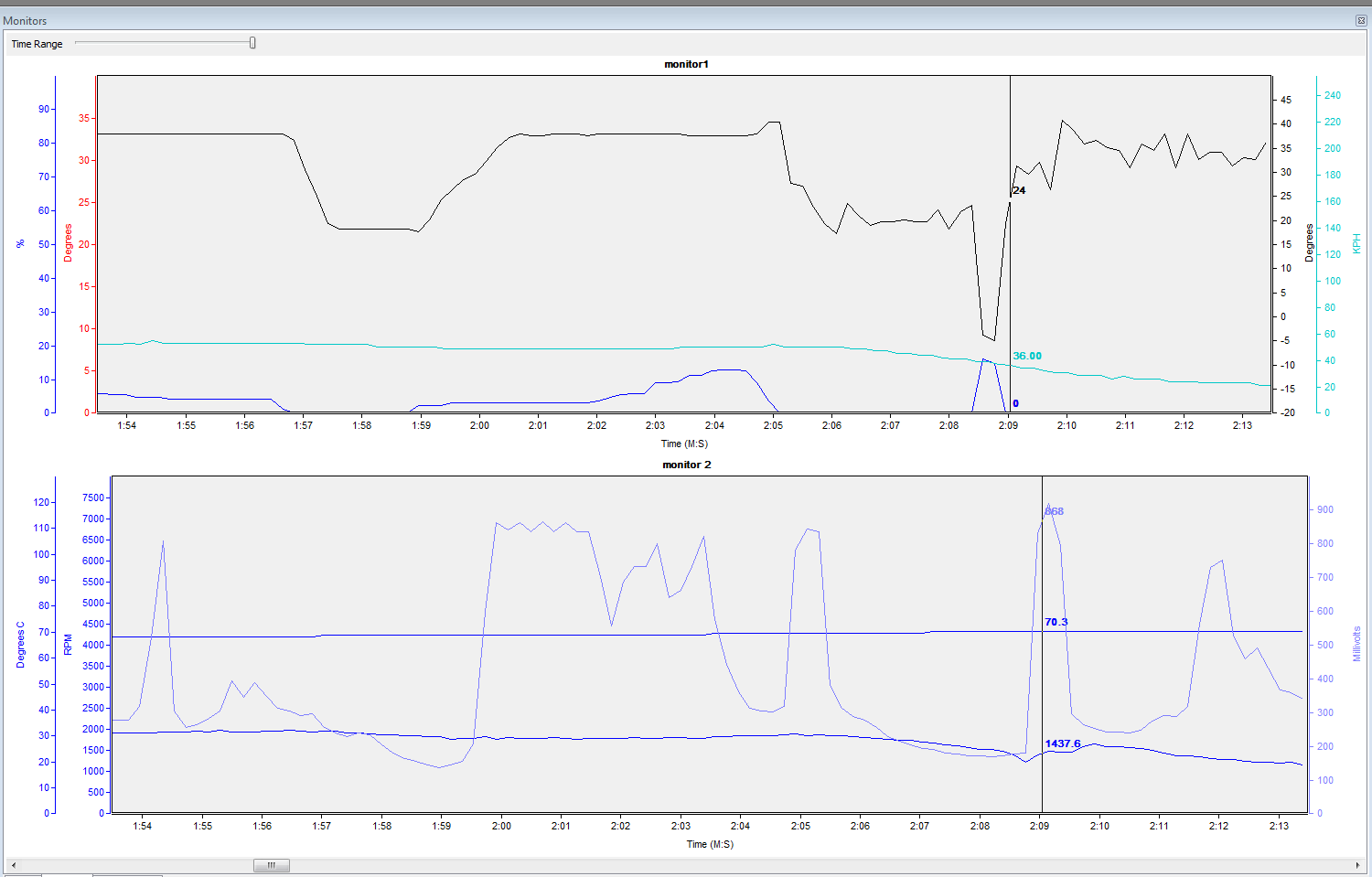

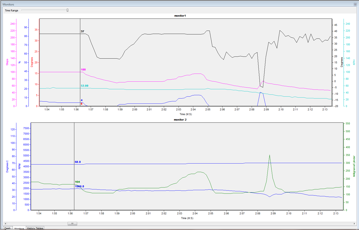

Hi. I seem to have rid the car of the "pinging" under heavy load up hill in too high a gear, but unfortunately after a couple of weeks and a couple of dozen tweaks and untweaks, I've got myself in a right mess with the tune. Can someone please offer any advise as to where I've managed to cock it up, which is probably in a lot of areas. It idles reasonably when hot, but stalls when cold even though the "Idle speed vs coolant etc." charts are set for a high idle, I've got the IAC steps down to 50 at idle, the spark tables match in the idle areas etc etc.
In the screen shot of the log, the IAC steps should be at 75 (according to the table) where the cursor is, not 100, when the throttle is closed, the spark advance drops with it, and @ 2:09 when I change back a gear, the throttle % goes up, the MGC goes up and the revs drop and the spark advance drops alarmingly.

There is WAY more going on that changes the IAC steps, and at 50+ KPH its not going to be what you have in the table. Things get added when your moving for things like emissions, things get learnt at idle to become a new base idle IAC value.Monarols71 wrote:In the screen shot of the log, the IAC steps should be at 75 (according to the table) where the cursor is, not 100, when the throttle is closed, the spark advance drops with it, and @ 2:09 when I change back a gear, the throttle % goes up, the MGC goes up and the revs drop and the spark advance drops alarmingly.[/attachment]
The point at 2:09 could be lean, look at you O2 volts or wideband.
Posting the bin and XDL might help further.

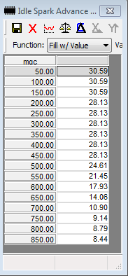

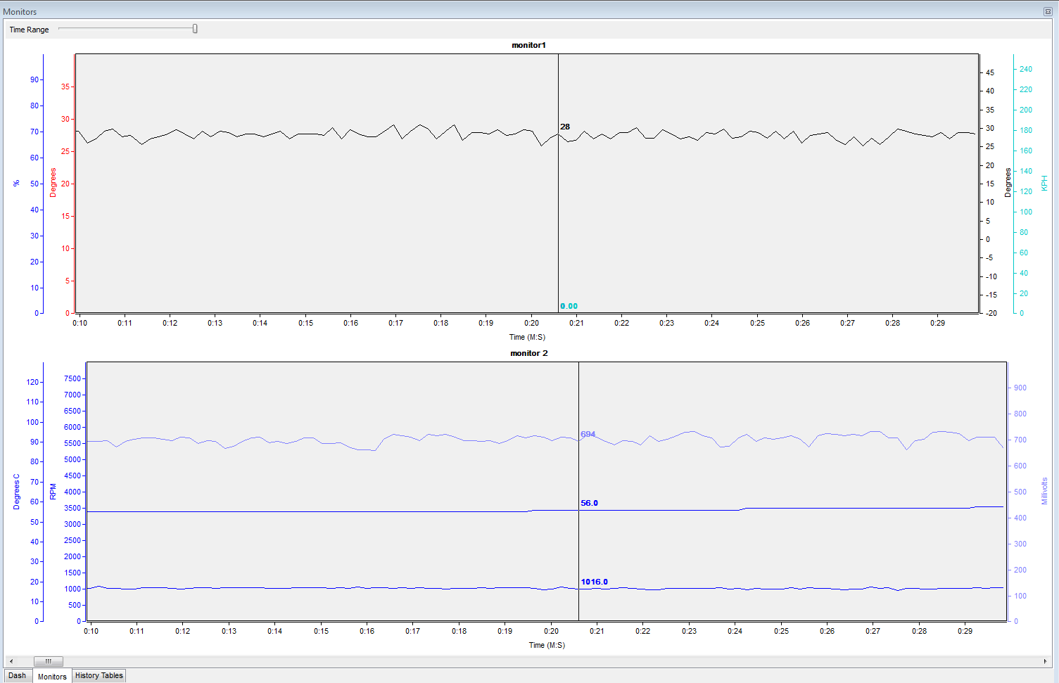

Thanks again. Here is todays log and idle spark screen.

What's your target idle afr? Actual afr could be a bit lean by the look of it.
