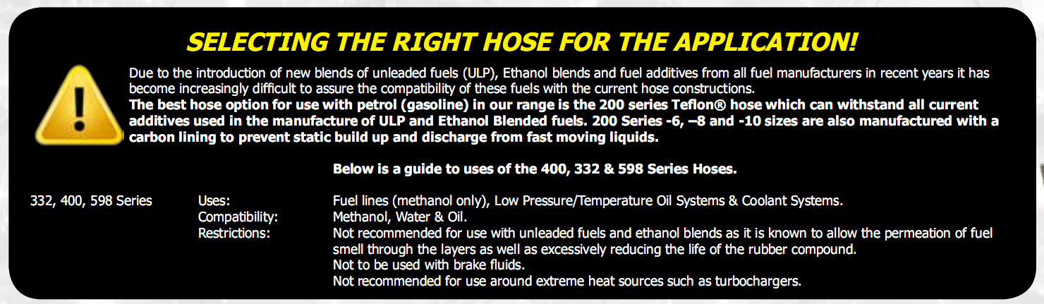

From Speedflow's catalogue, and I've pretty much read the same thing from all 400 Series Hose manufacturers. They all state their 400 Series hose is E85 compatible, and then recommend that you not use it for fuel. Instead, they recommend you to use their 200 Series PTFE Hose, but it doesn't end there. Not all 200 Series PTFE Hoses are the same. A few manufacturers offer an inner anti-static lining, but in only certain sizes, and it may just be that only the anti-static lined hoses will pass engineering.
