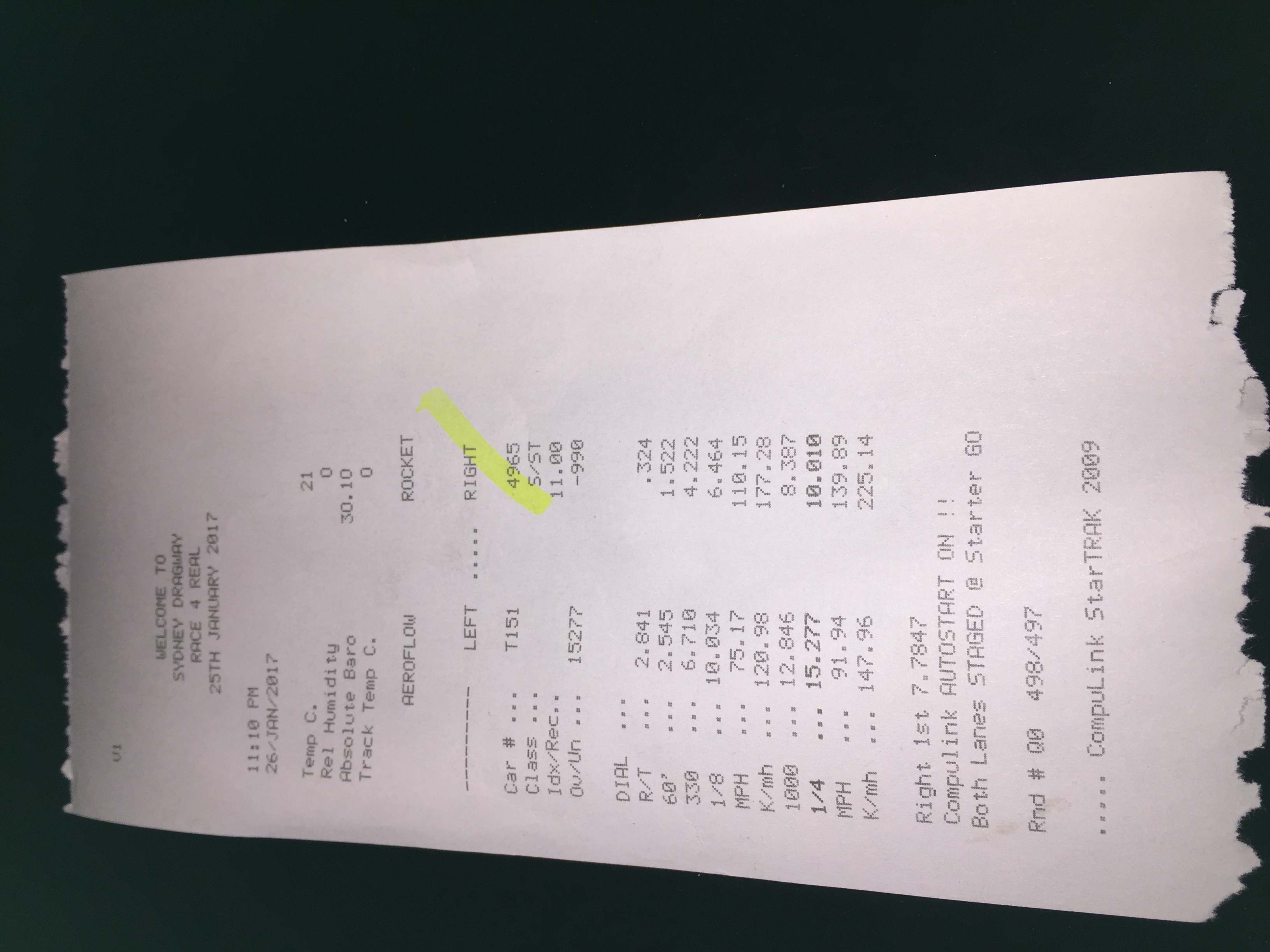

Re: 95 VS 355 VORTECH V2

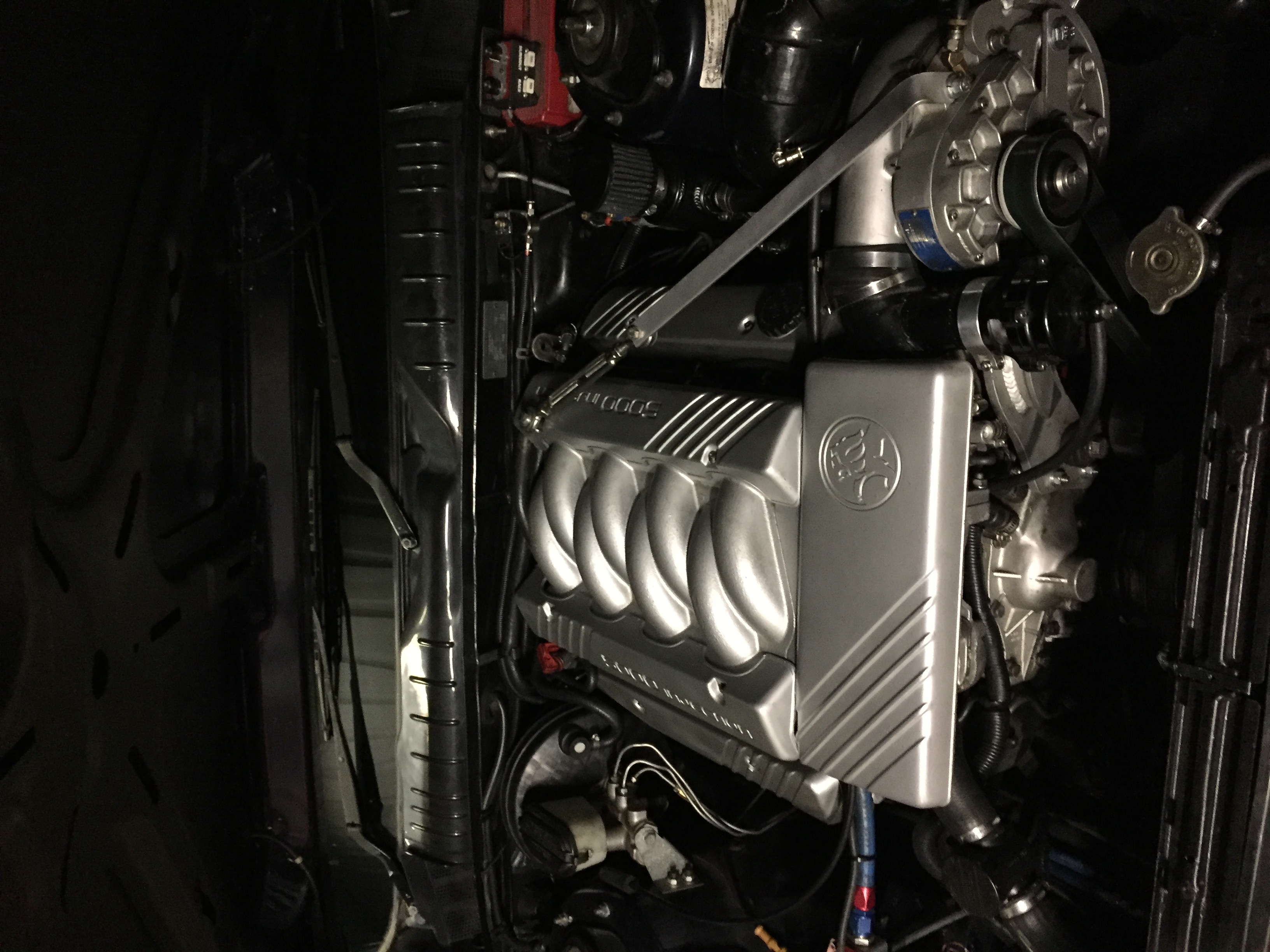

Update - Getting close to a 9 now!! Ran 3 10.0s in row same night best was [email protected]
Also put an extra brace on the blower to the manifold to stop the bracket flexing and throwing the belt.
Havent had that problem since.
https://www.youtube.com/watch?v=CzB-3VY1OpYPaulR wrote:Update - Getting close to a 9 now!! Ran 3 10.0s in row same night best was [email protected]
That's really crazy with the banana's manifold on there.
Gotta be happy with that, very tough little combo (who said side-mounts are no good?)
PaulR
- Posts: 51
- Joined: Sun Nov 30, 2014 5:39 am
- cars: VS 355
yeah pretty happy going to run with bannanas through this winter and see how far can push it, looking at maybe putting a come twin throttle or Harrop manifold. i reakon there will be some good gains in the top end!!
