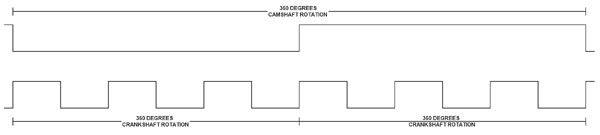

Here is a 4.3 V6 low res crank and cam pattern look like.
4.3 cam crank waveform.jpg (6.83 KiB) Viewed 8020 times

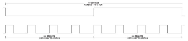

Here is the V8 low res crank and cam pattern.
V8 cam crank waveform.jpg (7.57 KiB) Viewed 8007 times

Thanks haven't got the V8 one too have you?

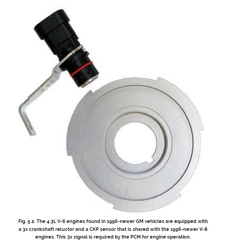

Found picture of OEM V6 Low res crank sensor.
OEM V6 sensor.jpg (89.73 KiB) Viewed 8011 times

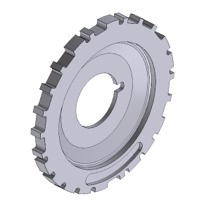

This is the 24x conversion sensor wheel
24x conversion.png (33.35 KiB) Viewed 8011 times
now if I can make it fit a V6 balancer.

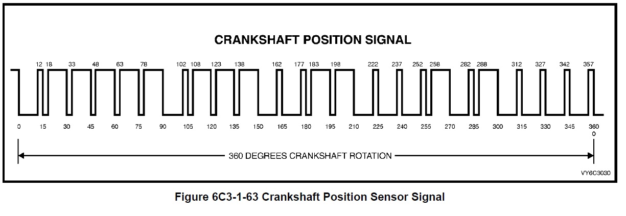

here is the 24x sensor wheel to degrees.

There's a model can't remember the name of V6 with the 0411 and it takes the 18X 3X crank and 1X cam. I'll see if I kept the link or maybe you're onto it all ready. Haven't followed the V6 to much so looked over it quickly.
Apples
Posts: 151
Joined: Sun Mar 01, 2009 9:57 am
Location: Darwin, NT
Re: 12200411 tune Disassembly (12225074)
Post by Apples »
I haven't seen a V6 using 18x 3x and 1x cam on a 411 from the factory.
that's not to say they don't exist.
