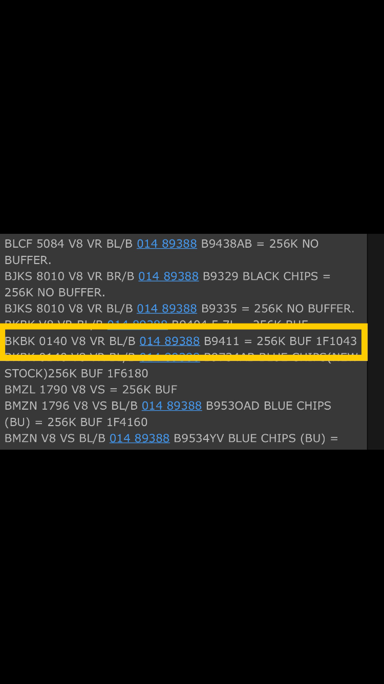

So the hsv memcal gives me two possible types, any clue to tell any difference or if there is anything different between the two? I can't see the code that is normally viewed through the left window on the memcal as it is covered with h a sticker from the shop for that tuned it which is just their logo. Only code I can see is the '1F1043' which I assume is the knock filter code??
Posts: 10435
Re: Different '424' pcm's
from the info I have BKBJ is 94 model 5.7ltr auto (424 pcm) and BKBK is 94 model 5.7ltr manual (083/305 pcm) both are for 215kw HSV's.
so if you have a 424 that pretty much answers which of the two it is.
