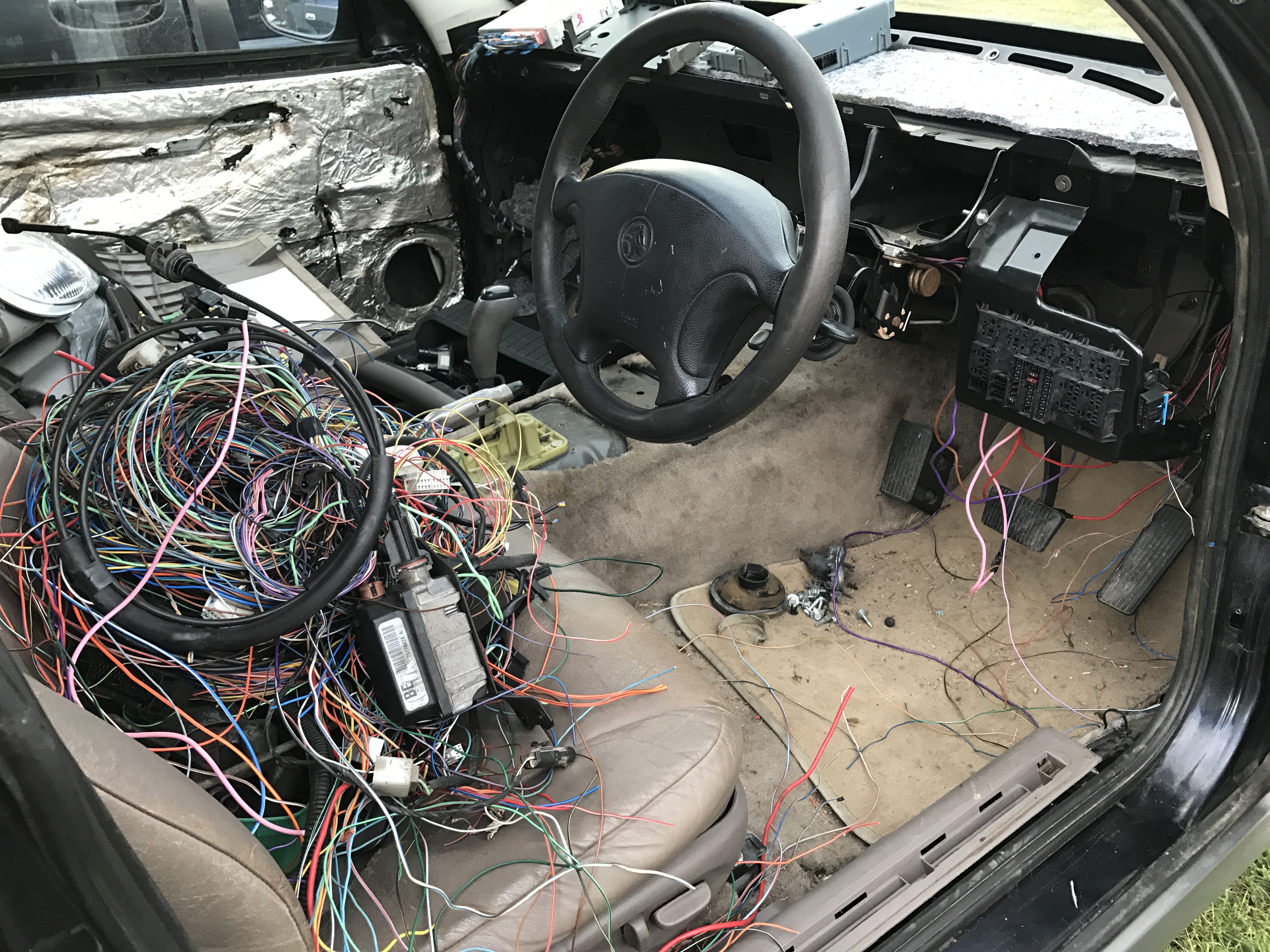

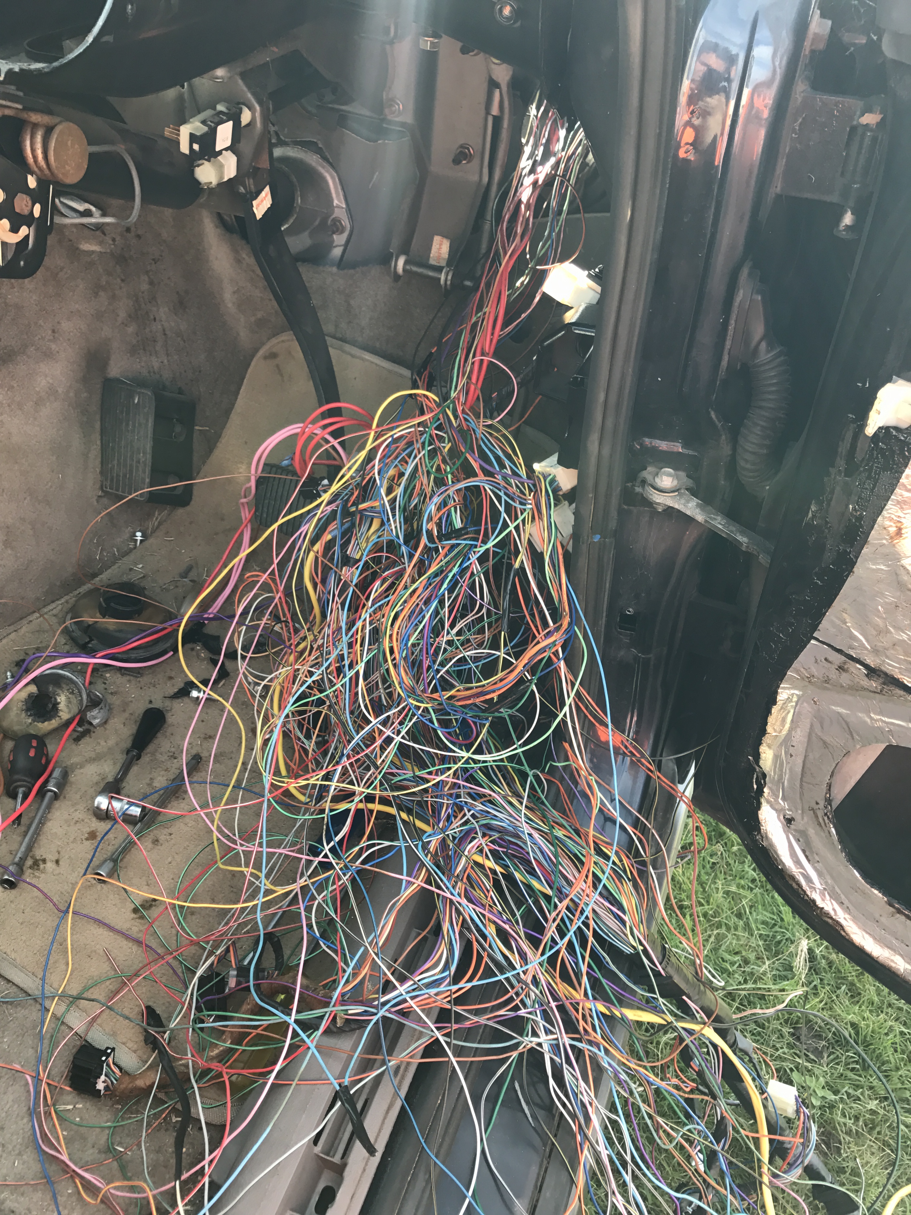

I was de-looming the car today... there is a TON of wiring and parts I wont need.
I've removed the whole dash and guts. There is SO MUCH STUFF in the dash, no wonder they weigh so much with the climate control & electric everything
I have the trailer beside the car so I can throw is all out (so much AC/heater duct tubing)
I'll probably sell the whole interior if anyone wants it, it's the tan leather interior.
Will I need any part of the BCM wiring & BCM connected to run the engine if I turn VATS off on both NVRAMs?

Crazy spaghetti
So much wire, so little dash:
