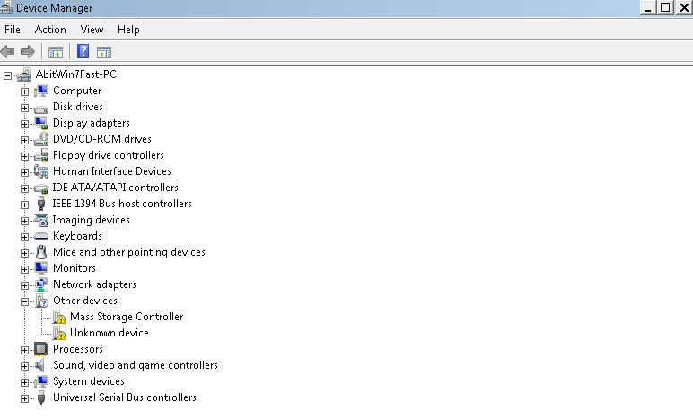

O.K. this 1.8" SSD is now pissing me off, it's a genuine Intel SSDSA1M080G2LE & can only find 1 PC that actually detects it but can't find drivers to install for it anywhere...
So I went to Intel site & used to be able to just run the program in website to detect & update Intel drivers but now they only have installer program & tried installing that & get this error message...
0x80070643 & I posted on intel support about that but 1 problem keeps leading me to another WTF???

Is it an internal sata drive? ssd shouldnt need any driver, but the controller on the computer motherboard might. try the laptop manufacturer.
- Posts: 2971
Re: Win7 x64 lost hdd partition
it's a 1.8" Intel SSD that then goes into a special caddy to go out to standard 2.5" size to fit into the Lenovo Thinkpad T410 but the only drivers they have/show is for SSD firmware update that I can find.
