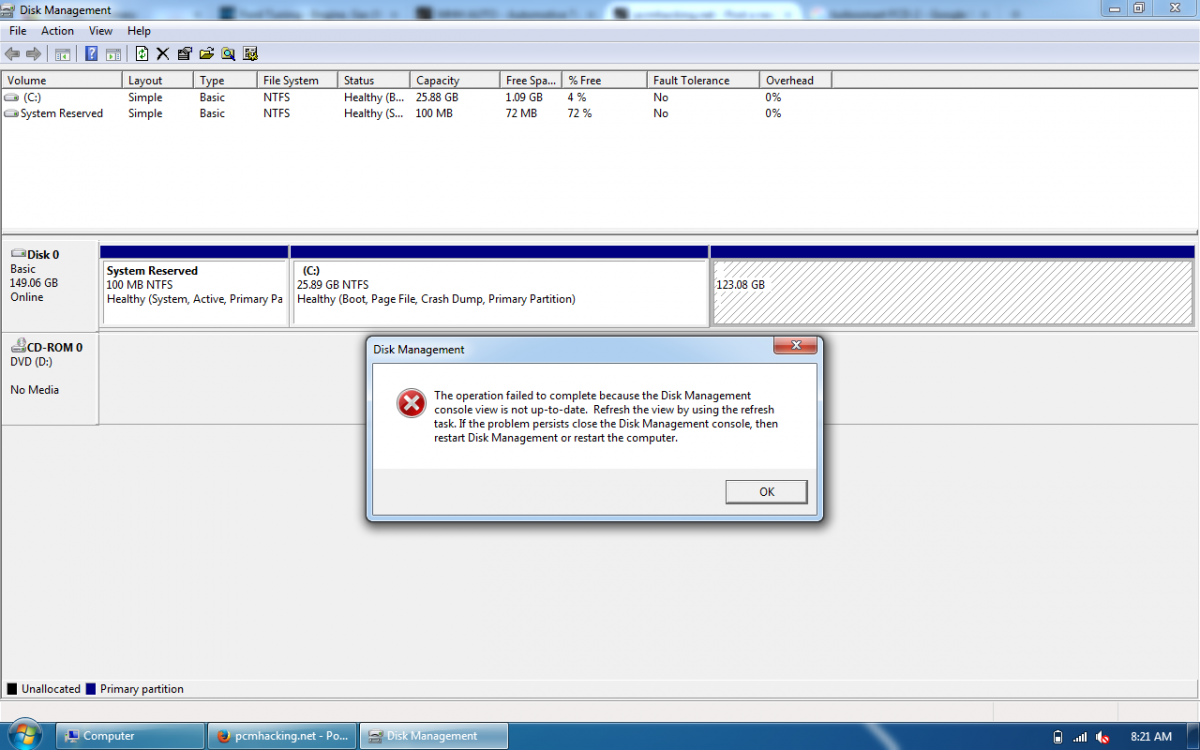

I had this issue a week ago where my laptop ran out of batterry & didn't have enough reserve in it to put it to sleep/hibernation so it had to do a complete restart when I plugged power in....
Normally fine but this time it lost my main partition that I store all the car tuning info(removed the partition drive letter for some reason) & when using diskmgmt it has this error to try & add drive letter...
Now I have tried independent partition softwares & they can't do it either, I have managed to use 1 of those to copy all info on another hdd so it's all safe but wondering if there's a reason why it happened & how I can get it to set drive letter again?
Win7 x64 lost hdd partition

did you try doing it via command line using diskpart? ive found that sometimes works for things that the gui doesnt like.

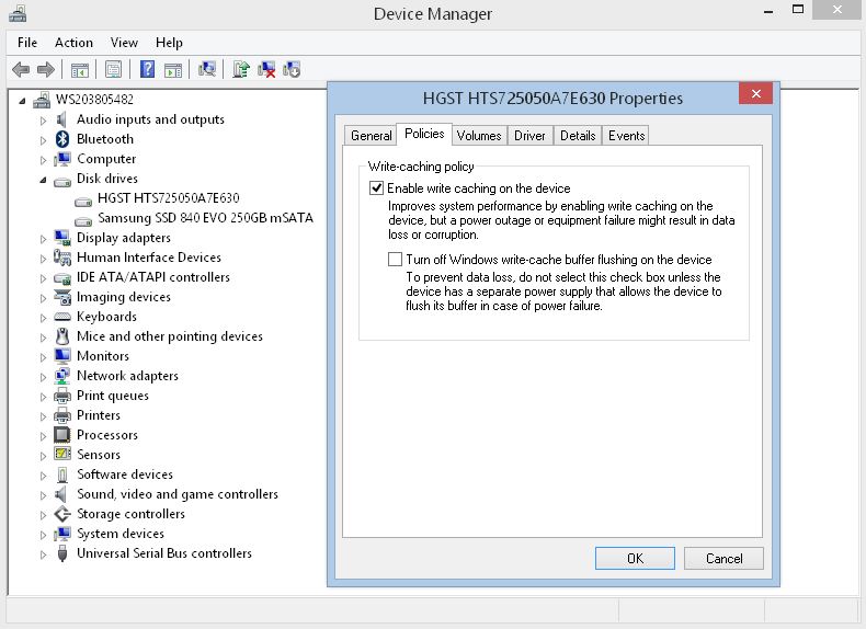

looks like a MBR setup, so may corrupt the table easier than say a GPT. Most third party software that can repair a MBR should repair it if it's not to badly corrupted. It can happen if MBR changes happen to be in a disk cache, which then powers off, or it was powered off while the disk cache was being written to disk, so the information on disk isn't complete, if you want a more reliable hard drive system find a way of turning off disk cache, yes it will be slower and perhaps upgrade your partition to GPT. This is what we do on servers, then we use battery backed cache modules on raid controllers and turn off disk caching, so if power goes out the disk cache is still held till next power on.

Thanks Jayme, yeah I did try command line but it doesn't even show it as list volume...
Thanks The1 it's all a little double dutch but will try & do that fix this afternoon. once I do a bit of googling!

something like this option on your hard drive in windows.
An aftermarket tool like Aoemi etc should be able to convert the disk to GPT.
Some information here, basicly it's similar to MBR but it also supports more partitions, larger volume sizes but most importantly does CRC Checking and keeps a copy of itself at the end of the disk as well.
https://www.partitionwizard.com/partiti ... s-gpt.html
- Posts: 2971
Re: Win7 x64 lost hdd partition
Ahh cool thanks yeah just checked device manager & it does have that box ticked... bugger it's now unticked & will be converting to GPT thanks so much.
