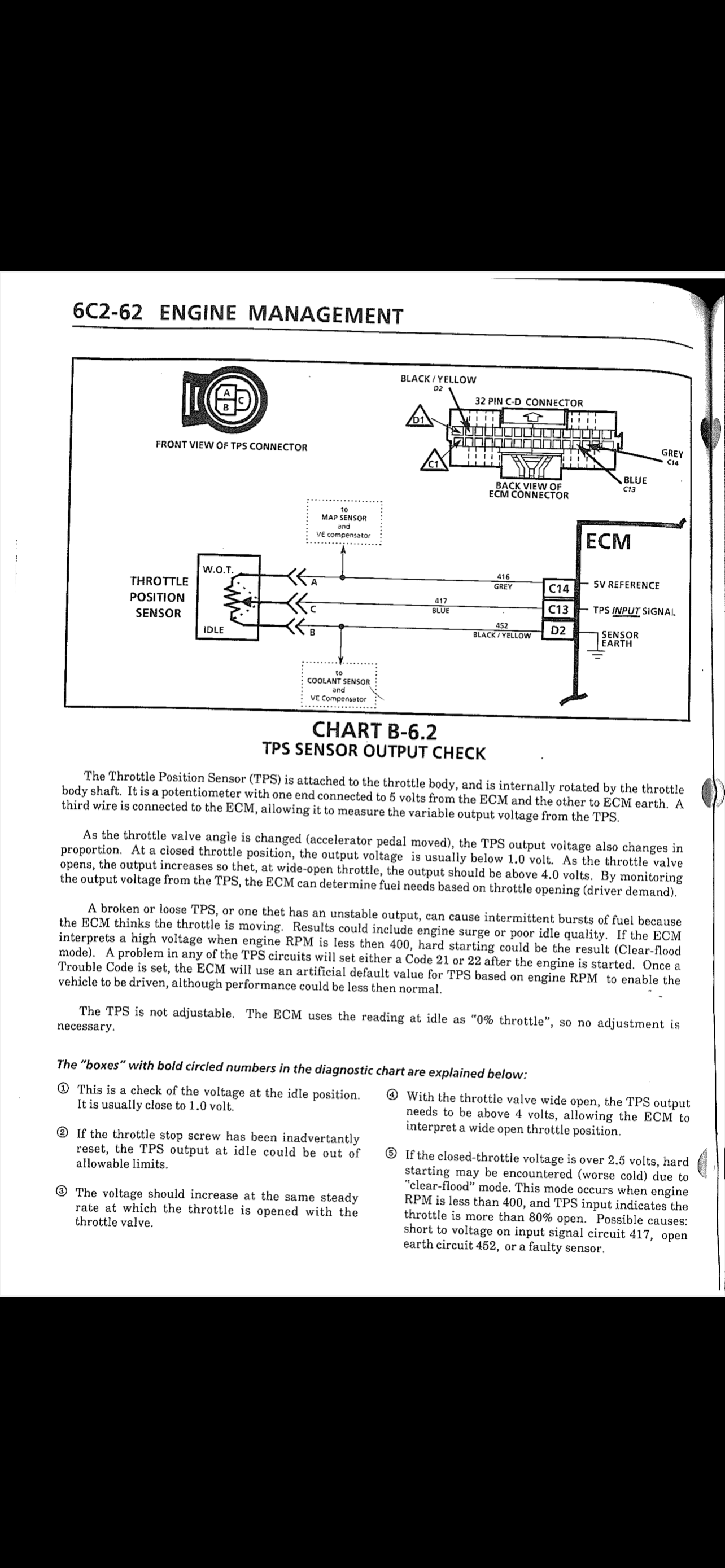

From the service manual. Adjusting the primary TB and making the TPS adjustable seem like a good option.

I would concentrate on getting the TPS voltage down first. It's not allowing the engine to go into iidle mode. As someone else said file the TPS sensor if you can or as I said before open the secondary throttle body slightly.
You will know if the secondary throttle body is opened too much because it will be idling too high. Good to here you have code 12. This threw me way off. Its possible the code 44 maybe caused buy a faulty ECM.
Many of the Delco 808 ECM are crook. Best to get yourself a VR or VS manual ECM.
