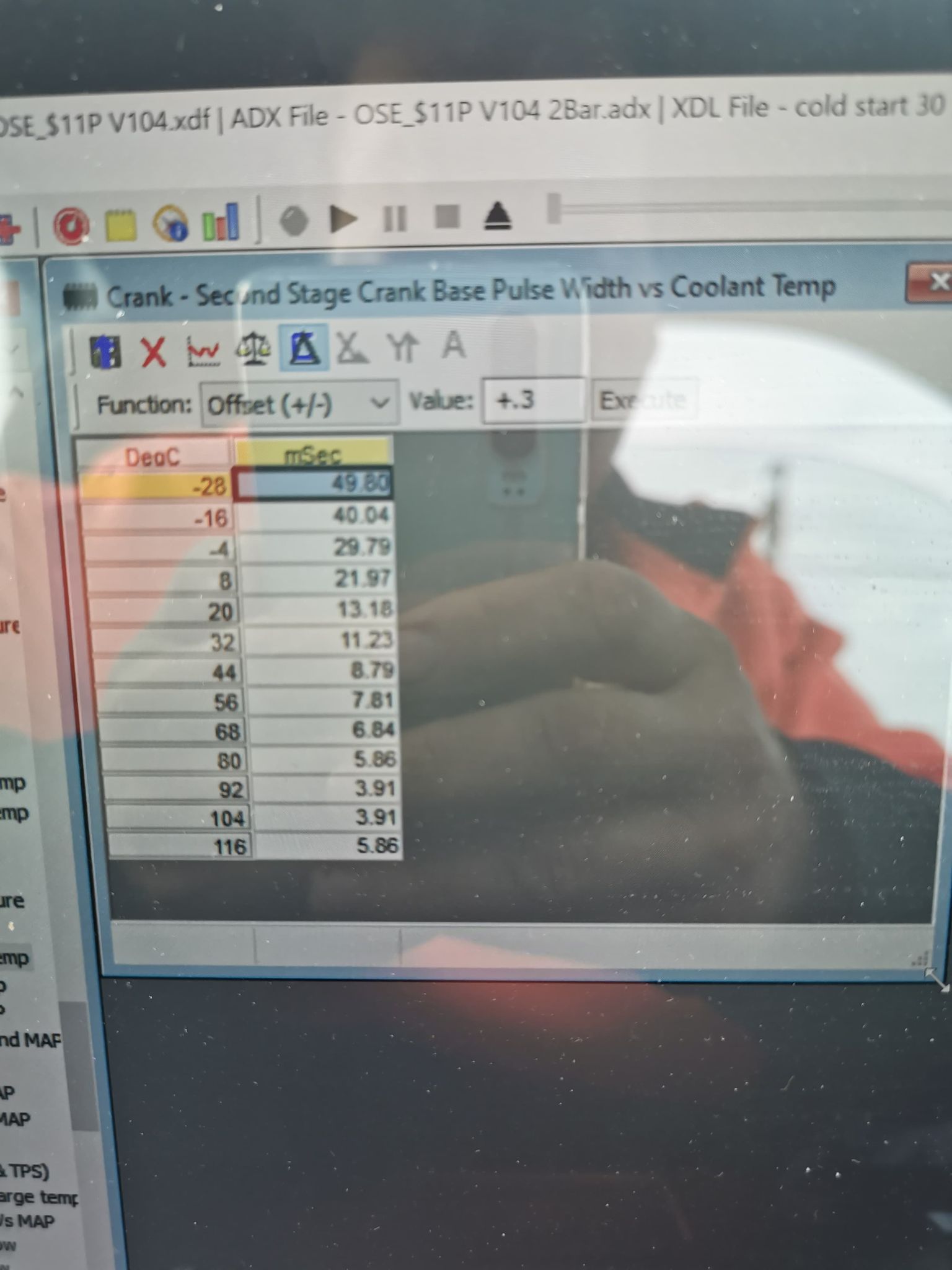

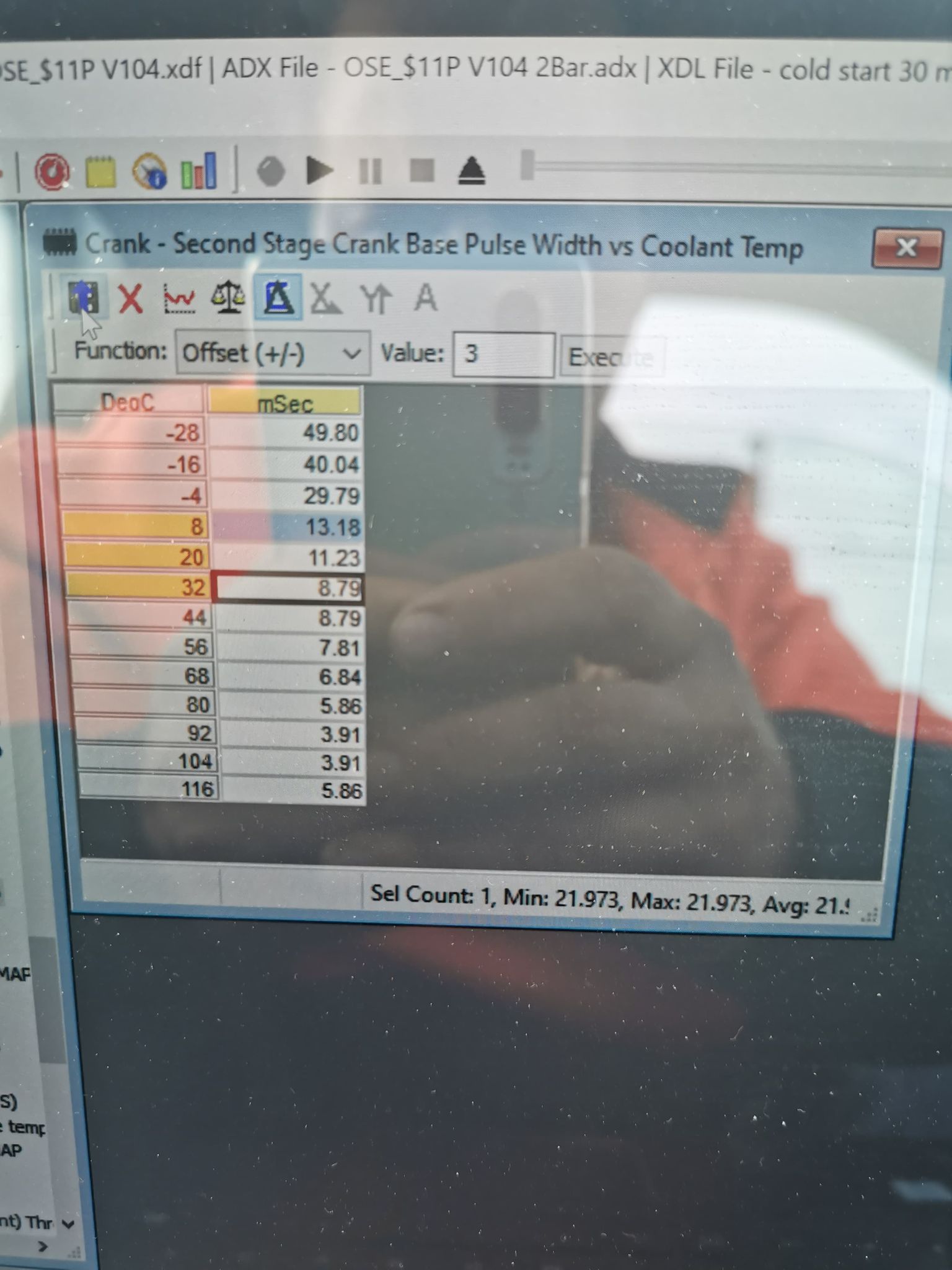

Ok so last night tried the .3 leaner of original settings for air fuel ratio when cold did not make nearly any difference still stalled
So this morning stone cold again i tried a little bit leaner again on the cold start areas
But i also leaned of the 2nd stage crank settings when cold moved all the numbers one row down to see what it would do.
Looks like the 2nd stage is working as when it started the idle was a bit fluffy rough sounded like not enough fuel for a good say 5 sec or so. When i put into drive was a little rough then stalled when i went to take off.
So far the original air fuel ratio table when cold seems to be the best
Injectors should be good as i had them cleaned 3000km ago when i put the motor in and have new walbro fuel pump genuine i fitted also around same time.

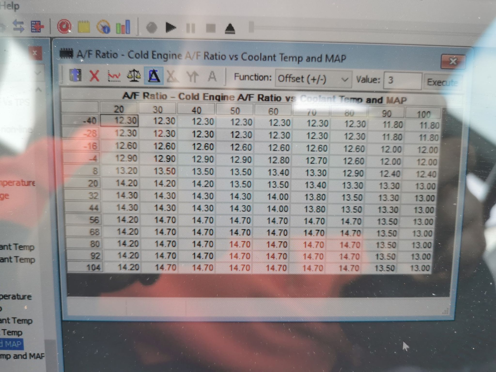

Are you sure those Cold Engine A/F R's have only been moved 0.3 from original.
If so, they should be richer, as the starting point is too lean. Try -0.2 to -0.3 in those 20 to 32 degree low map areas (from the original figures) that are showing in the 14's A/F.
To clarify, can you post the original table before you do anything else.
If nothing, then move on to the other suggestions mentioned.
Also, I have found you can move the Max Temp. for Cold Engine Table down to 32 degrees in the Run A/F Param.

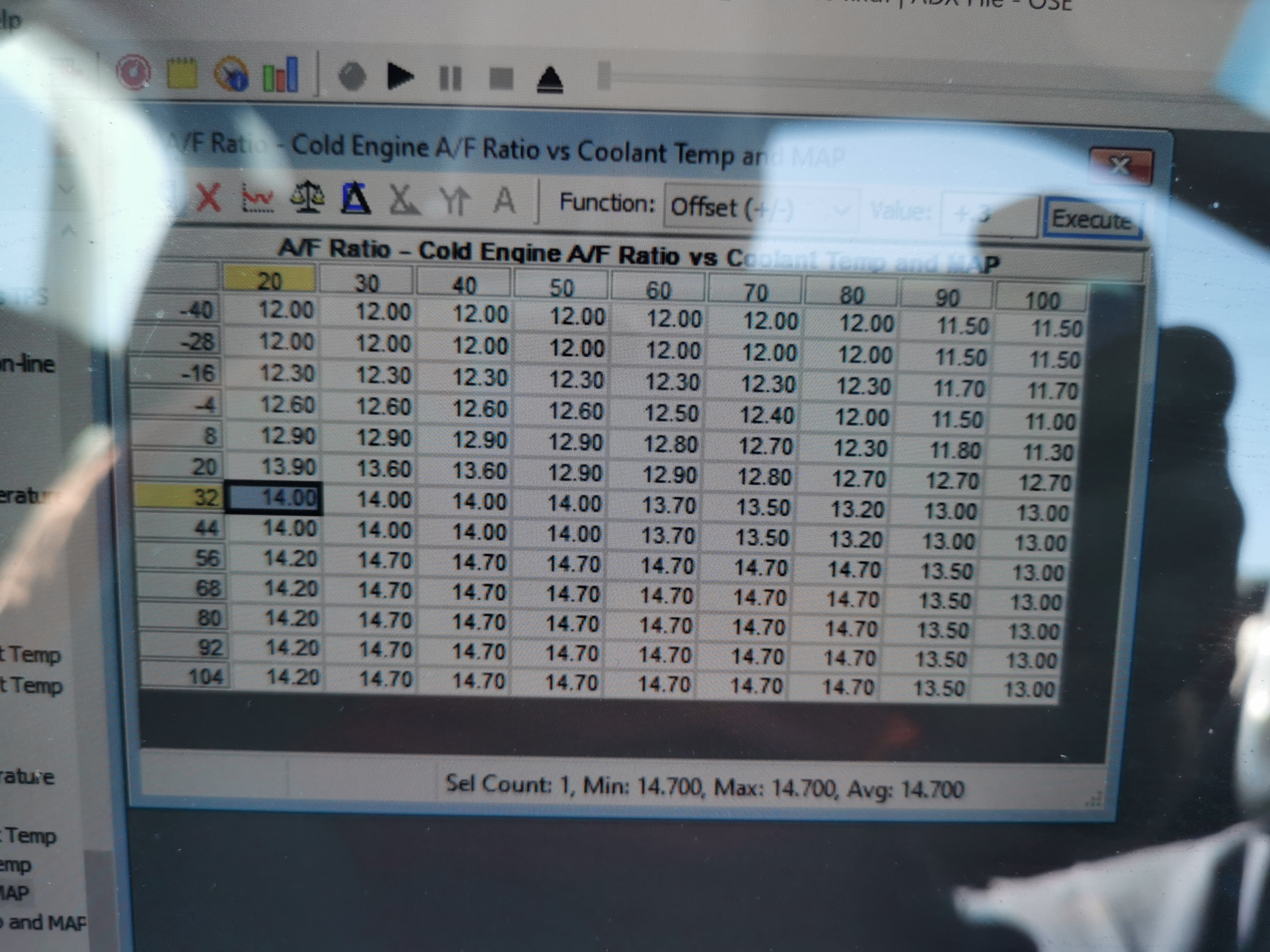

Here is my original starting air fuel table.
Looking now has changed a bit around the 8 20 32 deg c areas
I will load up now this table and alter those areas making it leaner by .3
Is that what your wanting me to try ?
Yes is a glitch at 20% tps and 32deg c i will blend that in

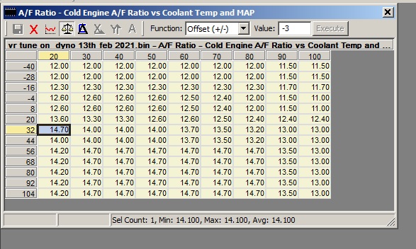

Re: Cold start car stalls when taking off help needed
Sorry was in a rush when I typed it
20 map not Tps.
Let the car sit for 4 hours and started it just then.
I leaned of this section see picture below.
started better tho still stalled when I tried to take of in drive.
20 map not Tps.
