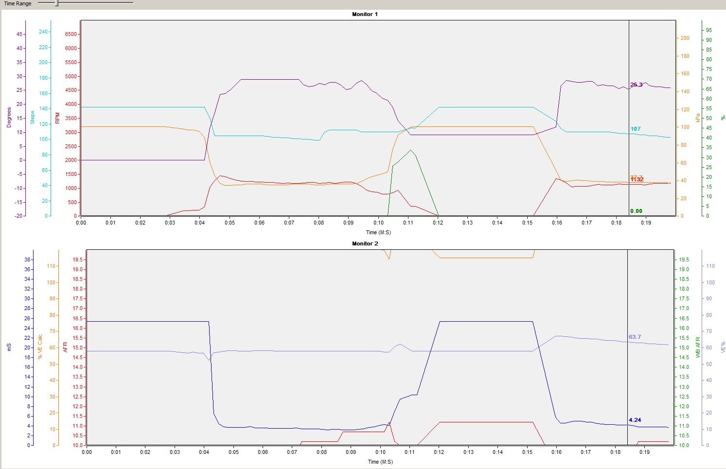

I notice in the log also the MS for fuel shoots up a fair bit at that stall point. When i restart the car 2nd time after stall and take off again it does not shoot up no were near as badly ?

Here is a log below, and screen shot
Start car from stone cold and around 10sec in i go to take of with around 25% tps and it stalls and i just restart and take off again driving slow like nothing happened.

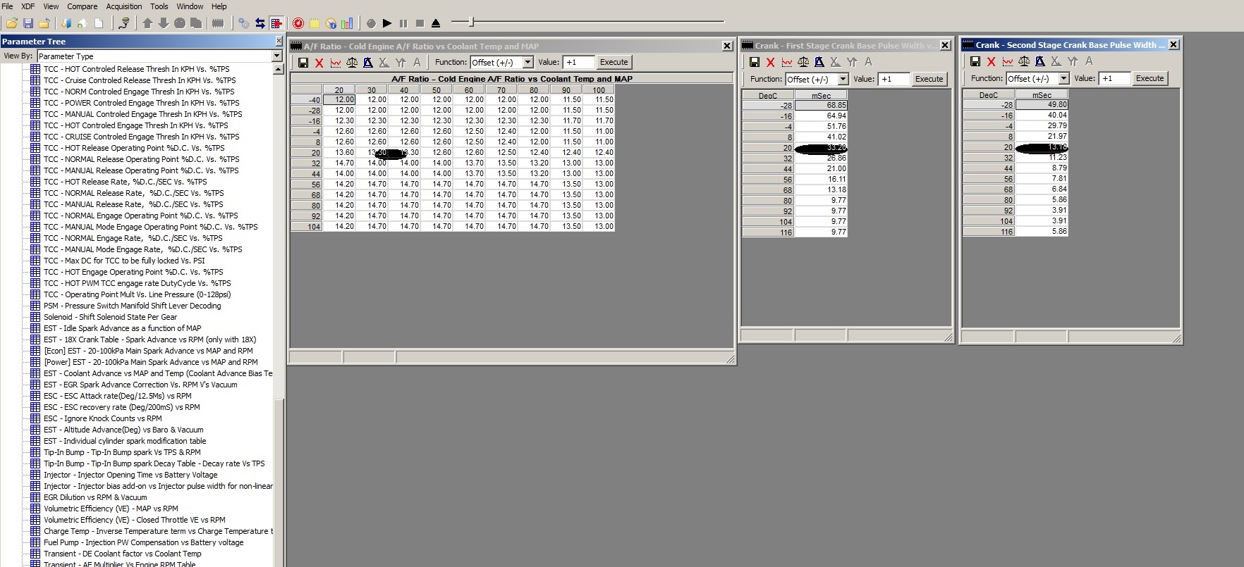

here is a screenshot of those maps around 6 sec into that log with data tracing on showing were its at.

By 6 seconds it's all over (the screenshot).
See the 8 degree vs 20 degree breakpoints at 30 KPA in your Cold AF/R vs Coolant Temp. table, there is quite a difference in AF/R.
You have to judge what the temps are and maybe work between those 2 areas, either adding, subtracting or blending.
