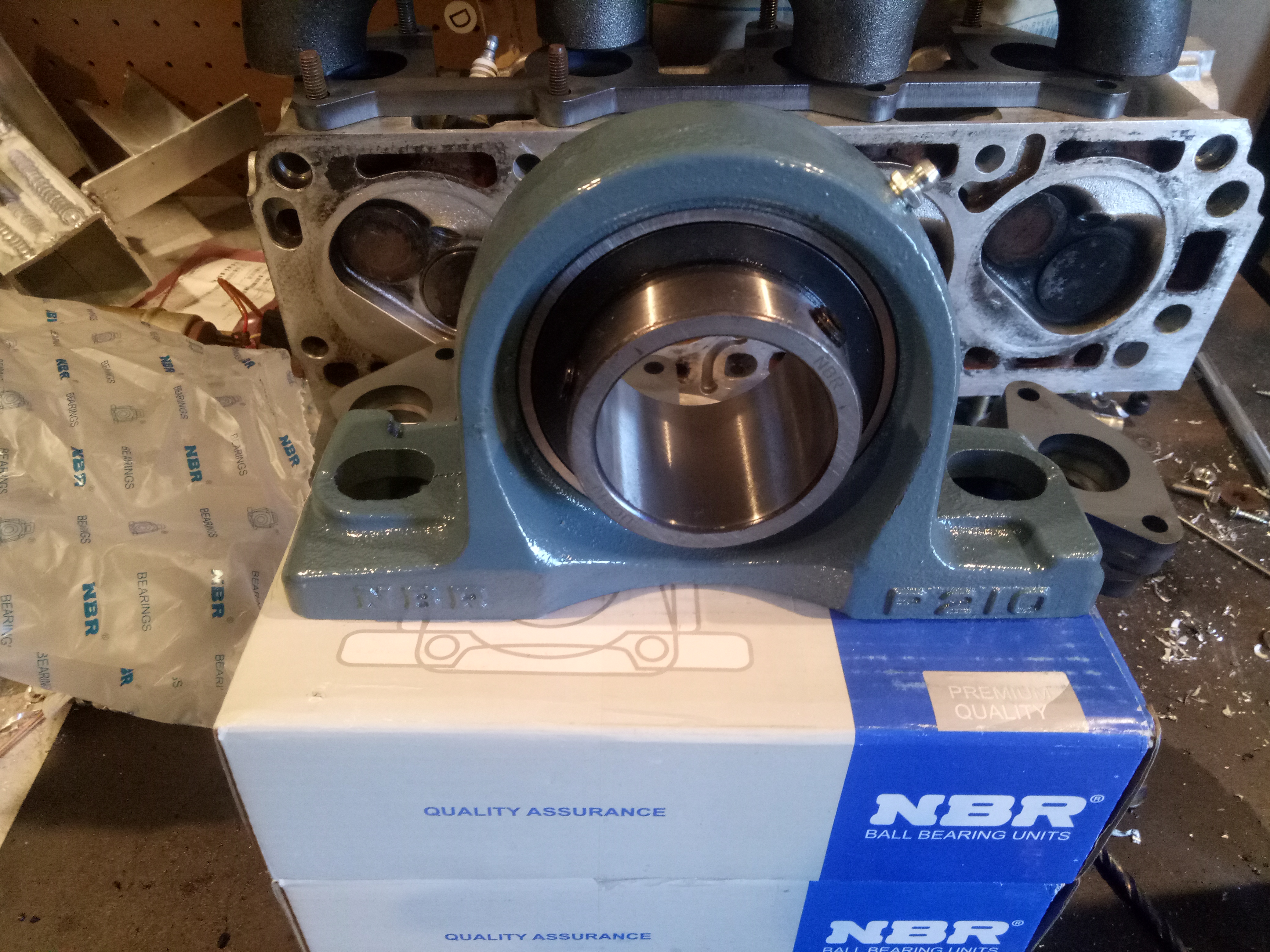

The pillow blocks arrived! They're almost as big as a cylinder head!

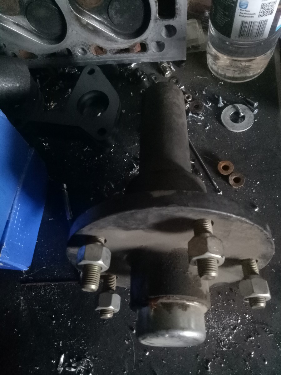

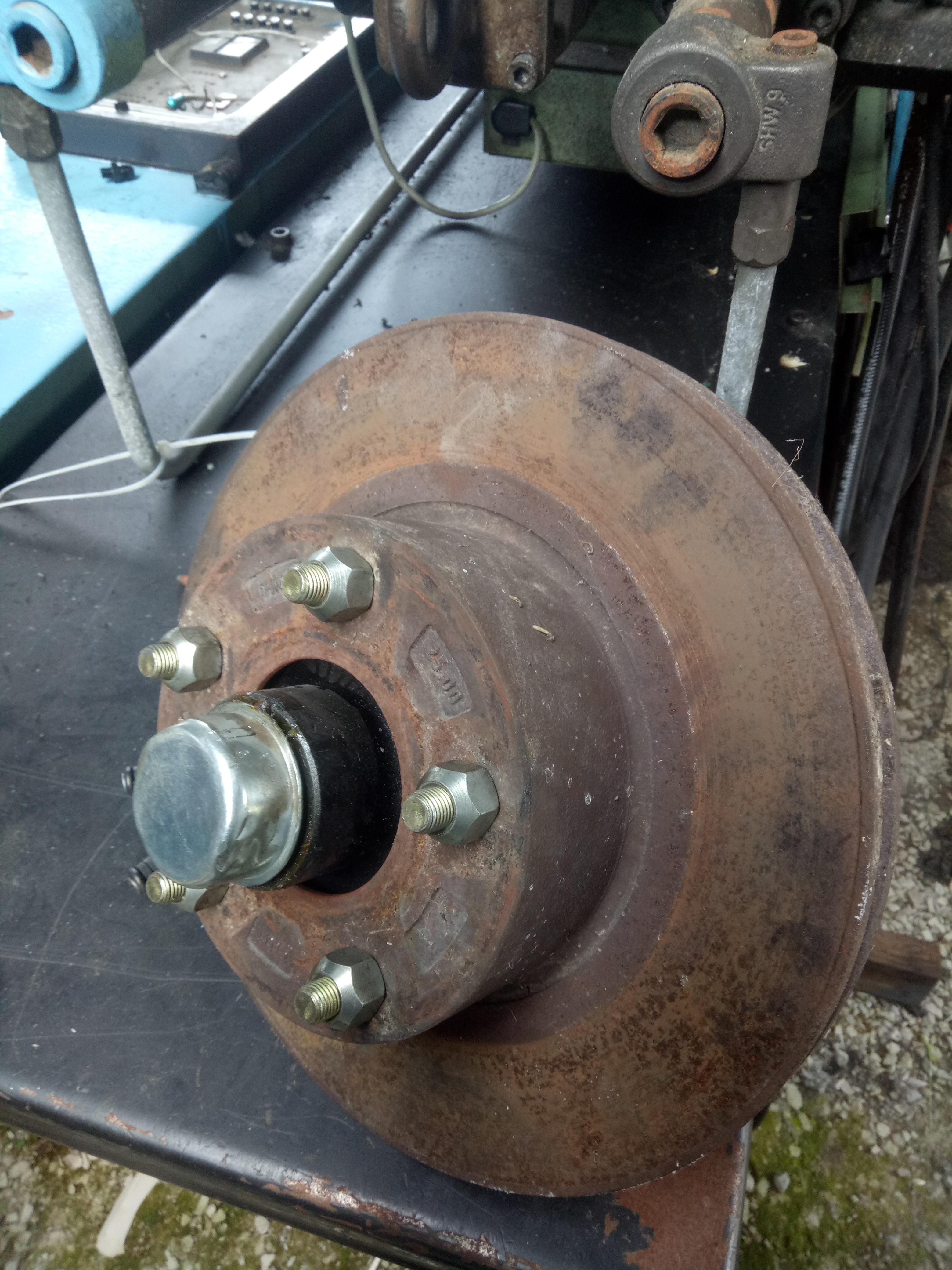

Stub axles, master cylinders, flexible brake lines, 100KG electronic actuator and load cells have arrived for the weekend.
I was hoping the 50mm stub axle was turned down to 50mm. Instead it's hot rolled and measures to 50.5mm including mill scale. It'll be fun to try chuck up and turn down to size.
The hub face is machined at least so that will be easier to turn down around 8mm so it'll fit inside the rotor.
100% wouldn't go down this path again. Next iteration will be series 2/3 AU falcon hubs, rotors, calipers and a custom stub. These Chinese trailer hubs feel cheap, the bearings will probably soak up 10hp alone. I don't trust the studs either.

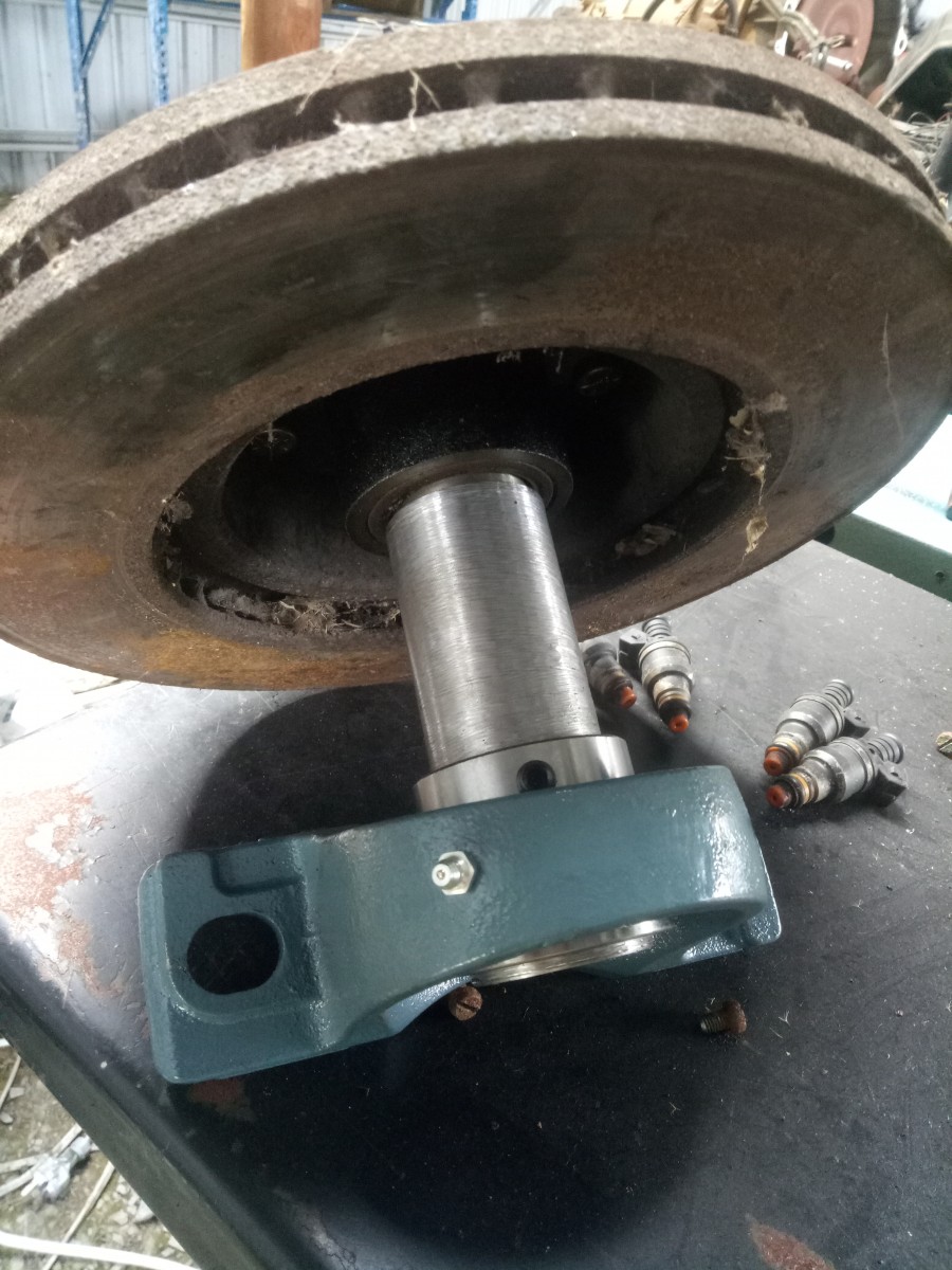

Flange and shaft turned down. On to the frame!
