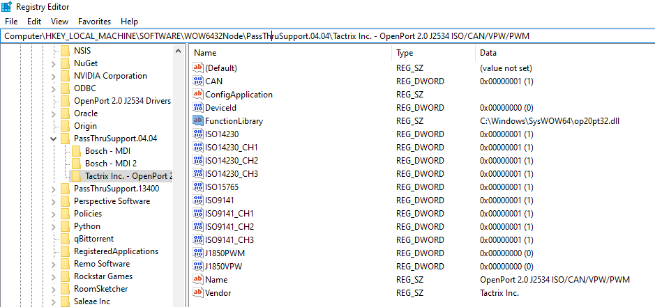

It should be in the same location shown in the bar at the top of the screenshot. Each device has an entry under there, and it shows the dll path. Here is a screen shot showing the J2534 tactrix location, and you can see on the left the MDI drivers have created a couple of entries too.
If you are running a 32 bit OS then omit the WOW6432Node in the address.

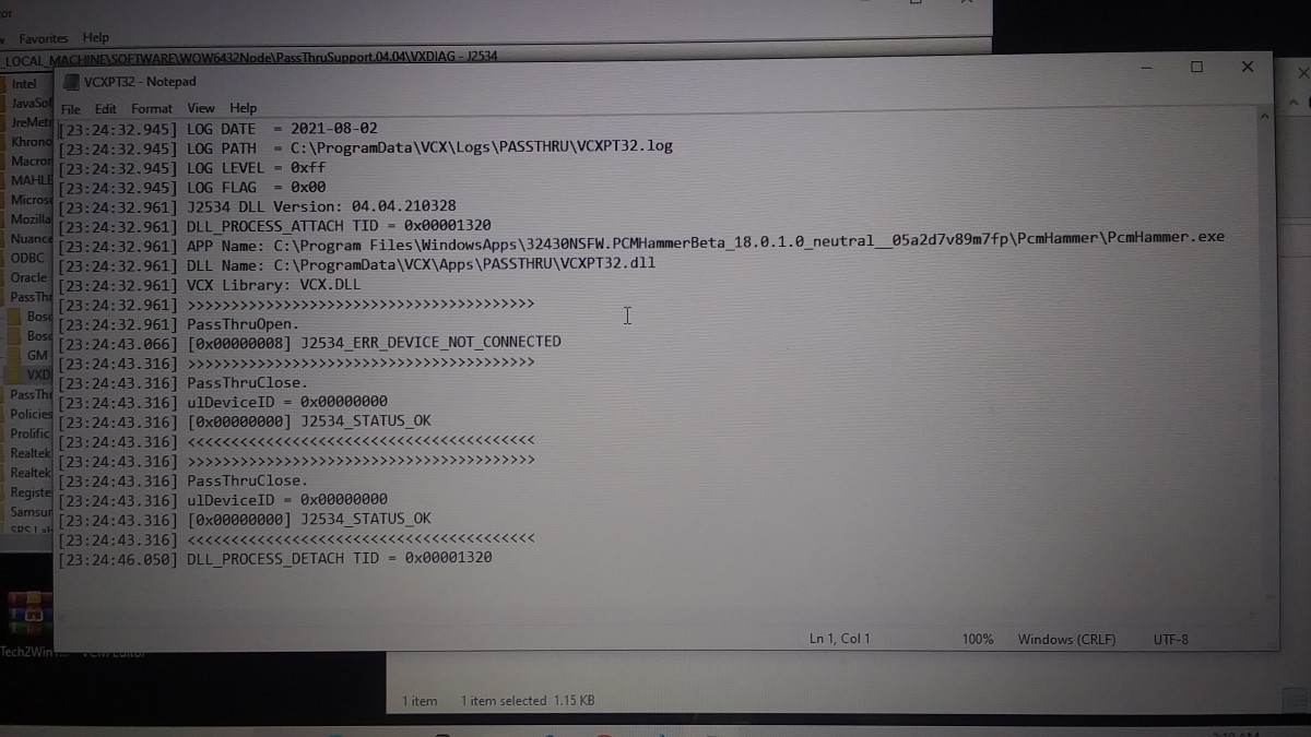

Re: Vcx nano error 126 using PCM hammer
Also found a log named vcxpt32 in pass thru if it's any help
