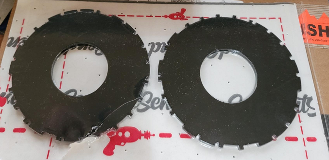

I've found a place that'll laser cut parts. So I sent them this drawing (the PDF) to see how good they do. I ordered 4 of them and it was under $100. That included zinc plating.
I'm pleased to report the parts are very nice. They came in a blister pack and well protected.
Now I need to know. Can use this reluctor with the 0411 as long as I use the correct CPS.
I'm hoping to be able get back to this little project next week. I'll post results when I can.

DavidBraley
Posts: 174
cars: 1948 GMC
Re: 0411 running a 2.5L Jeep engine
Post by DavidBraley »
Very nice! How thick is that wheel?
-David

Post by Thorwon »
DavidBraley wrote:Very nice! How thick is that wheel?
It's 0.188 mild steel.
This is the company that made them.
https://sendcutsend.com/
Bad things happen FAST!!!
