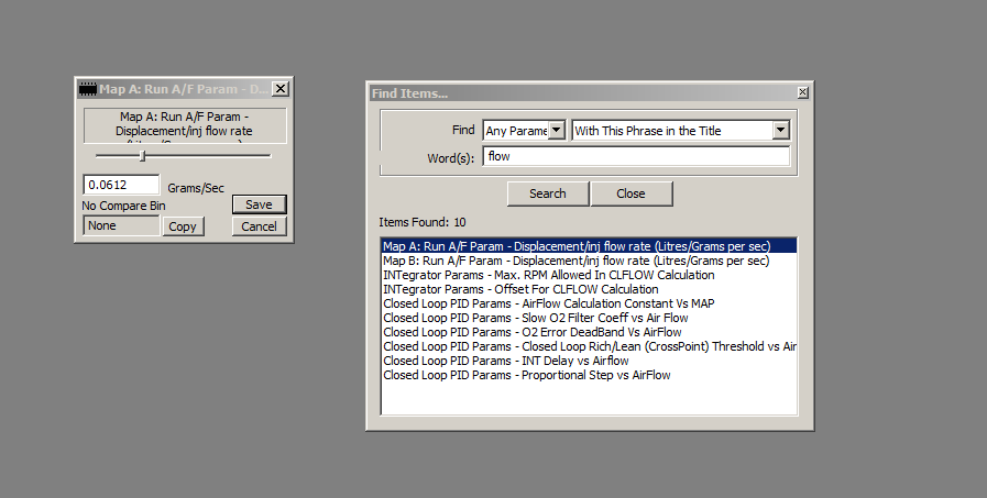

Re: Initial tune woes with new manifold and TB on my 355
“ increase your injector rate in the tune by a %”
You mean in the Kinjflow?
- Posts: 7829
This setting. That's my value for the 440cc injectors but mind you this a hot V6 race engine and the engine doesn't exist yet but I converted the tune from a factory based one to 12P for this combo but with 440cc injectors instead of the the unknown falcon? ones used in the late 80s. When the engine gets built and tuned on an engine dyno this value will likely change just like I suggested.
I have 0.064 in there for mine. Just to test I changed it to your value and it obviously didn’t make a difference.
It’s like I’m missing some multiplier somewhere?
