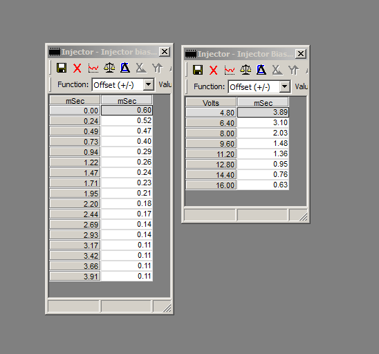

No i didnt, is that this data? if so, where does that go, in the "Injector bias add-on" https://www.tiperformance.com.au/wp-con ... 511446.jpg

550 sounds genuine. They come in Bosch long little boxes with QR codes on them. Not sure if that data is usable or not but I have the tables that The1 did for me for the 808.
Next time I am at my desktop PC I will take a screen shot of the data and post it here.

These are the tables you want to copy and fill into yours for the 440cc injectors.

vlad01 wrote:These are the tables you want to copy and fill into yours for the 440cc injectors.
oh thats awesome, thanks mate.
