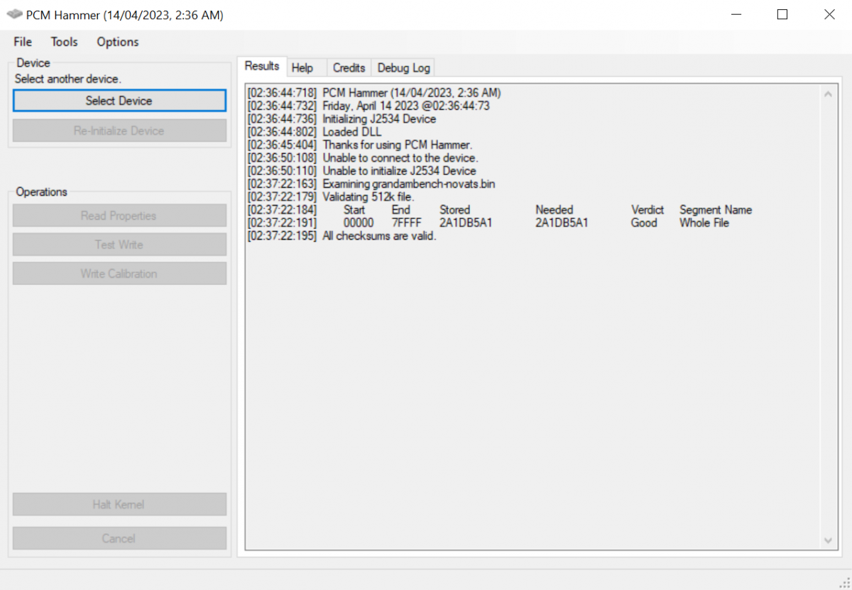

If your bin thats not flagged as SE is the GT one, and its all right except you need security disabled, Ive done that for you. To do this I loaded the bin in to TC (like you saw), saved it to cal, updated the vats flag from "1=no light" to "2=disabled", then saved it to a cal again. Then I compared the cals and found the checksum change and the vats change. Then I searched for those patters in the original bin and made the same changes by hand. It validated OK with pcmhammer. So with lsdroid you should be able to write this file to the GT PCM and if vats is the only problem left it should start. The reason a 1 byte change ends up in the 3rd octet of the sum is because of its alignment. its a 16 bit sum, stored to 32 bit address and it just happens to be aligned with the high byte.
OSID: 12589762
Vats: 7D570: 0=On 1=No Light 2=Off (change 1 to 2)
Sum: 710C8: 4 bytes, add 1 @ 710CA (change B4 to B5)
grandambench-novats.bin
(512 KiB) Downloaded 150 times
