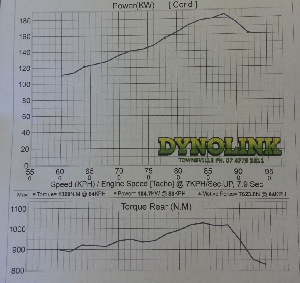

Sorry guys, havn't had time to do any more programming of late, i really want to get back into it some time and get the goods out. Only thing i can report atm is a dyno graph of a vs auto ute i tuned a while ago with a 10psi raptor attached. Using the VS Enhanced N/A

is it just me or does that dyno graph only show a few points, like its not a smooth line cause of not enough samples through the rev range ?
either way good power for 10psi.

yeh i got the same feeling, at the end of the day i was surprised this Raptor 10psi made 20kw more than L67 10psi, obviously loss's at the belt and internal temps with Eaton.

looks like a 2nd gear pull
