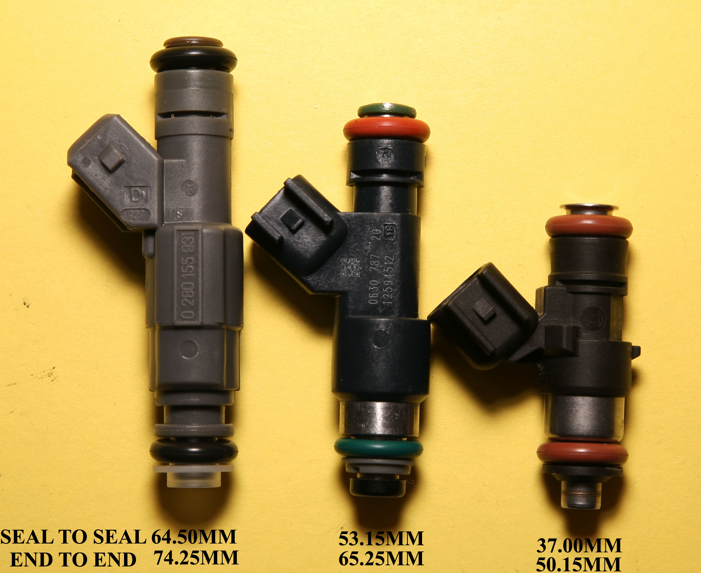

Any you recommend that are around that 60lb, shorter than stock by about 10mm?
Just toying with the idea of retracting the injector bosses in the VN-VR v6 manifold to allow opening up the runners right up in that area.

those grey 12hole 80LB on the previous page are 14mm shorter. I have more of those in the post now just waiting to arrive.

Whats that other GM fomoco looking one next to the L67 injector? that looks shorter. 14mm shorter is probable too much. 10mm max or ideally around 7-8mm for what Im looking to do. Its so I can machine away the boss completely inside the runner.
- Posts: 4853
Re: Injector Flow Testing Data
im only aware of 3 standard sizes, Standard Length, 14mm shorter and then the tiny ones like LSX use. Im sure 4mm is neither here or there it should have room in the rail housing or can make enough room for that? The black Fomoco denso ones are same 14mm shorter as the grey denso ones.

Why not just fit some spacers under the fuel rail mounting bolts to get your 7-8mm?vlad01 wrote:Whats that other GM fomoco looking one next to the L67 injector? that looks shorter. 14mm shorter is probable too much. 10mm max or ideally around 7-8mm for what Im looking to do. Its so I can machine away the boss completely inside the runner.

yeah I could just modify the rails. To suit.

here's the 3 sizes compared. End to End and between the Middle of the top and bottom Seal.
