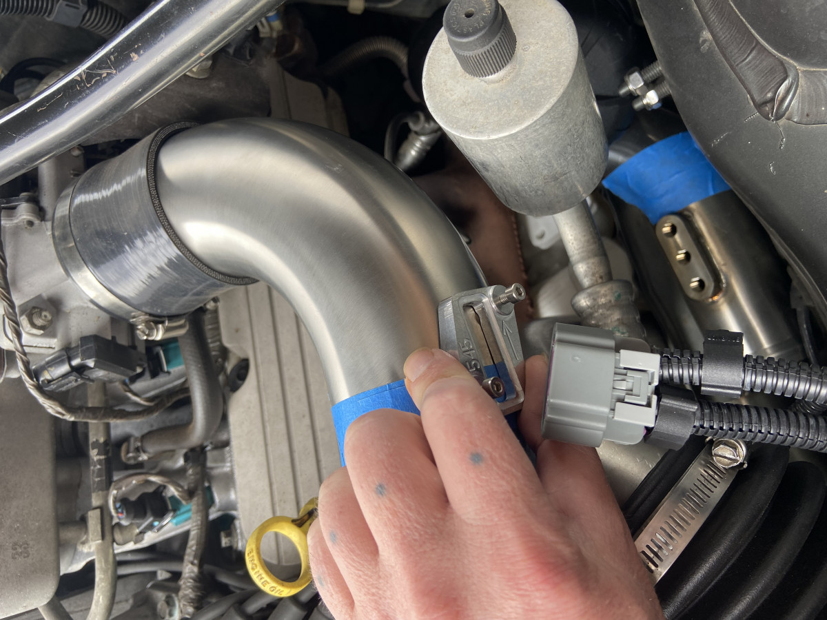

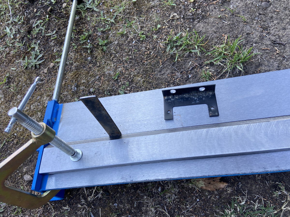

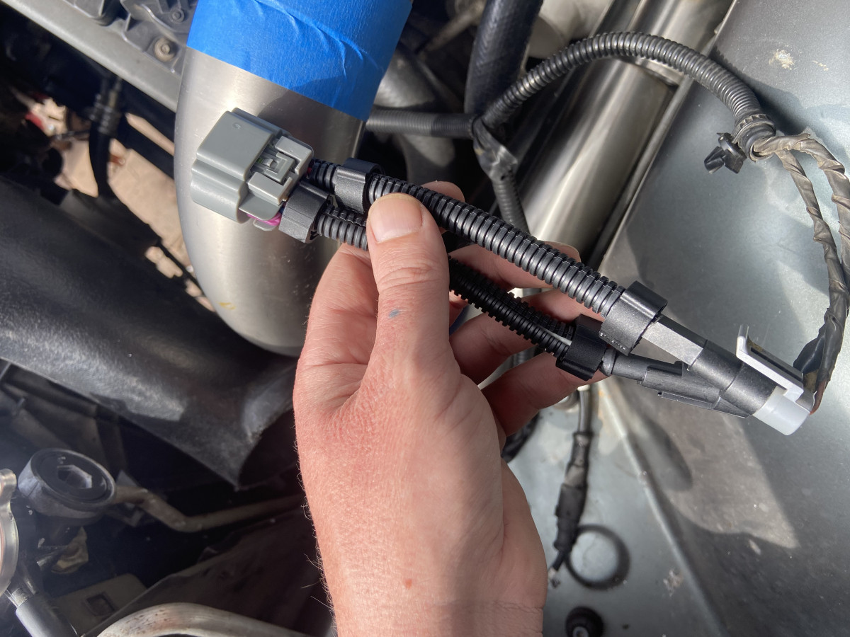

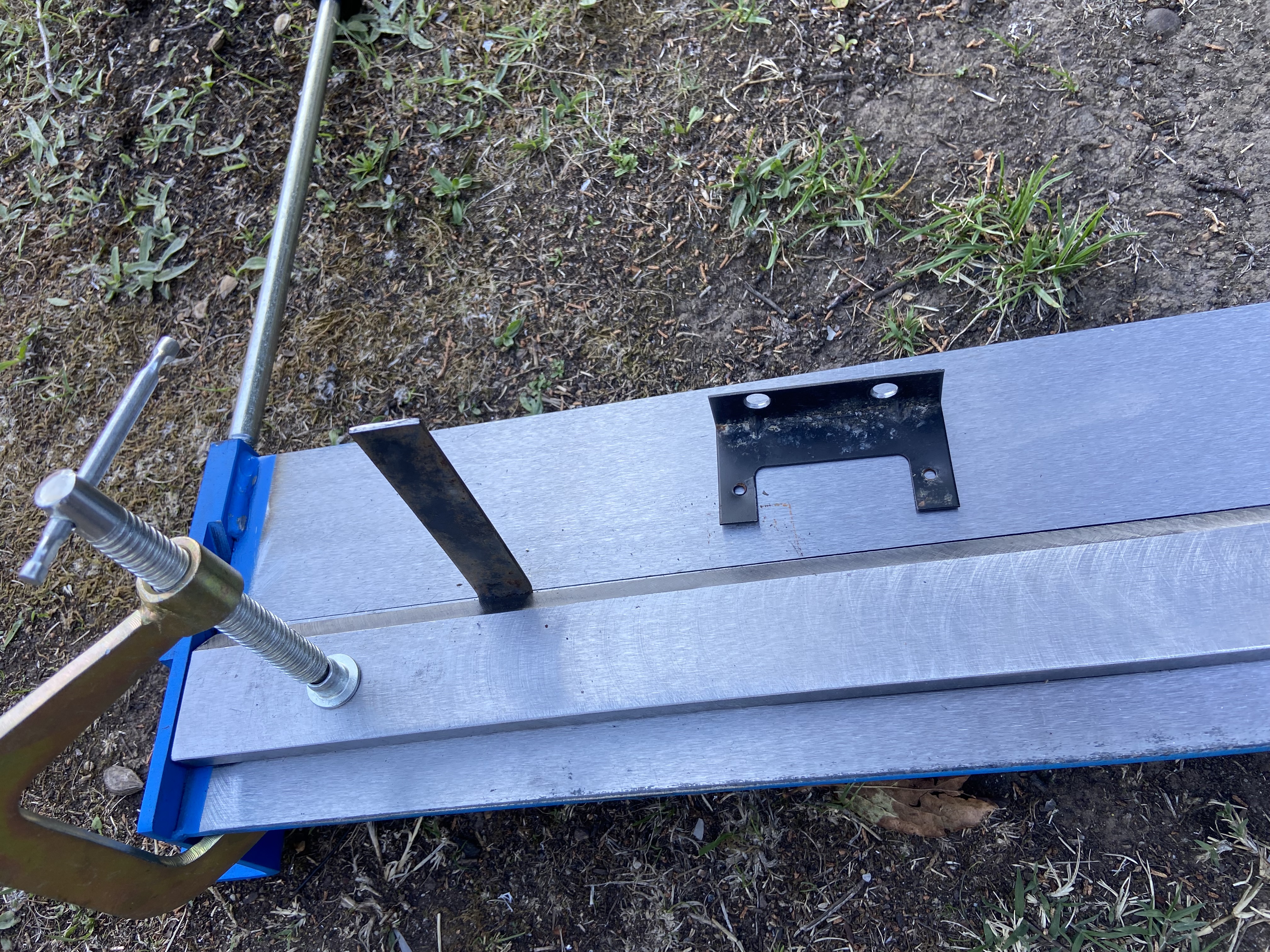

Started making up some brackets for the map sensor and catch can.

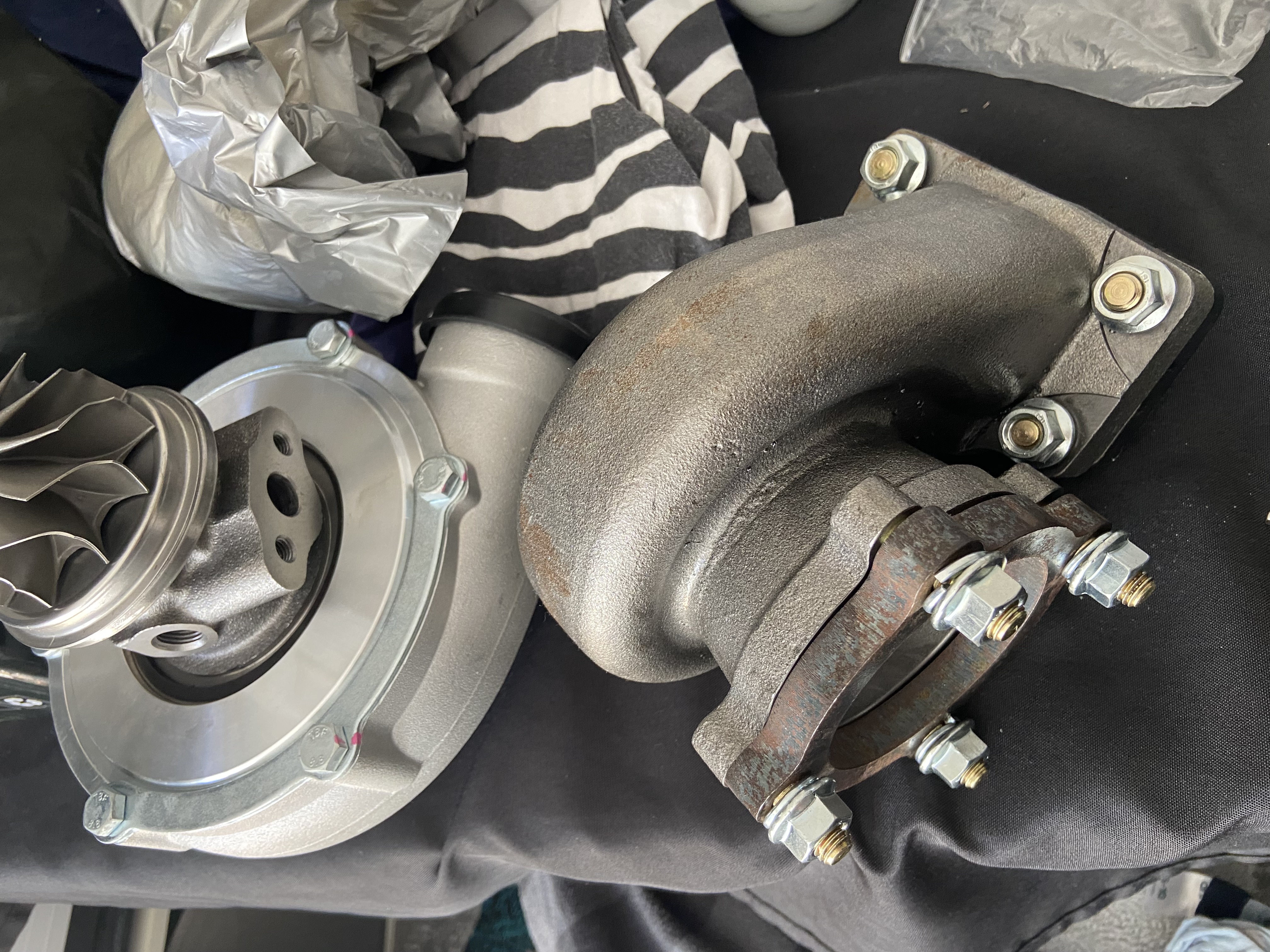

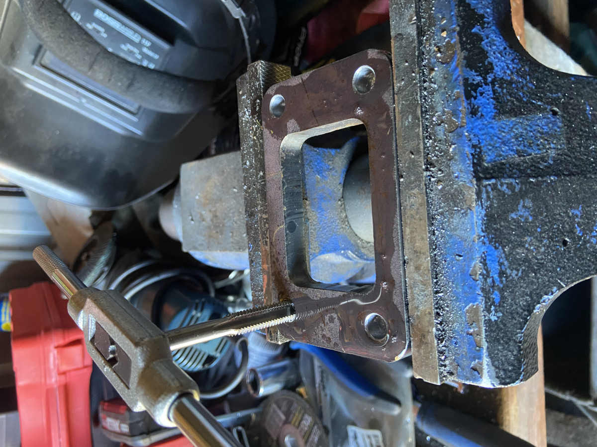

Re: Vy commodore
Taping some holes. Ended up buying a t3 flange un-taped as it was half the price. Then noticed the outlet stud diameter was different on the turbo’s exhaust housing, so fixed that up while I was at it.

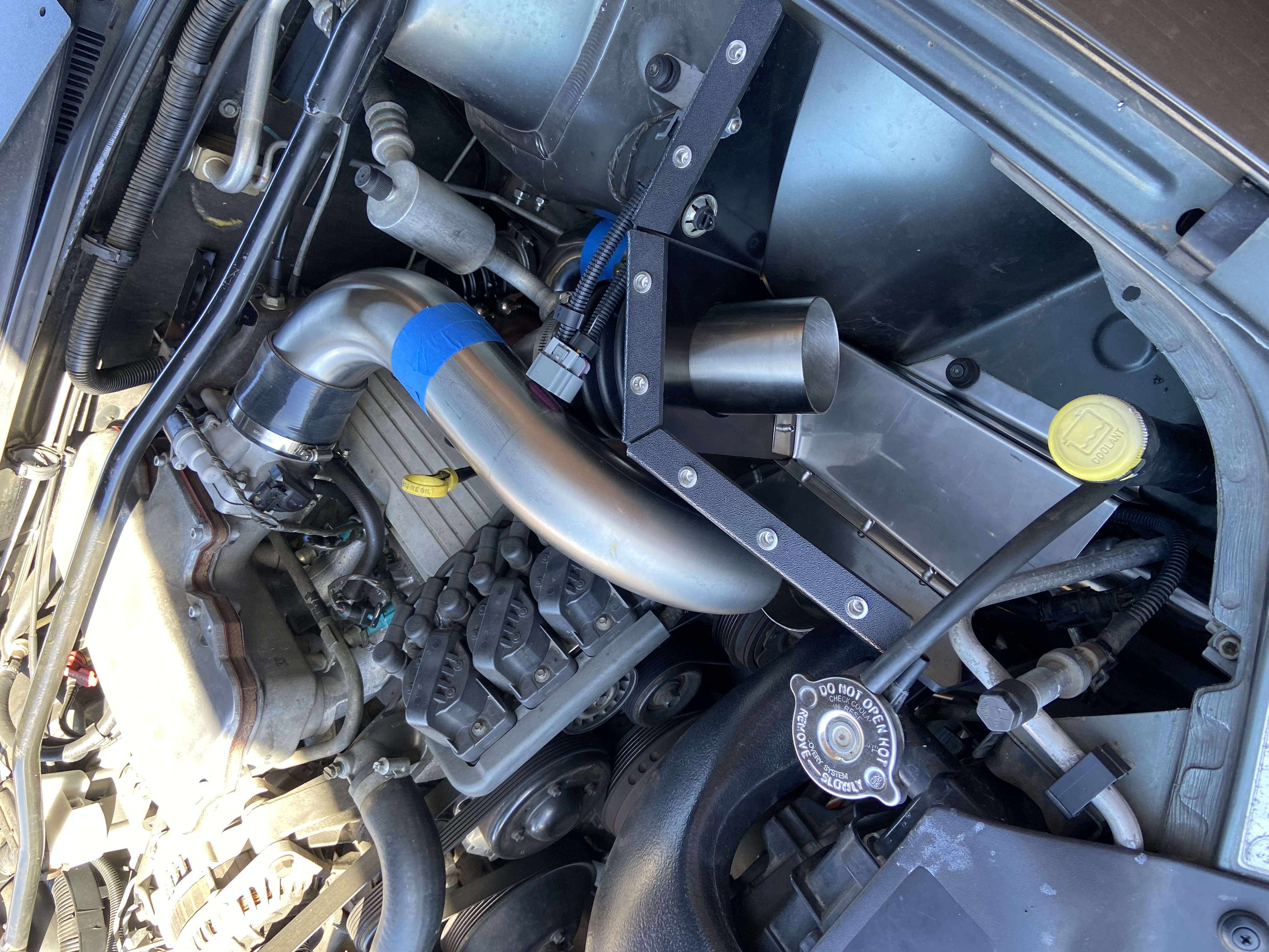

Need to figure out if I’m going to use acrylic sheeting or maybe some stainless to modify the mace cai, as the intercooler pipes now runs through there.

Re: Vy commodore
Ended up modifying the mace cai with some stainless. Turned out ok. Still plenty of room and clearance for the air filter.

Re: Vy commodore
Not considered a reverse plenum putting the TB on the other side of the engine?Wade wrote: Fri Apr 25, 2025 1:42 am Ended up modifying the mace cai with some stainless. Turned out ok. Still plenty of room and clearance for the air filter.

Re: Vy commodore
I did consider it. But I don’t think it’ll be needed. I’m trying to keep as many oem parts as I can. Then I’ll run sensors everywhere and makes changes to the setup based on the data they returnimmortality wrote: Fri Apr 25, 2025 2:35 amNot considered a reverse plenum putting the TB on the other side of the engine?Wade wrote: Fri Apr 25, 2025 1:42 am Ended up modifying the mace cai with some stainless. Turned out ok. Still plenty of room and clearance for the air filter.

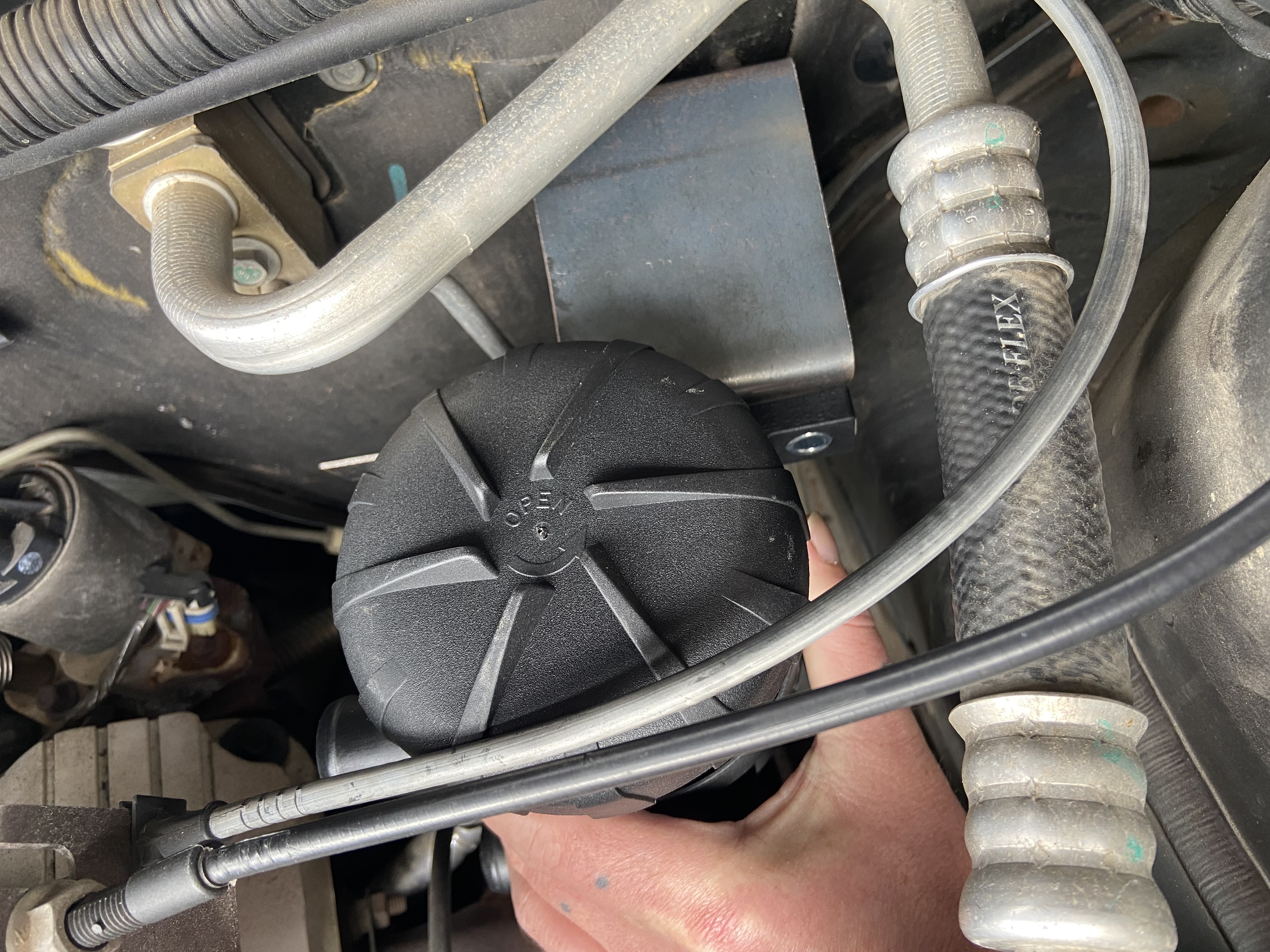

Re: Vy commodore
I’ll need to re think the catch can bracket. I bent it up before the catch can arrived. But definitely needs to be tucked in a bit better than that.
