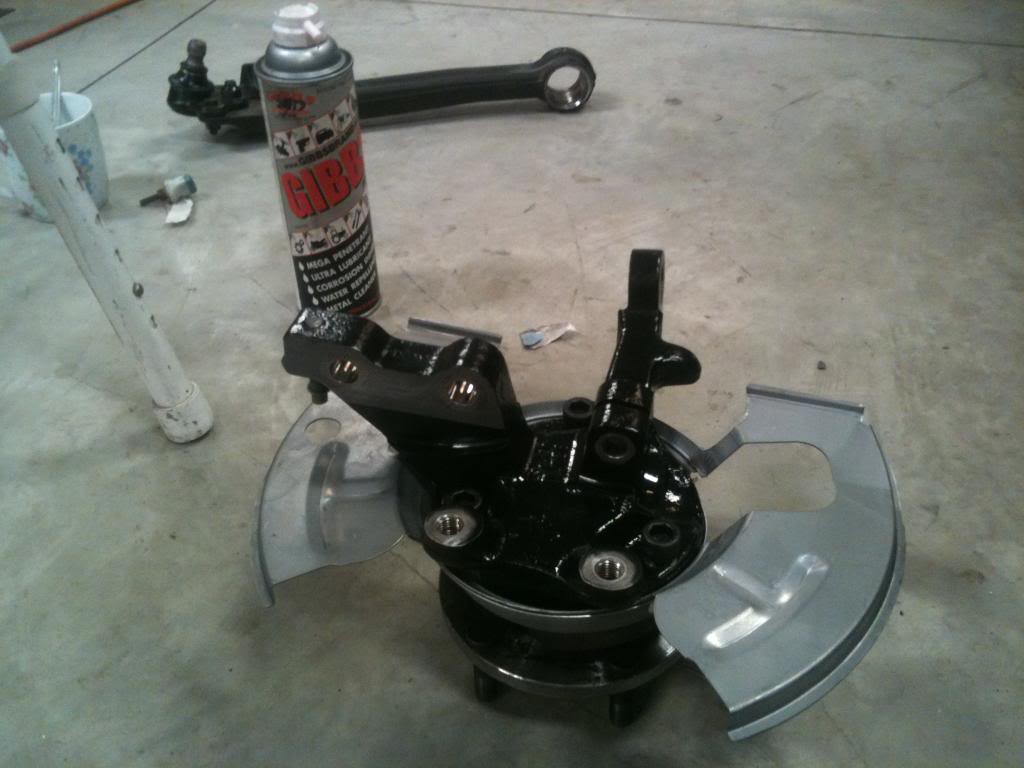

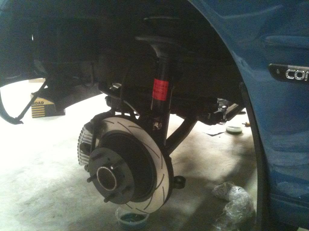

bit of a test fit. been fighting the aftermarket ball joints
trying to find some NOS ones. found RHS ones in Germany. None in Oz yet.
- Posts: 8549
finally got my NOS backing plates for $20 each. way easier than cleaning the old ones.
Hubs cleaned real well, loctite flange sealer compound on the hub matting surface, loctite the screws and torqued to 130Nm
