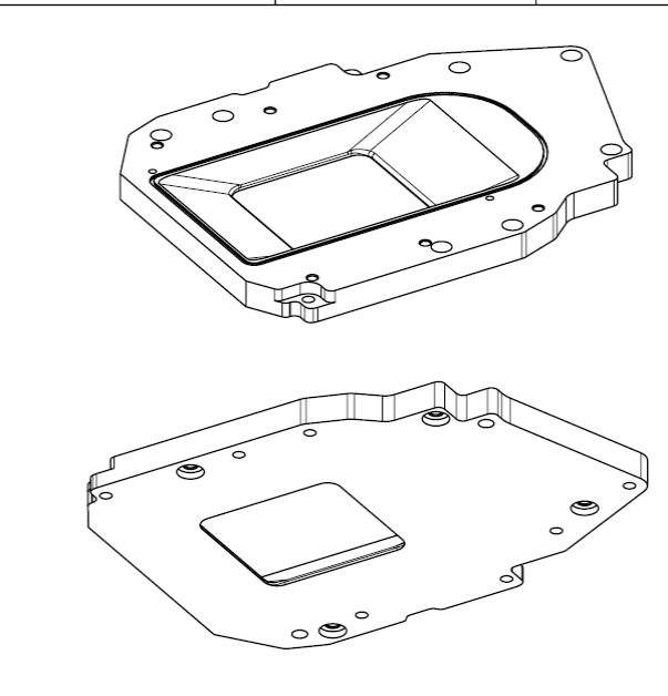

Here is the plate from Harrop
- image001.png (57.72 KiB) Viewed 3402 times
A couple of guys Stateside have bought the kits from Harrop with that adapter plate. I suppose you have to start with something, but one guy reported back the plate was a headache with the aftermarket fuel rails needed. Lots of notch out to make things fit.
- Posts: 8124
Yes thats what they told me as well, but most had no issues.
You would need custom/aftermarket rails in any non stock SC anyway. No one would bother with junk stock rails anyway.
A nice thing with the plate is you can actually adapt L36 rails into a custom setup with some milling and laser cut brackets and mount direct to the sides of the plate.
I want to do a custom plate with built in PCV and also direct mount LSx map sensor and all other consierations taken. I have prototyping abilities at my disposal and it costs me nothing to mock up 2D milled parts.
