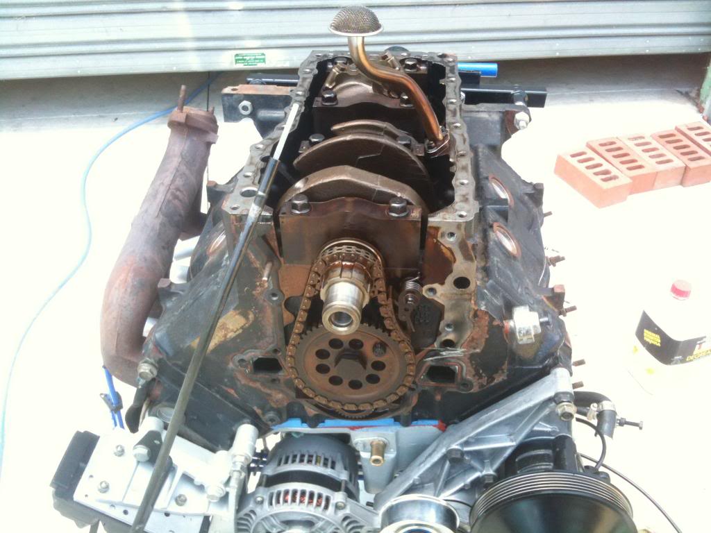

so this is what the engine will vibrate like without a balance shaft? I spun the shaft alone to induce the vibration it normally counters. Doesn't seem that bad really. when I hold onto it its just a gentle vibration at lower rpm and not much noticeable at higher rpm.
I am going to leave it out, I found the raspy noise is at the rear needle bearings when turing by hand. There is nothing wrong with the bearing or sleeve on the shaft from what I can see, just makes a annoying sound when it turns.
anyway some pics of the engine on my new stand I got today.

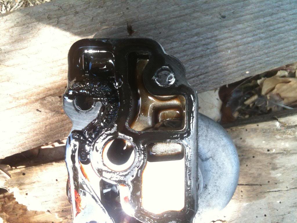

test fitting my rollmaster set sludge trap in the oil filter adapter and in the front cover
yeah from what I've heard the balance shaft being removed only really makes a vibration at low revs, and apparently if you can increase the idle slightly it goes away.

I ran the drill way down to what I judged as idle speed, probably lower. The balance shaft spins -1:1 with the crank.
you could see the dip stick vibrating, but holding the block with your hand its minimal at its worst. Mind you the engine stand allows the engine to bounce around very easy, so in a car with stock hydraulic mounts, I doubt you even notice it.
