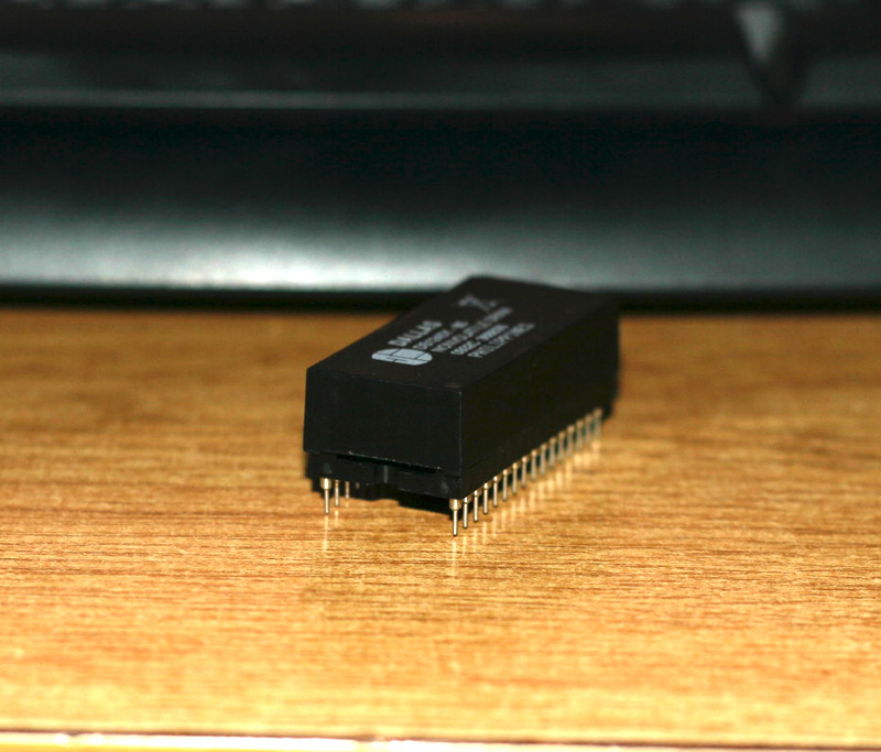

Was wondering about the space available on the V8. I'm a long way off playing with the more technical stuff anyway, so if you do work it in, it will probably fit in nicely with my time line.
I should get a NVRAM for my bunky VS V6 and experiment with that.

few people have mentioned to me about using nvrams and if i break alot of pins during testing, i socket the nvram so the pins can't get bent :)
Posts: 5631
Re: Enhanced Factory Bins
i do the same LOL
Posts: 4811
yeh best way and if you bend/snap a pin just replace the socket
