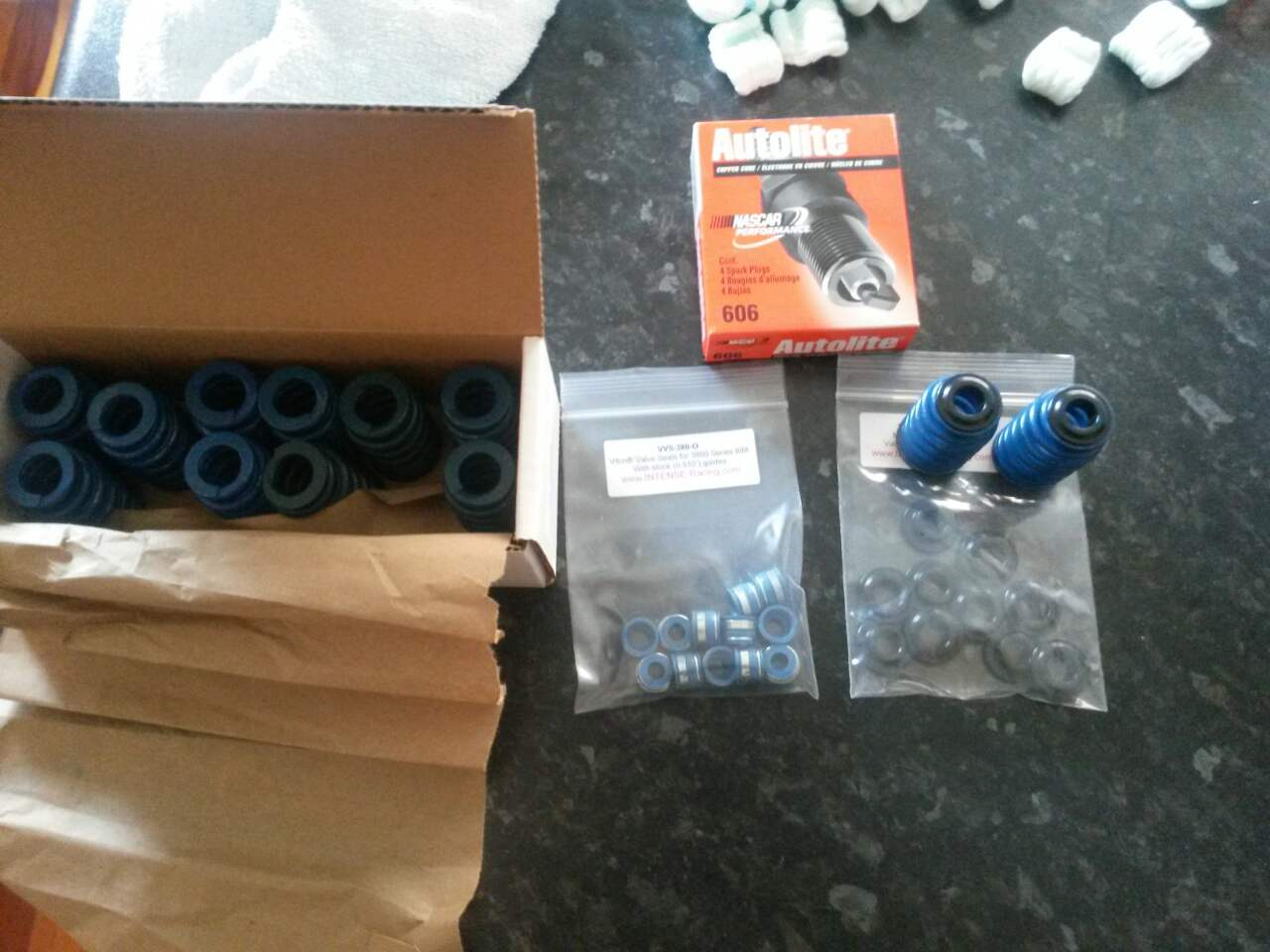

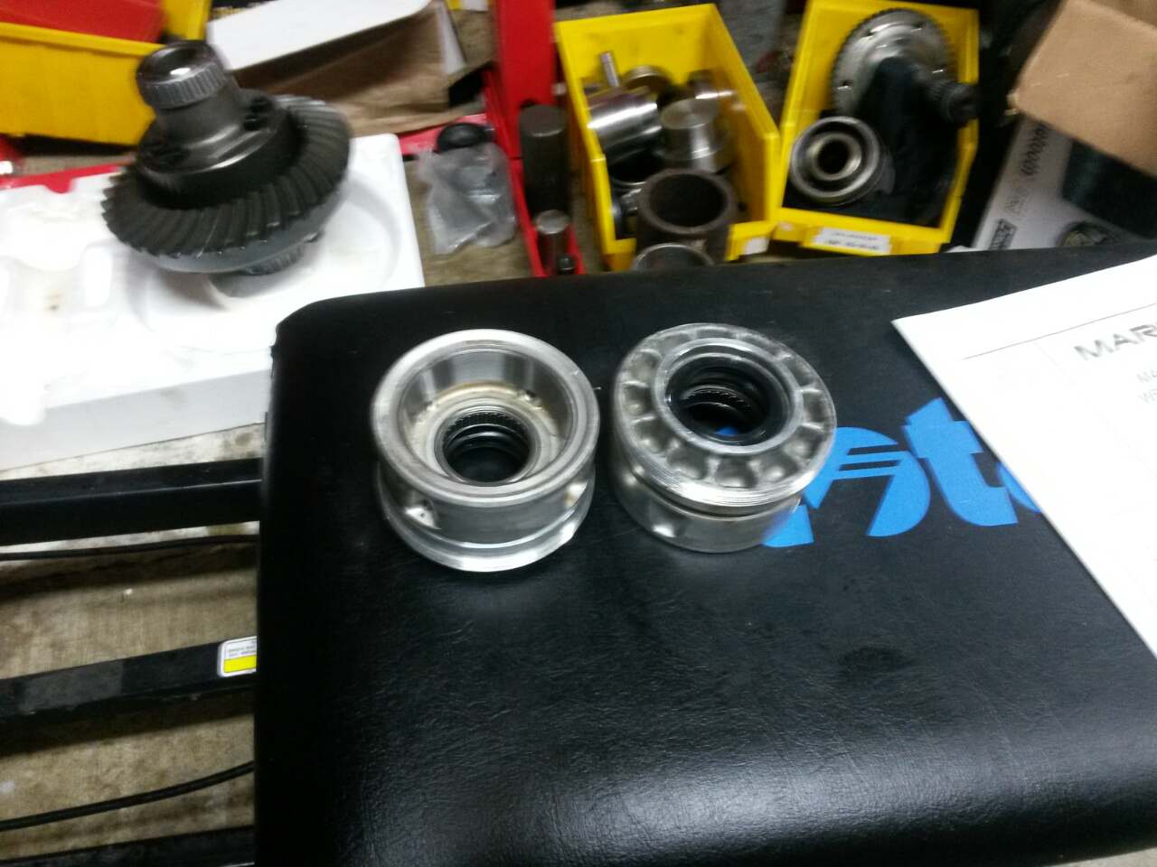

Some more goodies arrived this morning
Haven't had time to make up a tool at work yet. Hopefully have something made next week.

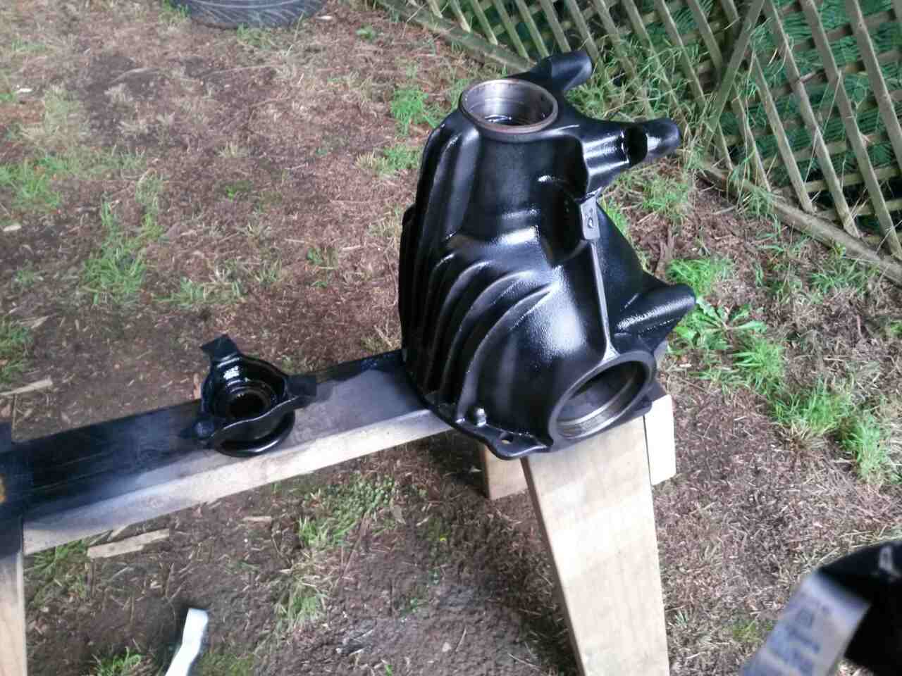

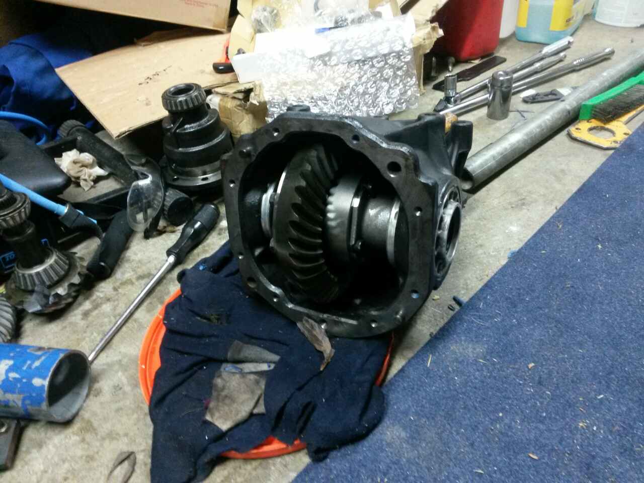

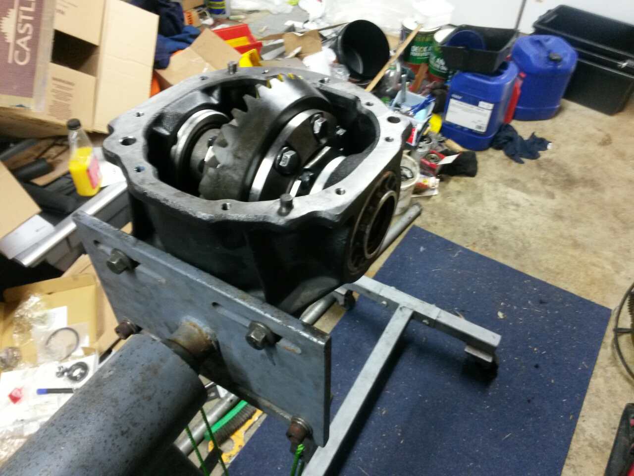

It's play with the diff day.
Pressed bearing onto the new centre, fitted the crown wheel etc. New bearings/seals in the hubs too. Then start setting it all up (I put the pinion in last week some time but no pics). ATM it's all just a dummy assembly to check it all over. No pinion seal or O ring seals in the hubs ATM until I'm happy with it all. Gave it all a coat of paint too last week. Starting to assemble it and check/set the back lash. Working on the floor just wasn't working out to well so I mounted the sucker on my home made engine stand.

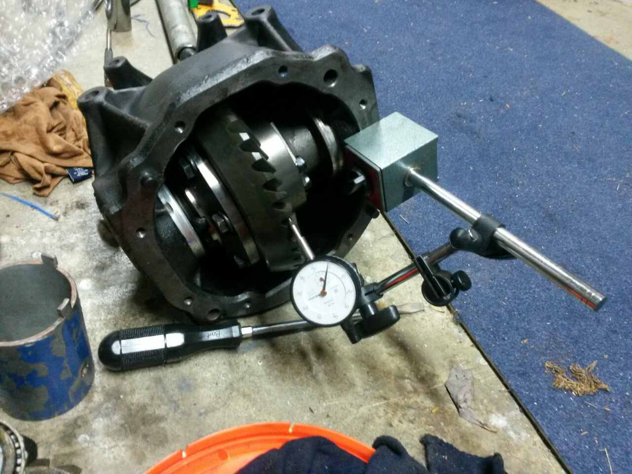

- Posts: 3820
- cars: VS,VT,VX,VE

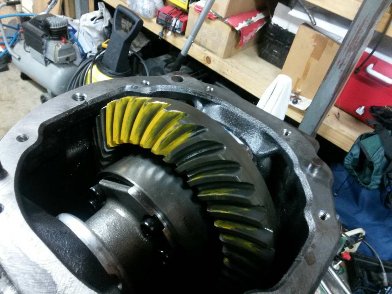

And probably the most critical part, the wear pattern.
What do the diff experts think? Back lash is about .007" (Motive Gear recommend .008") and the wear mark is probably a touch high up to tooth?

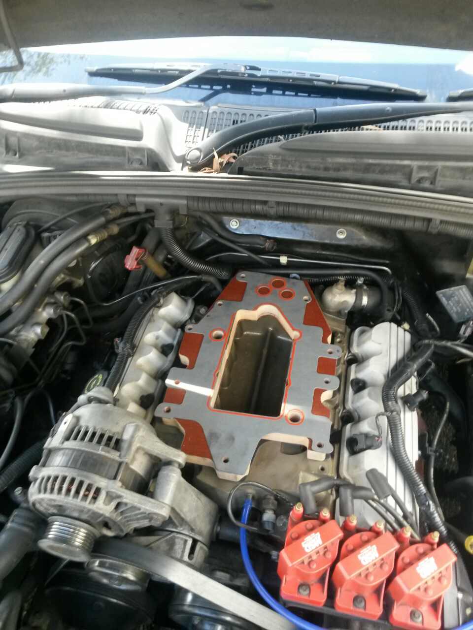

So this todays effort is this,
After seeing a thread on the L67 Torque forum where another member had done the same thing and lost a heap of boost I though I'd do mine to compare and it looks like the same result. Lost a heap of boost but as a bonus the air intake temps are lower. Unfortunately I forgot to hit record on the logger so I have no data at this stage. Going out to do another run shortly to get some numbers. Car feels totally different though, certainly lost a little throttle response.
