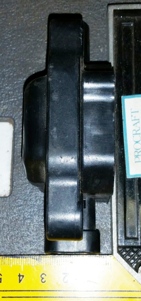

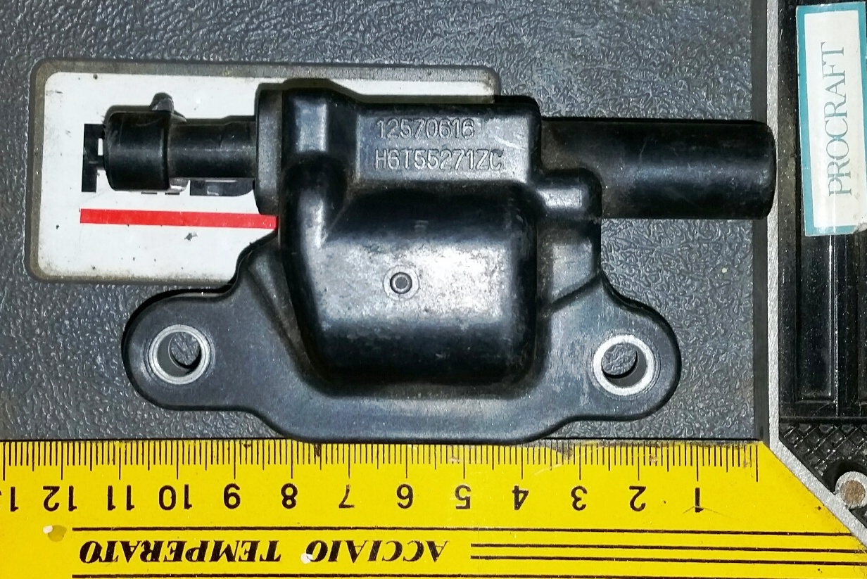

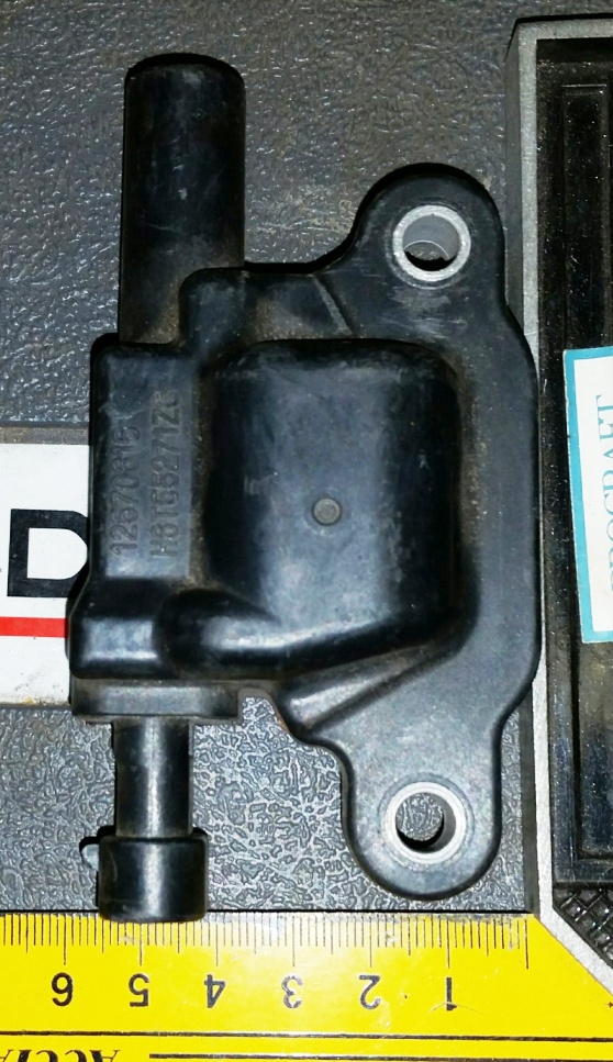

vlad01 wrote:Anyone have dimensions for ls2 coils? PN D514A.
Looked high and low and internet has 1 China copy result which is so low res it's unreadable.
All I could find was this:
https://www.amazon.com/ACDelco-D514A-Or ... B000IZ2C3K
Product Dimensions 4.3 x 2.7 x 2.7 inches
Which in English is 109.22mm x 68.58mm x 68.58mm, I'm pretty sure these sizes of the boxes that a coil comes in, but it's a starting point.
Posts: 5633
I could dig an ls2 truck coil with heatsink out and measure if you need
I have LS2 coils at home ?
Yeah see if they are the same as what I need measurements for. The Gm PN ends with 290. Ls2 truck ones are a fatter than that ones I'm planing to use.

So I can see if they will fit in place of the dfi and coil pack without interfering with anything and the bonnet.

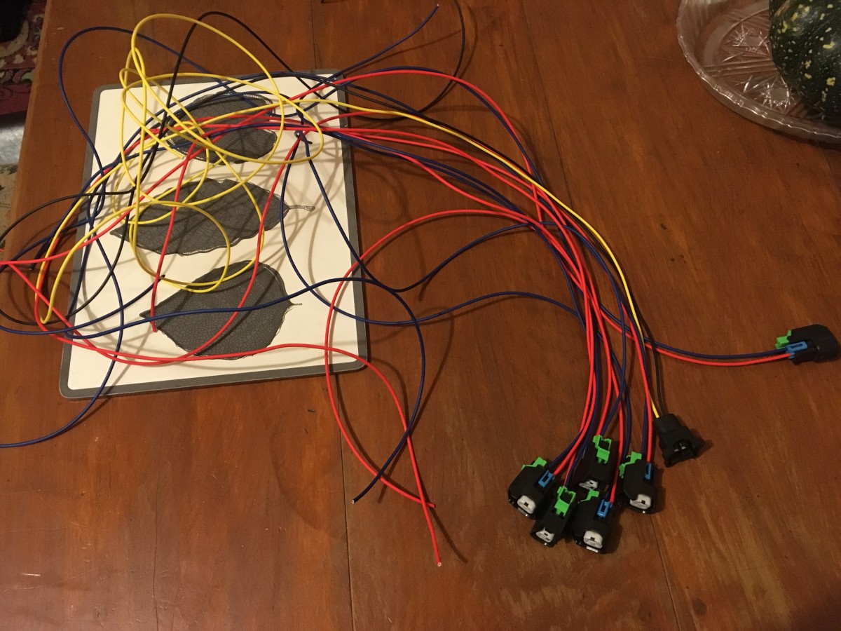

I got these done tonight, Turned out alright.
I had to modify a spare set of dies to do the injector ones because they aren't designed to do sealed terminals. Worked well but a few other connectors I have will require a end mill to machine out those strain relief die areas so I can get to the actual wire crimping without destroying the whole terminal as I already tested with a few spares.
So I will try to get the die to the engineer and do a quick mod for me. The steel is shit hard, took me over 10 min of solid grinding with a carbide burr to take away about 1mm.
