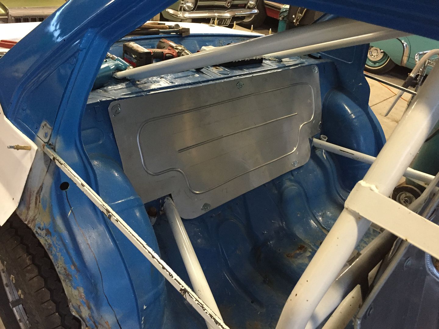

Progress, I don't normally gloat but that rear firewall panel is fucking awsome :D

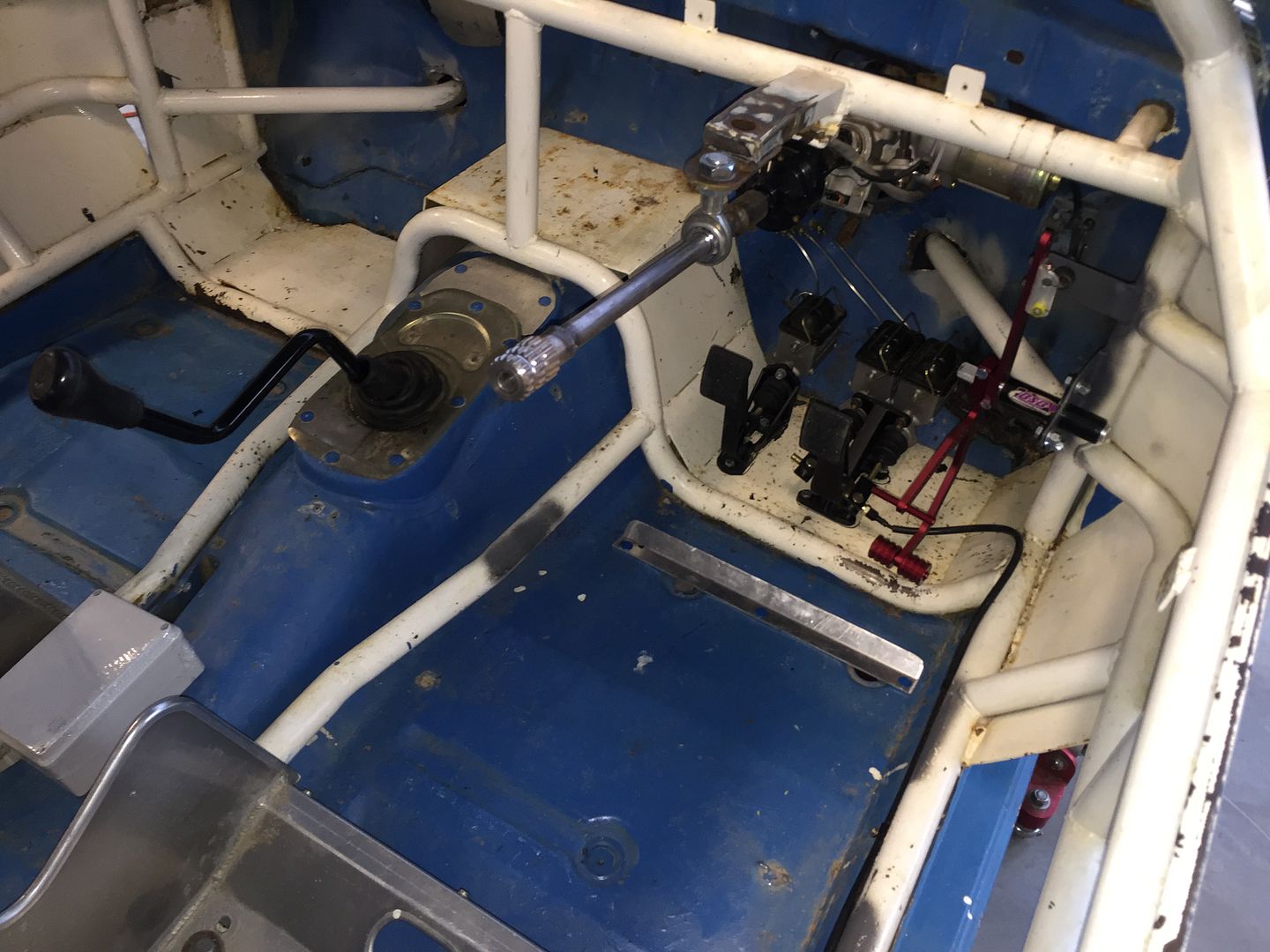

And all the driver controls are done, I'm not sold on the brake pedal position, I might move the clutch to the top of the trans tunnel to give more room for the brakes

yeah your right the back seat panel is the business :D
shes certainly getting close to being back together!

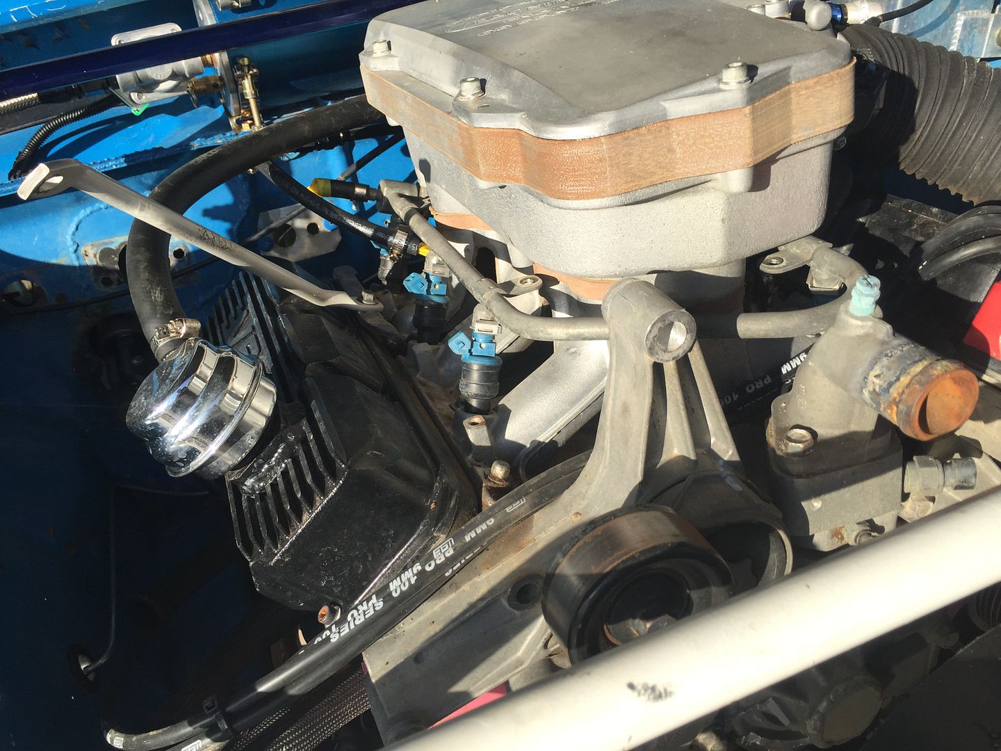

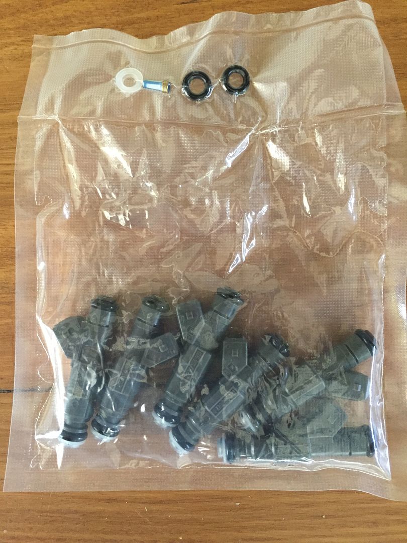

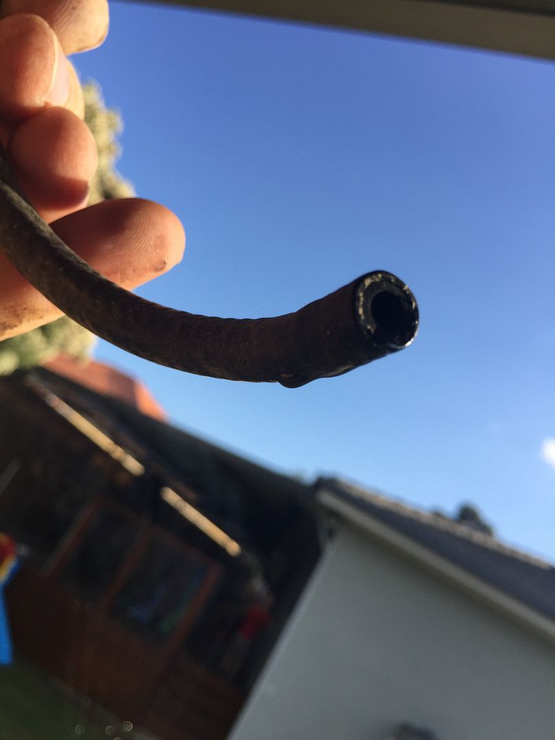

These turned up in the mail today from The1, should add that they come really well packaged and the injectors where numbered ready to go, very happy with these :D
So i pulled those blue ones out,Image

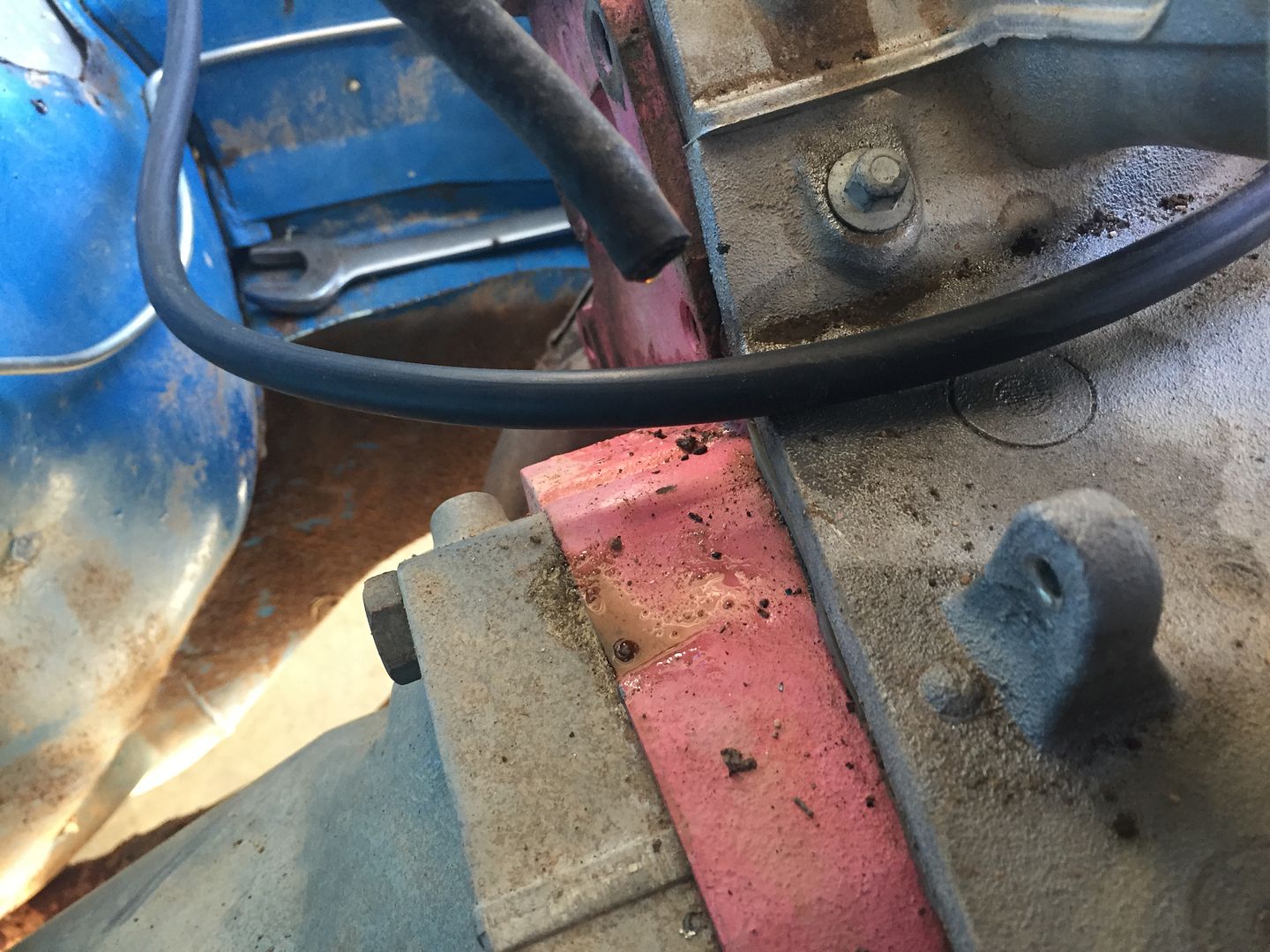

And found fuel dripping out of this...
That is the vac line for the pressure reg... Explains a lot...

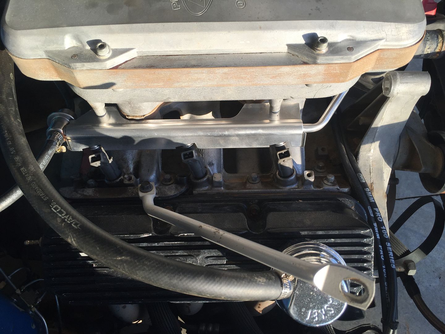

Changed to a VS style rail so as to be able to weld in the dash fitting, i assumed the injector retainer clips where the same, they are not...
Posts: 8601
Re: How to loose 200kgs?....
VN-VR clips should fit.
Those VS regs are 3 bar btw, the VT on are 3.5 bar.
Posts: 4853
Be good to see results and how the injectors go!
clips will fit, but are a bit loose, if you want VS-VY Clips i have bag fulls, can put a set in an envelope.
Vlad there are some 3.5bar VS rails out there to, you just have to check the label on the reg.
