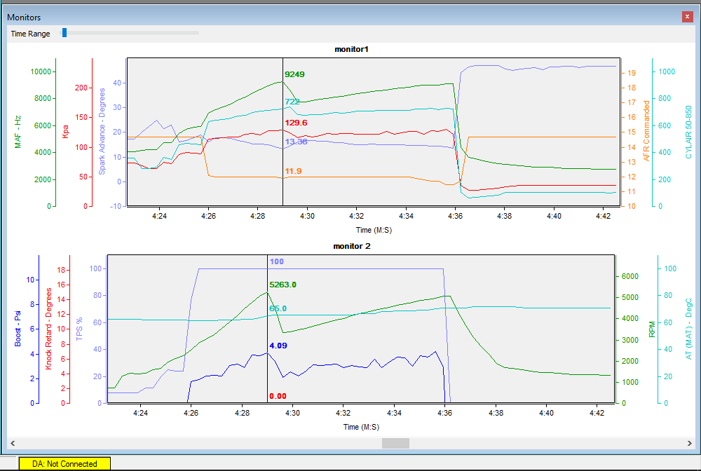

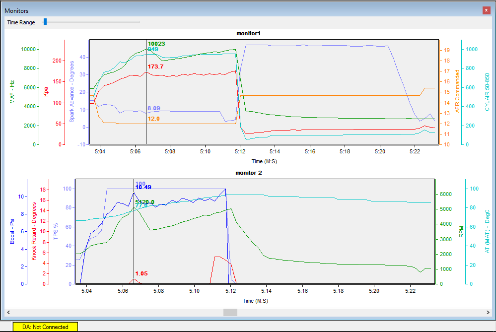

I have dropped the shift points to 5200rpm with the high ratio rockers until the new valve springs are fitted. After fitting the spacer, It's lost a whole lot if intake heat under boost but it's also lost a whole lot of boost. This mornings run was a max of 10psi with intake temps hitting 93°C this afternoon with a higher ambient temp we are only seeing 4psi boost but intake temps are way down only seeing 72°C.
Cylair is way down to 730 from 940 before the spacer. MAF hz have dropped a little from 10200 to 9200. I do have a belt issue but it's to tight rather than to loose. The pulley is cooking on the front of the blower. Will need to get a longer one pronto.
Looks like some major retuning is going to be in order.
edit: ignore the large variation in boost. I'm 99% sure it is because I'm only logging at 3hz in passive mode. I'll do some more logs without passive mode to get better data.

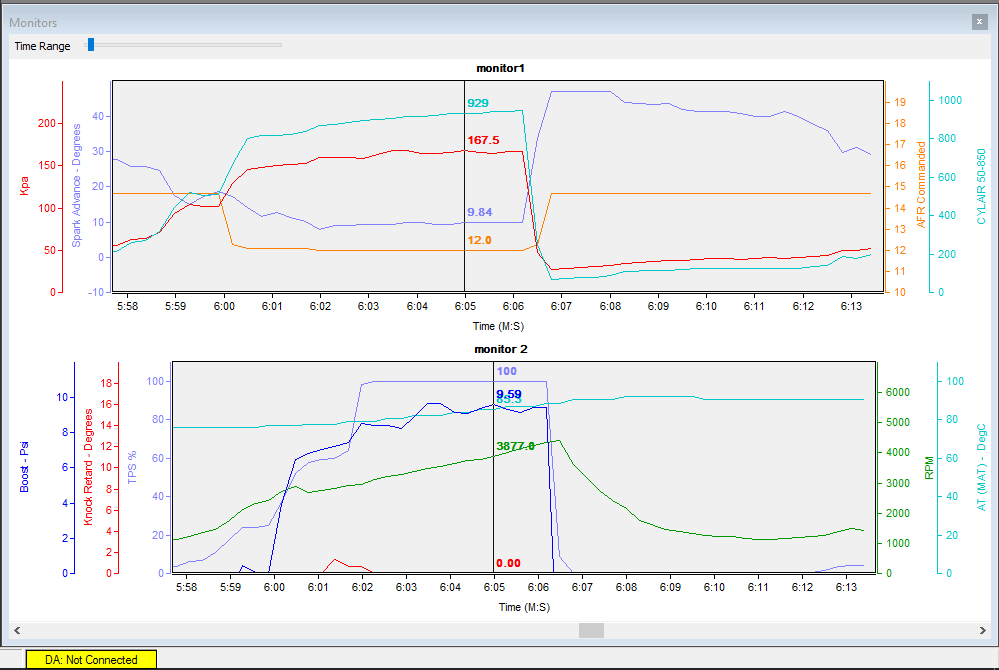

Well it looks like the boost bypass valve is toast
Replaced the vacuum lines, got rid of the vacuum leak but still no better. Then bypassed the valve altogether and hey presto, got my boost back but with the bypass been closed all the time it's increased the IAT's too now seeing 80°C when cruising once everything is up to temp where as before it was ~60°C. Bugger it, going on a long road trip on the weekend so I don't think there is time to get a replacement valve anywhere.
And a pretty picture to go with it.
