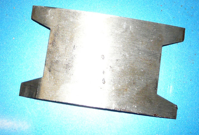

i agree Yoda, the crow info said 8.7 inch plus .1 (holden super duty for solid lifters) .... so i figured super duty would mean hardened, but as it turns out it means they are thicker walled, as you can see in the pic .080 wall.

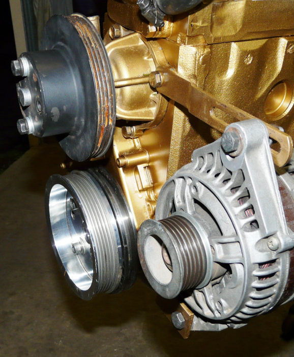

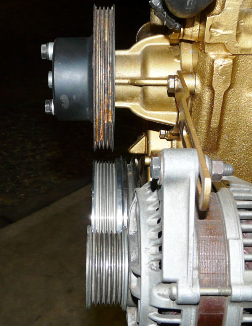

well with all the rocker gear sorted i was able to put the balancer on the motor and get the pulleys all lined up!
so for those interested in the 202 with serpentine pulleys here is some pics
i'll go to the shops tomorrow and see if i can find a 875-910mm serpentine belt!

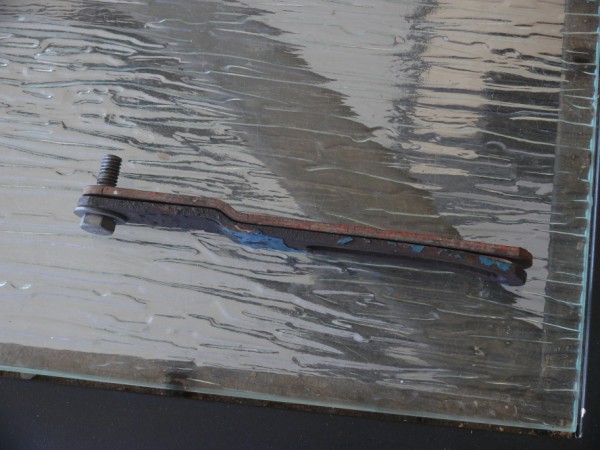

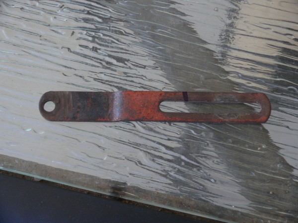

If you fit 2 alternator brackets together(like the 1st pic), it may stop them from cracking as they have a habit of doing with higher revs, they can also be tack welded. I've marked the 2nd pic with texta, this one is cracked near the bolt hole.
Re: My Delcoed Rides
i've never had an issue with them cracking in the past, but its worth keeping in mind .... also im hoping with the belt i just got from super cheap auto today that my alternator will be right in on the adjuster in which case should be less chance of it breaking.

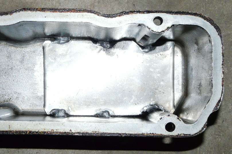

now one mod i've just completed is an upgrade of the baffle in the tappet cover, normally this plate is bent enough to fit inside the tappet cover and pushed to the top, being spring loaded it holds itself against the edges, but i have had it fall out once or twice in the past and sit on top of the rockers, obviously making a lovely noise!
this plate covers the PCV fitting in the back of the tappet cover.
so i wanted to fix this issue once and for all so i figured why not make an alloy baffle and weld it into the top of the tappet cover ..... so i did
hopefully should never have another issue with it again!

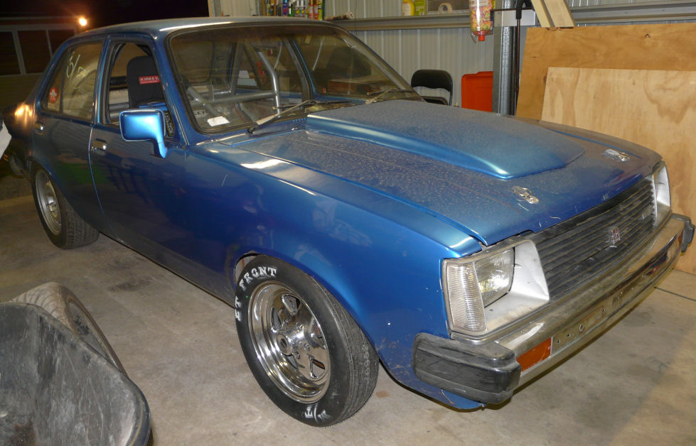

well its all but done, the motor is in, almost everything is connected, i've even primed the fuel system and got oil pressure (with the plugs out) so im ready to fire her up tomorrow, would have tried tonight but i didn't want the cops at my door at 11pm!!
rest assured there will be a video of it running tomorrow morning some time!!
