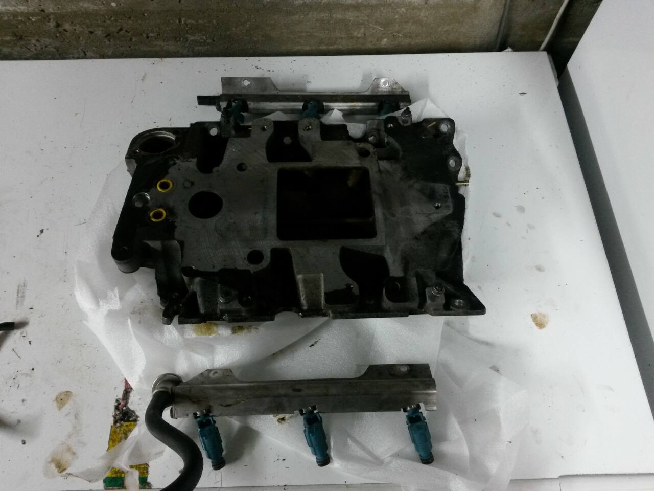

So a little progress this morning. Found the old ecotec intake manifold and removed the fuel injector rails, so we start with this.
I'll take my old LIM to work as well, give it a big birthday and them maybe put it on the mill and open it up to suit W2A, It may end up been swapped onto a mates car and then I can sell off what I end up with.
A point of interest, our old VS was 1997 production model, the factory reg on the rail is marked 350Kpa....

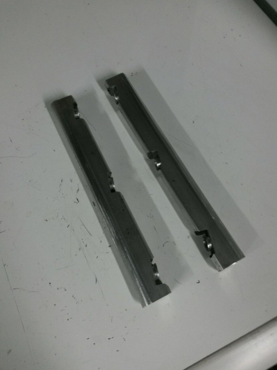

Then I stripped it all down, cleaned it up a bit and then cut off the mounting tabs and filed it all down so we end up with this,
Next I'll take em to work, clean em up more with some wet&dry and then give em a quick polish on the buffing wheel.I'll take my old LIM to work as well, give it a big birthday and them maybe put it on the mill and open it up to suit W2A, It may end up been swapped onto a mates car and then I can sell off what I end up with.
