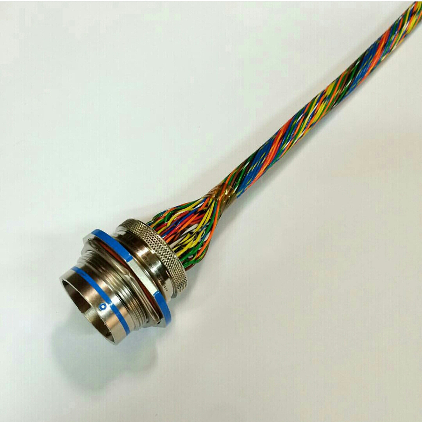

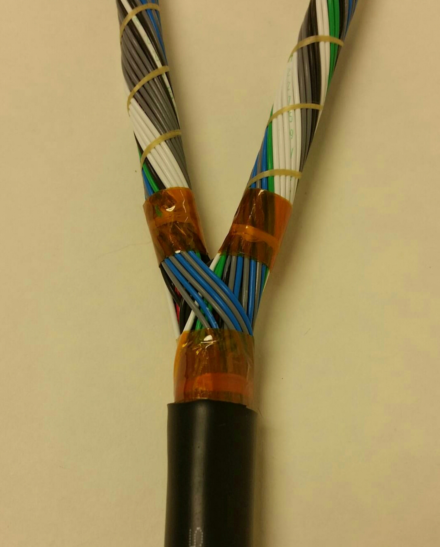

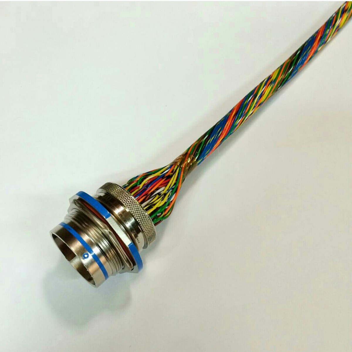

The mil spec mobs in the USA that are motec certified do this. Modeled off NASA designs and military. All the twisting and loops are ther for reasons. Concetric twisting and service loops. Tefzel wire and rychem heat shrink are very popular.
Once wrapped like that and using the right hewt shrink they are extremely flexible and no stress kn any individual wires. Each layer of wires are wrapped opposite ways. Very interesting to read up on.
The F1 harnesses are different again I'll try to find a pic they are hard to find. They ae flat woven and interweaved.
