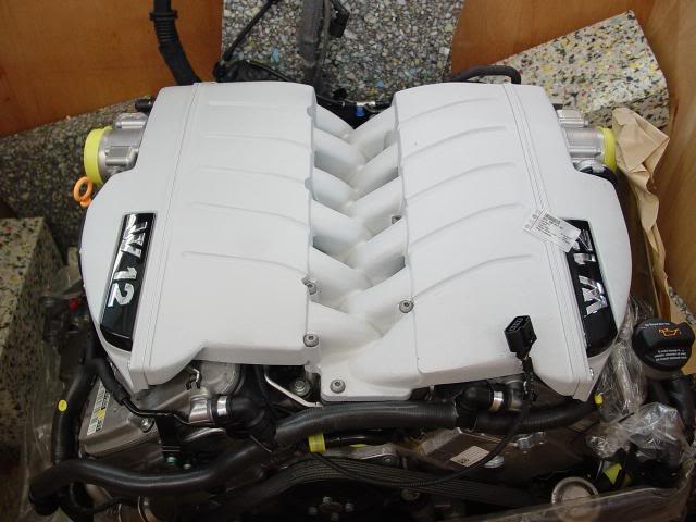

Re: OSEPlugin for Tunerpro 5 v2.02
I found a w12 for youI was looking on ebay, couldn't even find a W8
http://forums.vwvortex.com/showthread.php?4641132
- Posts: 10012
Pretty cool but lets keep this thread on topic. Please do start a build thread for v12 and w16 projects
