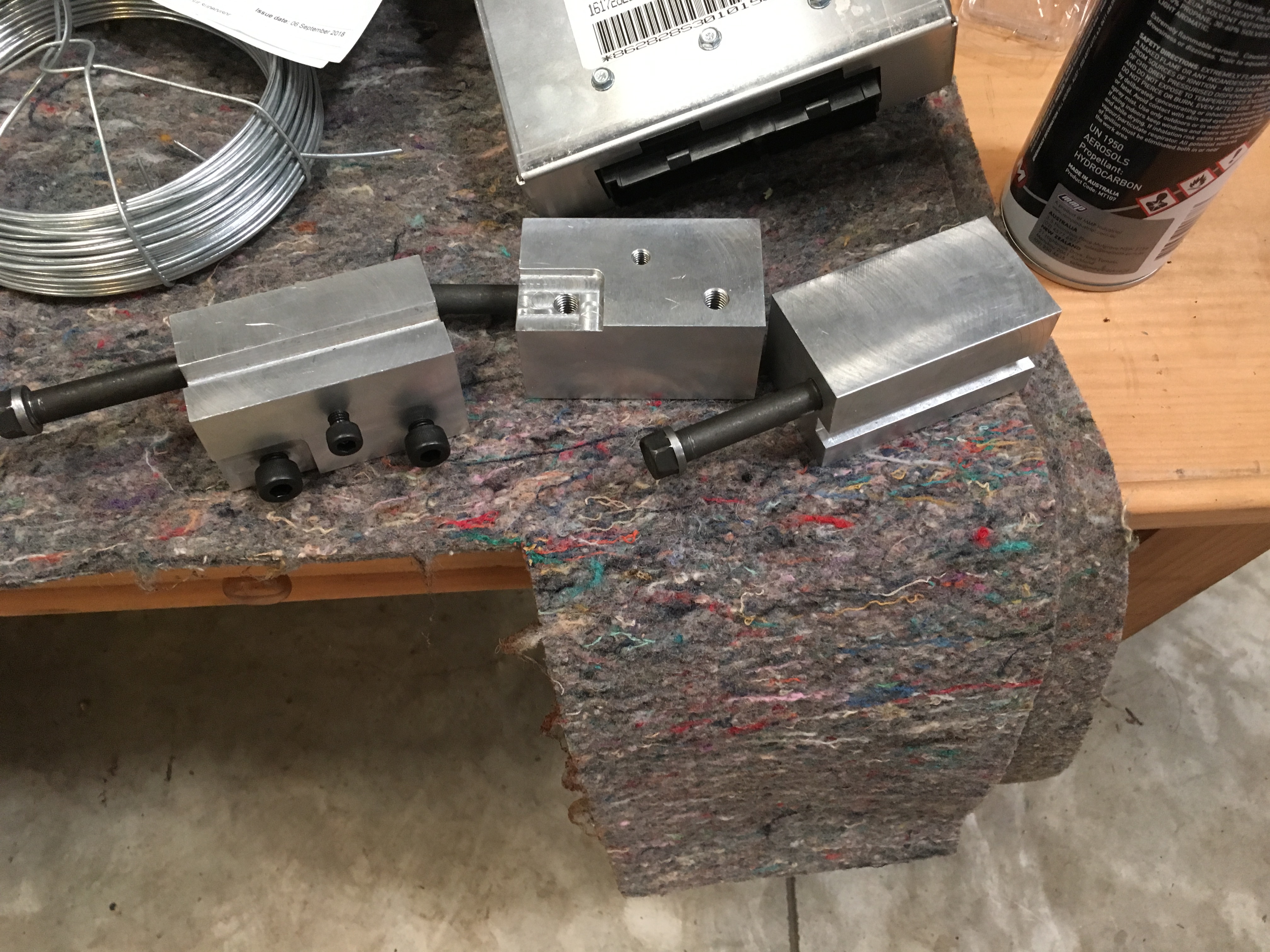

These arrived. Too bad the car is away so I couldn't do a test fit up.

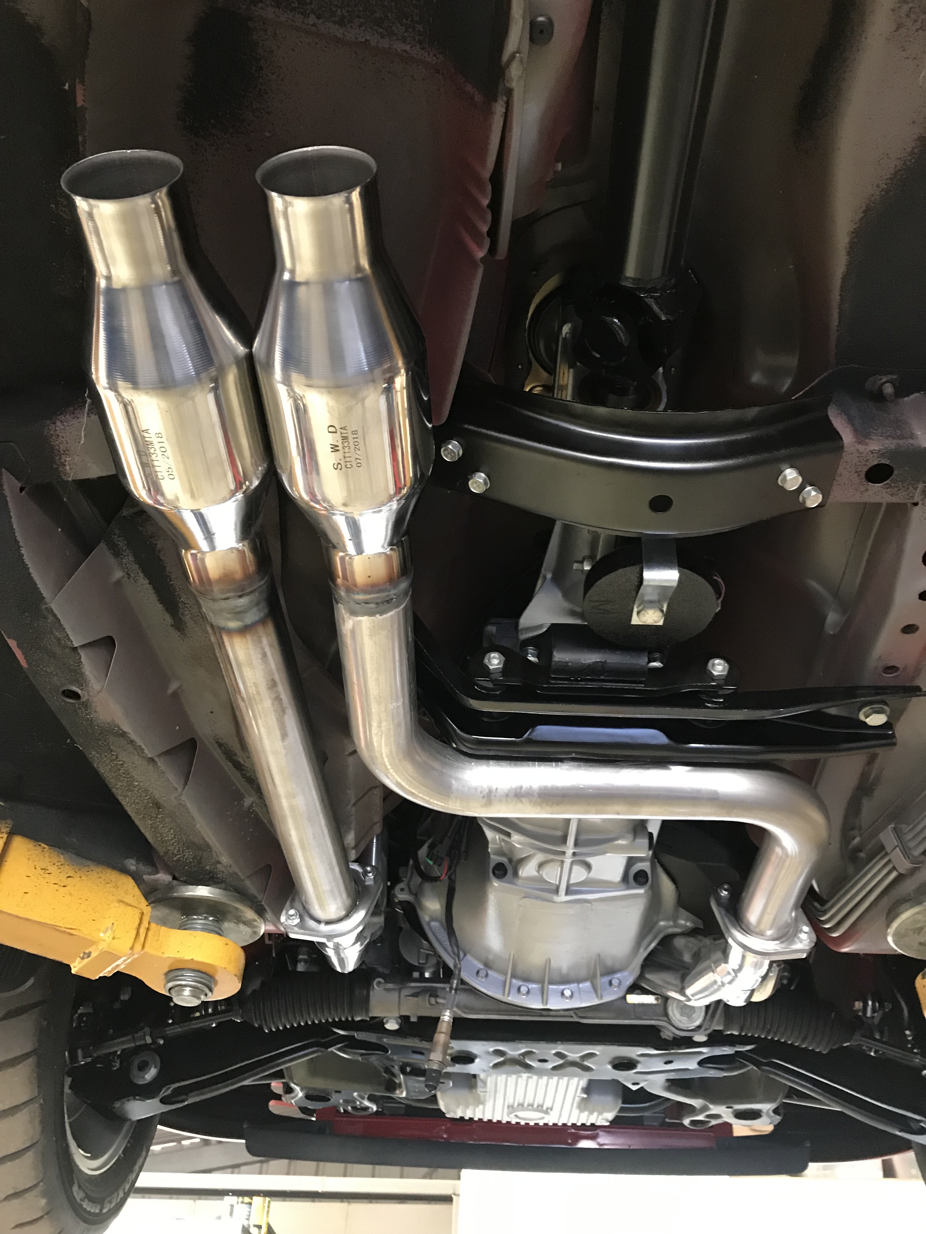

I got sent this pic just before. Progress!

Exhaust porn
- Posts: 7845
It's a shame I have to drive it, just too clean under there.
Apparently it's going to be moderately loud as it's getting 2 x 5" round by 14" long mufflers and that's it. Can't get a dual in/out muffler that fits. either way too big it won't fit the car or too small that it would be barely better than straight out.
Worst case he will add 2x 3.5" resonators at the rear as that it the only possible size that would just squeeze in.

I had 2 oval glass packs stacked side by side on a slight angle in mine in the factory spot and 2 hotdogs at the rear it could be heard kms away lol but man did it get off its arise when you stomped on it haha
- Posts: 7845
that's the plan! full comp headers will certainly help the tickled engine breathe.
What's the black round thing with an M on it, underneath the tailshaft/transmission?
- Posts: 7845
Pacemaker competition version with 1-5/8" primaries. they fit better than the normal pacemakers ironically.OZ38 wrote:What make of Headers are those vlad ?vlad01 wrote:
- Posts: 7845
FXST02 wrote:What's the black round thing with an M on it, underneath the tailshaft/transmission?
Vibration damper. Standard on all pre VS t5 V6 boxes.
