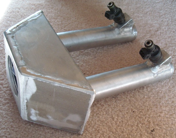

been a while... this part of the project is the most difficult to organise - the manifold. I owe my dad a whole day of work for doing this for me
all I have to do now is make some forks up to hold the injectors into the manifold and mount the throttle body on. im just going to use a 4 way Tee on the fuel line, two hoses to injectors, one to the reg and one to the fuel pump.
Re: Delcoed 750cc Motorbike Engine
nice work dad
out of interest, does something like a V6 fuel rail line up with the injectors or anything ?
bring on the first start i say
