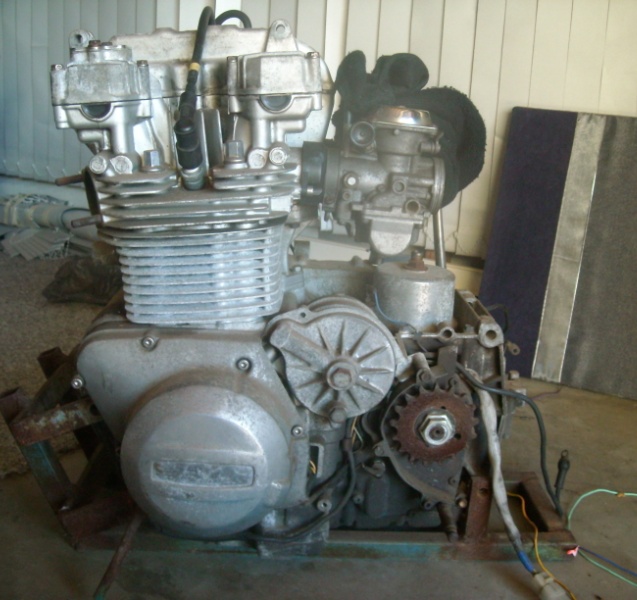

Just got a hold of my latest project. I am going to attempt to Delco a 750CC twin cylinder four stroke motorcycle engine. the engine in quesiton will then be insterted into a go kart frame (The Edge mini sprint) and lots of fun will ensue. I have no idea what kind of engine it is. if any one can identify it that would be great. I cant find an engine number anywhere (I havent looked at the sump yet that thing is just too heavy for me :shock: )
My plan is to use a camira Memcal and $12P in four cylinder mode, being only a 2 cylinder, the ecu will only see half the revs the engine is really doing but I can adjust my definitions for that. also if my theory is correct, the four cylinder is expecting 90 degrees between ignition pulses so the engine will see double the timing advance that the ecu commands. again, I can just adjust my definitions to suit.
for the throttle body, again, camira parts, ill make a manifold 2 into one and have a camira throttle body and IAC valve mounted there. the injectors will be as close to the head as possible pointing in the general direction of the valve.
RHS with crank trigger and CDI visible

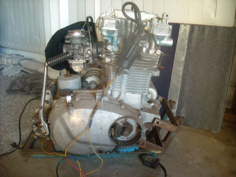

LHS with alternator visible and blank name badge where it was torn off :(
Back side (yes that is a pair of old socks hanging out the carby)

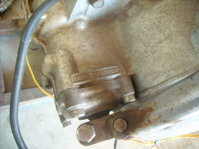

just in case I cant figure out what its for. youd have to be hercules to kick start this baby, im not even going to try, I dont need a broken leg
Starter motor and Engine size label
crank trigger. now I hope this is a reluctor, it looks like one to me, so my plan is to hook it up to a camira ignition module and use the coil that it already has as it is 12v anyways.

Re: Delcoed 750cc Motorbike Engine
this is a very cool project, i'm looking forward to seeing how well it works!
Posts: 5627
looks like suzuki 750 special :punk: thats my guess anyway
Kawasaki KZ750 is my guess .... can't find the right year model though
Posts: 2585
Location: North Coast, NSW
Post by Jayme »
good work Holden202 :D and thanks for these links for kz750 info..
