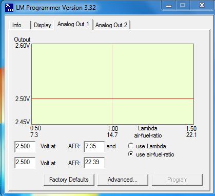

VL400 wrote:You can test the output by adjusting the settings in the LM programmer. I have not tested this yet but from reading the manual it should work... :lol:
The 'Output at Error Cond.' is by default 0 volts. So you can use that to force a voltage and compare what TP reads with no sensor connected (ie no heater causing ground offsets). Setting it at 2.5V TP should read 14.87 AFR if the MTX-L is set to default values. The calc is (Voltage/5 * (22.39-7.35)) + 7.35 or simply (Voltage * 3.008) + 7.35. So... (2.5 * 3.008 ) + 7.35 = 14.87AFR read in TP
With the sensor connected you can adjust the 0-5V output. By default it is..
0.000V at 0.5 Lambda (7.35 AFR)
5.000V at 1.5 Lambda (22.39 AFR)
Can change both to say 2.5V and then see what TP reads. Same calc above if you want to change the voltage.

Also connected the sensor and set both at 2.5 volts with sensor connected and TP read 15.40.
TP wideband 2.5 volt AFR reading - 2.5 volt AFR settings - sensor connected (4).JPG
TP wideband 2.5 volt AFR reading - 2.5 volt AFR settings - sensor connected (4).JPG (18.79 KiB) Viewed 5490 times
2.5 volt AFR settings (3).JPG (34.32 KiB) Viewed 5490 times

Anyone got any suggestions on what I can do to get my mtx-l & TP dash reading the same based on my screenshots a few posts above? Any help is greatly appreciated.
