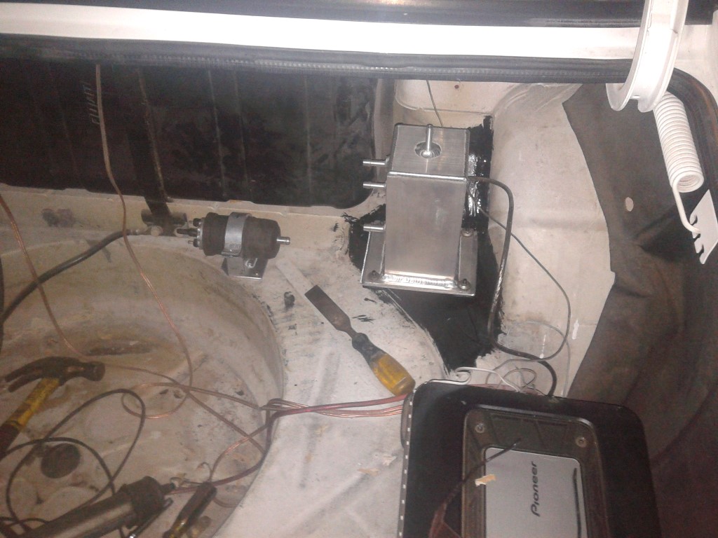

Bracket on car to mount coils
20130629_213749 (Medium).jpg (128.42 KiB) Viewed 6390 times
surge tank mounted in boot
20130709_172113 (Medium).jpg (168.59 KiB) Viewed 6390 times

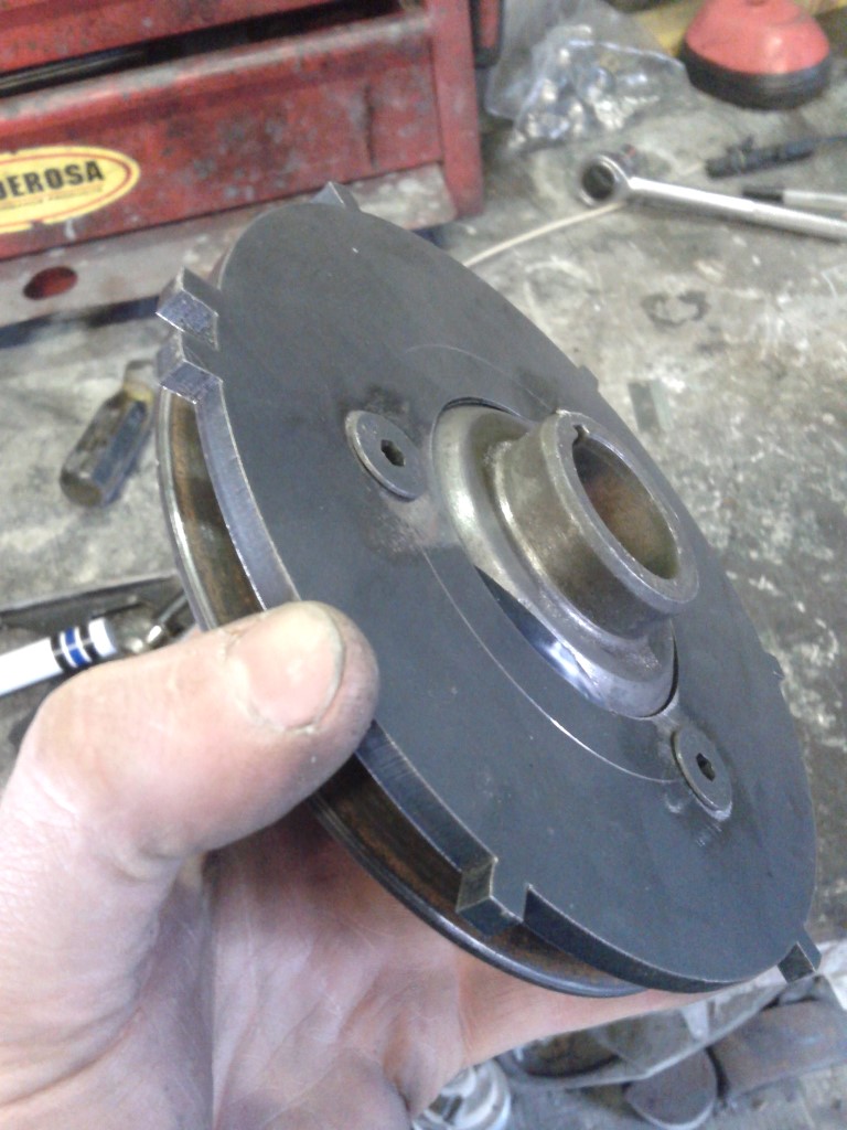

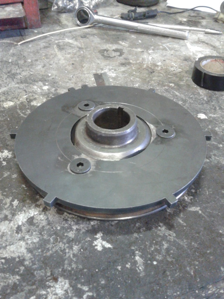

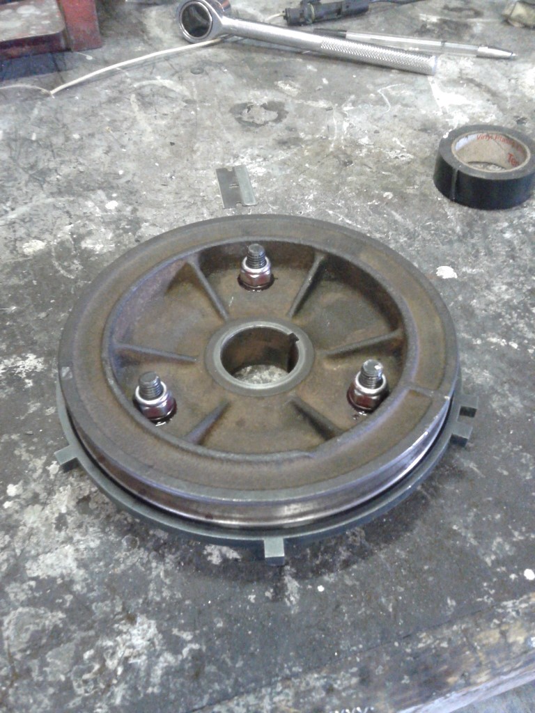

Custom CNC cut trigger wheel bolted to back of  standard pulley
20130724_111659 (Medium).jpg (199.54 KiB) Viewed 6390 times
20130724_111709 (Medium).jpg (223.28 KiB) Viewed 6390 times
20130724_111725 (Medium).jpg (170.06 KiB) Viewed 6390 times

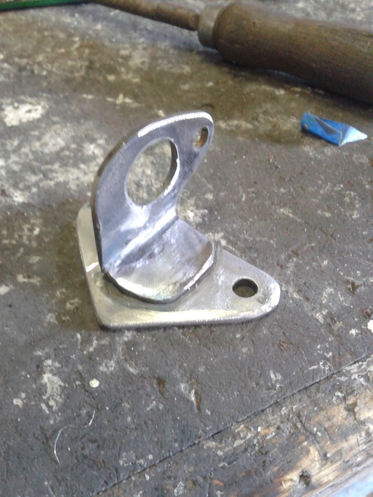

ABS sensor mount
ABS sensor mount
20130724_141449 (Medium).jpg (192.16 KiB) Viewed 6388 times

Fantastic work :thumbup: Looks really neat.
Looking at the pick up mount your using the commodore ABS sensor instead of the Falcon, did the Falcon one not work or just went with the tried and tested ABS sensor?
