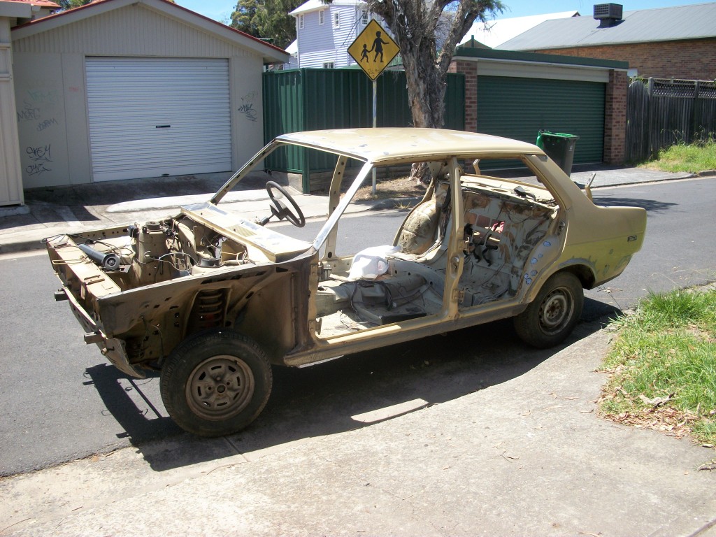

Hello people, The names Andrew, im from Sydney and this is my car..Its a 82 fiat 131 which was in the following state when i got it..

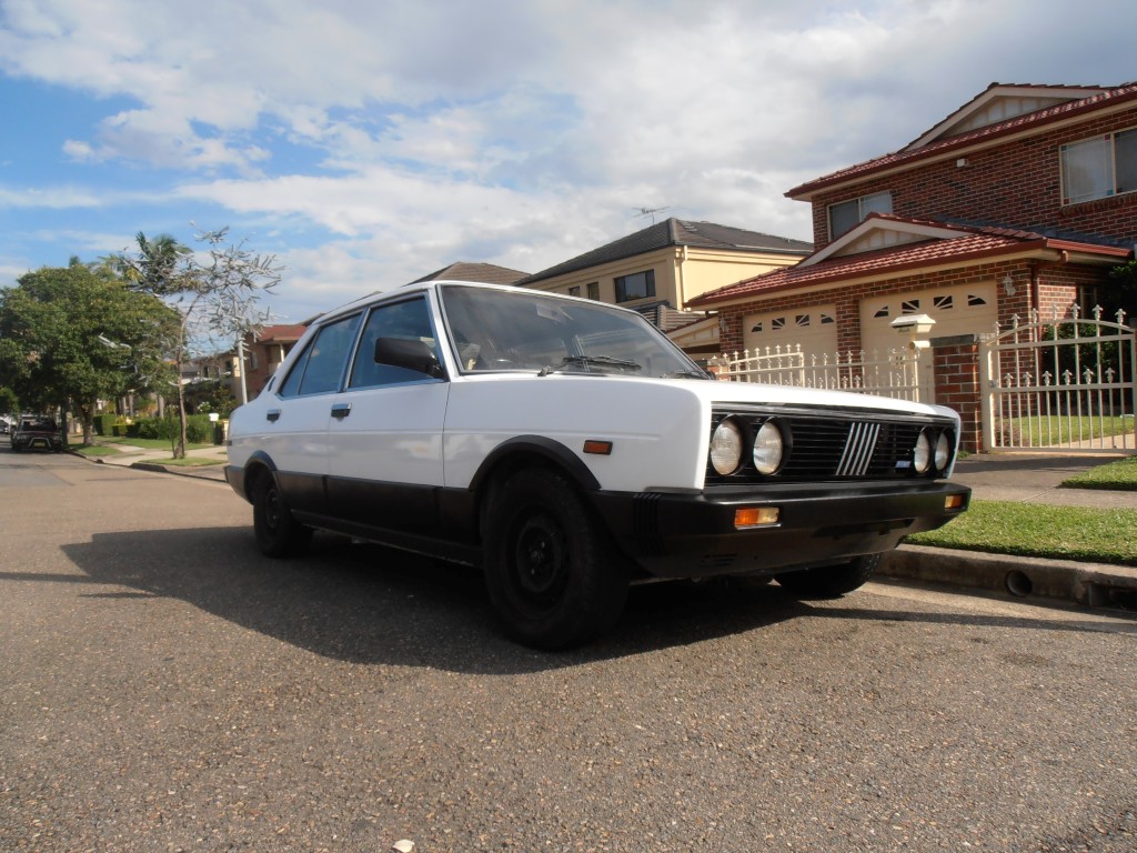

After some months of hard work it looked like this (have since got some 15' alloys under it)

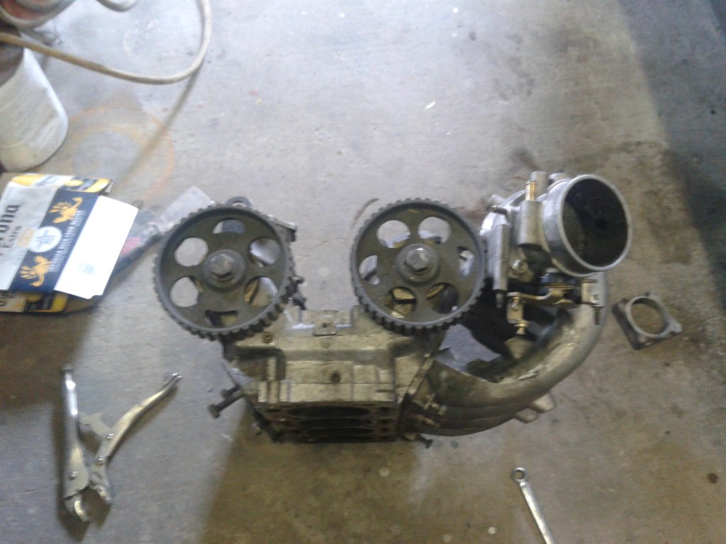

The engine currently is a 2L twin cam running twin 40 dellortos and extractors, my plans are to convert to efi turbo using the delco system
Ive begun acquiring the parts necessary to build a turbo engine, in particular most of the delco related parts...Since im new to EFI you guys can expects a lot of questions :wtf: More details and images to come!

And for my first question, which may be stupid so forgive me but does the angle at which a commodore throttle body sits matter? Im planning to have it positioned like so...
Posts: 10436
Re: Mrfiat's fiat 131
as far as I am aware the only thing to try and do is make sure the IAC part (on the left of the TB in the last pic) is not as the bottom but other than that just whatever works for you really!
looks like you've brought the car a long way already, and the delco with turbo should help :D

Thanks for that, just to confirm (im a little thick) the IAC shouldn't be positioned at the bottom as in the location of the throttle arm in the middle picture?
Posts: 10113
I assume the logic is to keep crap from collecting in it. how your thinking looks fine to me.
Posts: 10436
yeah to stop it getting clogged with oil vapours and such, how much difference it makes I don't really know though, I had no choice and mine is down!
