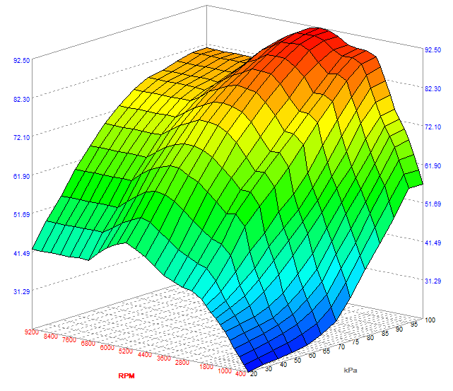

its common for there to be a bit of a dip around that RPM. build one in to your tune and it'll be right.
You might find it ends up something like this:

Thanks mate, ive been a bit weary of some odd shapes and keep trying to smoth them out but after countless logs (and 10 bin's) in around 4 weekends they keep coming back so best to roll with them i guess. Im pretty hung up on a nice neat graph, because i want to put the bin in the cusom tune section once finished so want it right AND looking good.

the graph above is still neat and nice and smooth

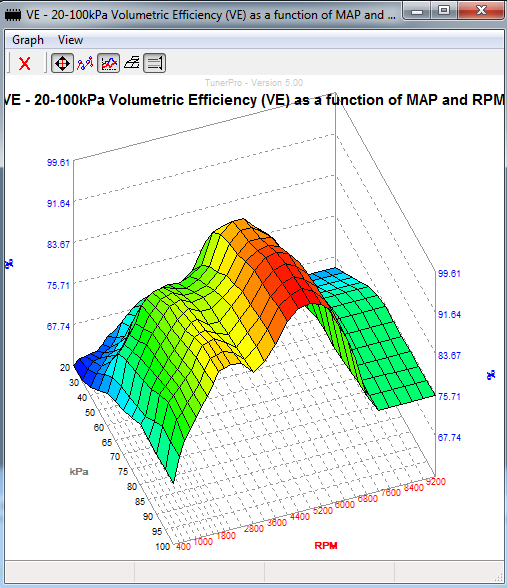

Ive noticed hor ruff the factory ones are. maybe im going to far this is from my next bin. Going to got back over the logs from the last bin again.
Last one was pretty close i think. Worst part is i have no idea how far off target AFR is acceptable, spot on i guess?
Still got AE to look at most parts of the rev range it's adding around a 3 afr increase. Im tipping thats way to much.

How close is up to you (and the limitations of your wideband). I'd say close in and see whats possible. Start with better than 2 points (im sure your already there), then 1 point, then 0.5, sooner or later you'll realise your making no more head way and the engine is running pretty good and you'll decide "thats done!". I think perfect is not a reasonable expectation, as there will always be slight inaccuracies in fuel delivery, fuel pressure, voltage offsets affecting temp senders etc. I'd say within 0.5 of target is decent, maybe 0.2 is a really really good tune with good condition/accurate hardware. I dont think you'll get repeatable results much beyond that even with the best engine hardware and sensors which will mean a closer tune is not possible. But if your still going and its still getting closer, keep trying.
I suspect your engine will need a bit more of a visible dip close along that 2600 rpm row, and it may be slightly wider too. If you cant see it in the logs clearly, you can also take an educated guess then take another log and observe the result for better or worse.
