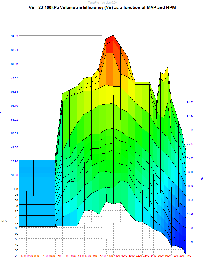

ill be interested to see how the WOT looks when fully tuned. in that log I dont see any WOT runs from low RPM where you will encoutner the spike I did.
heres my early tune to suit a 355 with come racing manifold. note the massive spike at low rpm. believe it or not... the wideband is a dead straight line with that mountain range of a 100kpa VE.
