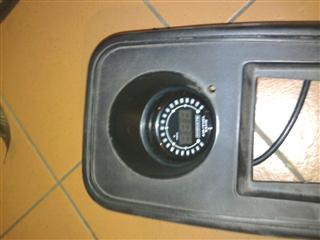

Slow build I know
Found a nice place for my New Toy
Re: Toyota 2TG/3T Hybrid
the new gauge will be much more useful than the old one im sure!
Yes specially when it doesn't keep good time anyway.

the speedo drive gear, the T50 one from the original Celica dash plugged into my w57 no issues when I put it behind the 4AGE
and no the old jayco clocks don't keep good time at all. i have the non GT povo spec ones and a GT povo spec one and that doesn't keep time at all. i replaced the whole shebang with a fuel gauge and volt gauge in my TA22.
