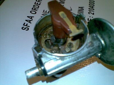

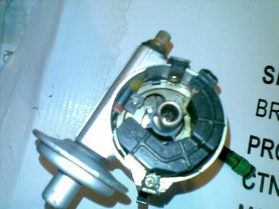

- Modified Dizzy
- Pics3.jpg (26.23 KiB) Viewed 9044 times
- Stock Dizzy
- Pics1.jpg (23.64 KiB) Viewed 9045 times

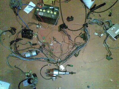

- What will be the wiring loom when completed but my current Test bench
- Pics4.jpg (36.86 KiB) Viewed 9045 times
