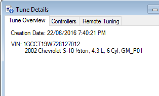

This is the tune im looking at:
and i've attached the hpt file if that helps at all ?
regardless of this side of it though the main question is does it work any other way crank/cam trigger wise, while yes you can run them on a coil pack etc thats not what i'd like to do, the whole idea of it is to get the multi coils and all the 0411 pcm benefits.

Re: P01 '0411 12200411 v6 support
Im not sure what the filename is referring too (its not the OSID like most are named) but I can confirm the file is good on an '0411. I wrote it to my bench setup and it boots up and runs fine. Then I read it back with PCM Hammer. When we support OS updates this looks like it'll be usable if you can build a V6 car around it with the right sensors. 12212156 was used on V8 Chevrolets of the same era as well.
