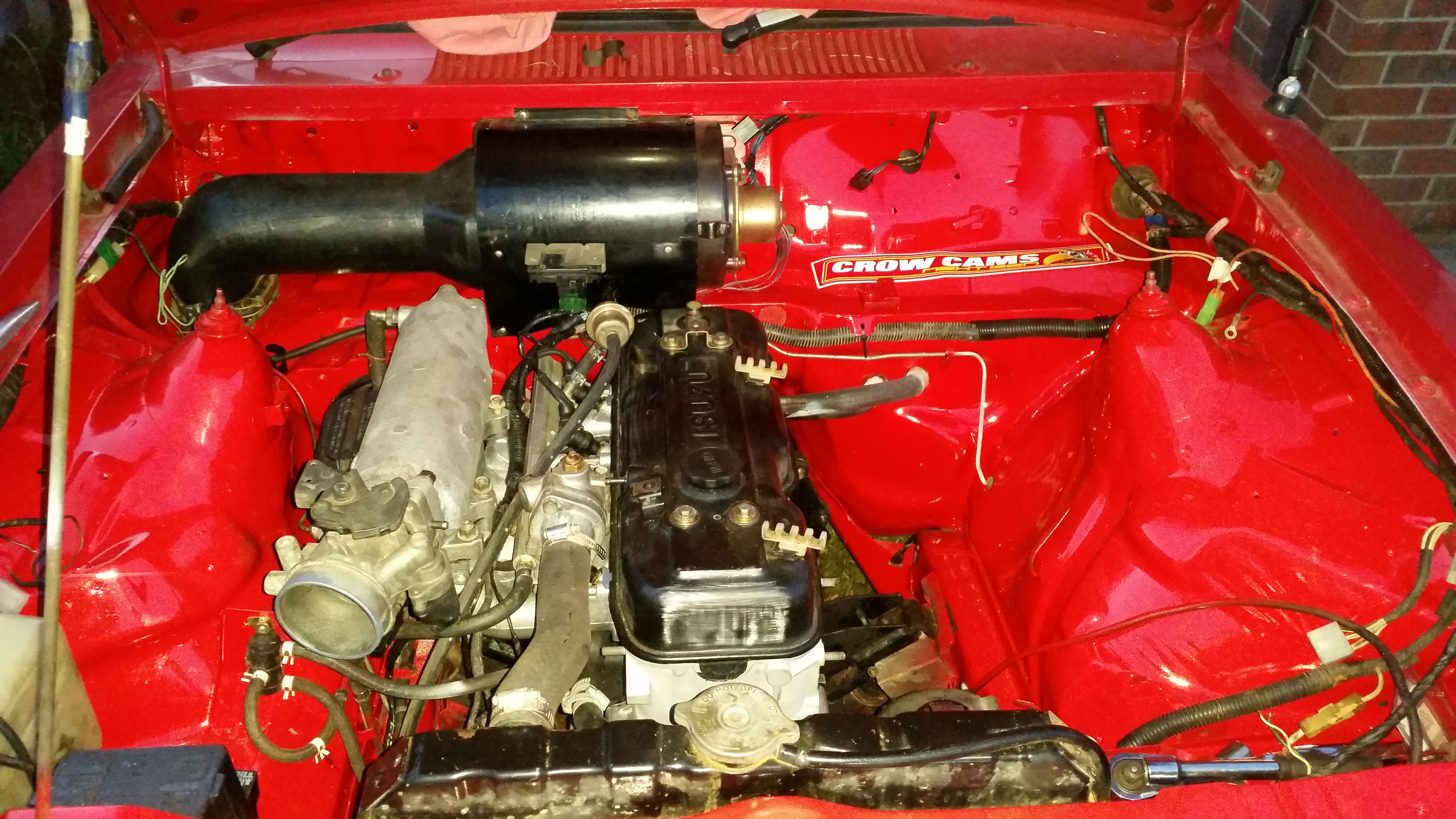

Re: gemini tuning help
Just a plain old gemini 1600 motor with the normal balancing of bottom end, bit taken off the deck
Per emissions ADR head with a mild can.
Intake off 4ze1 rodeo motor, custom plenum chamber
With VN throttle body.
N13 pulsar injectors and reg
Dizzy is stock with rb gemini (ugly fwd thing) reluctor
Feeding the N13 module
So just a normal Frankenstein

- Posts: 10111
The choppyness in the the RPM signal will be play in the distributor. Not a problem and normal for a system like this.
