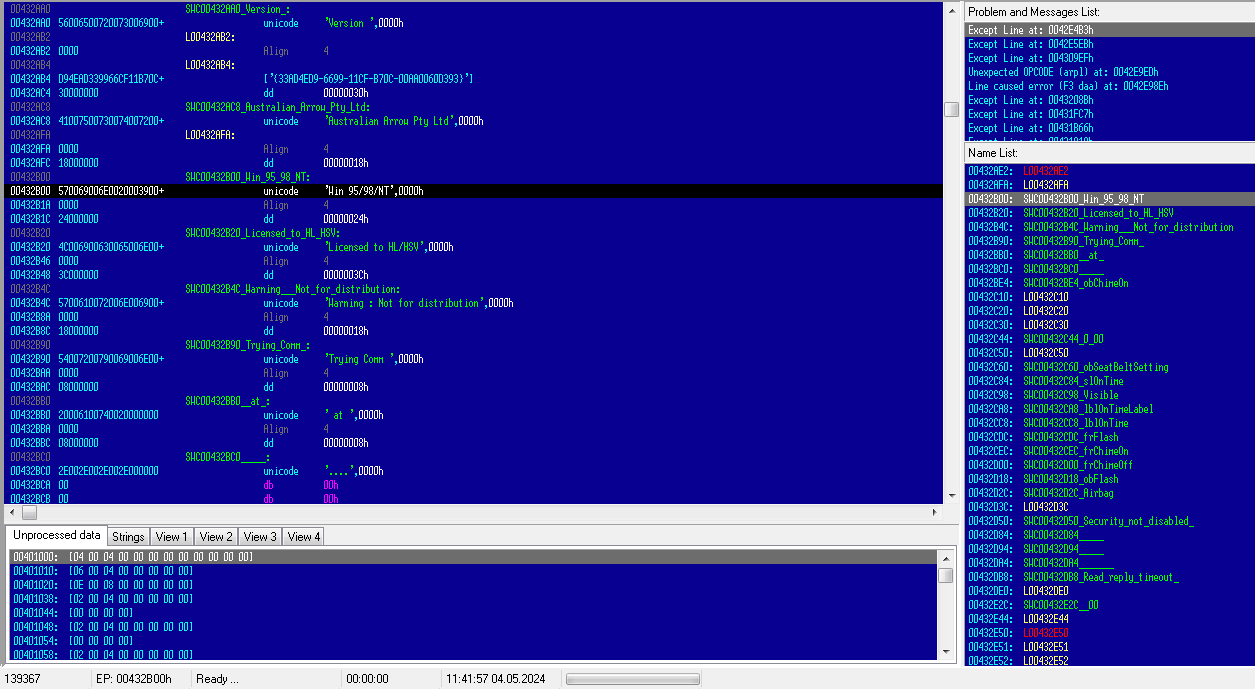

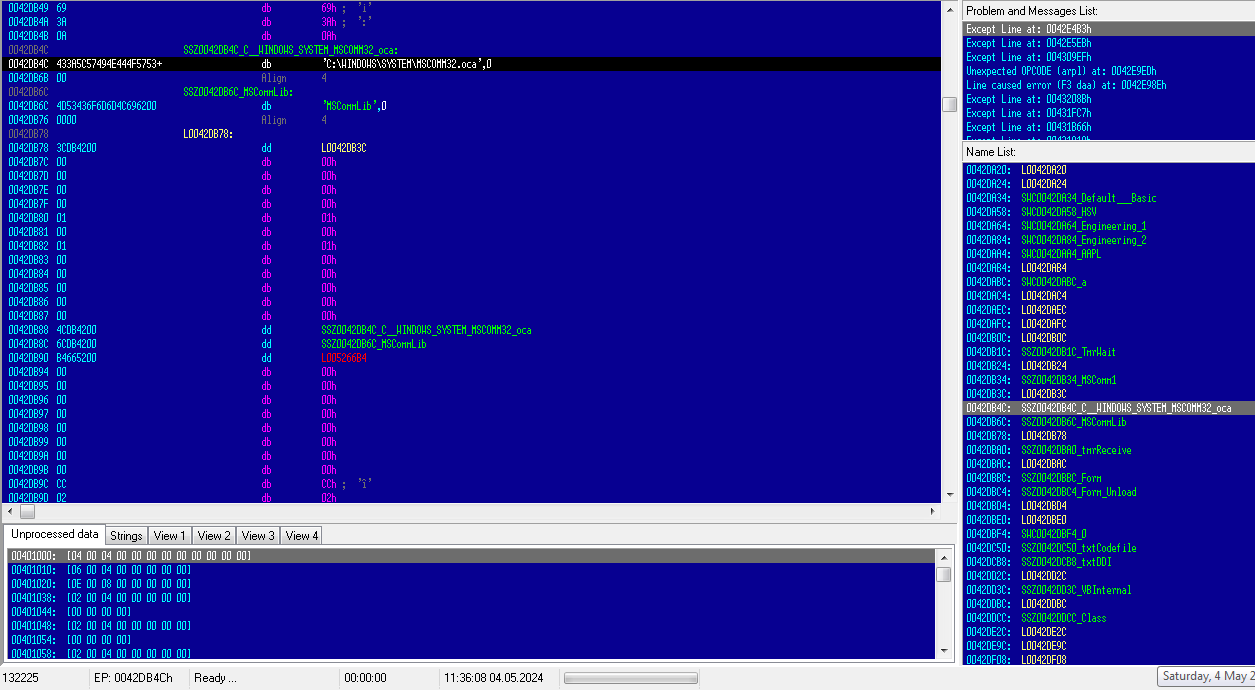

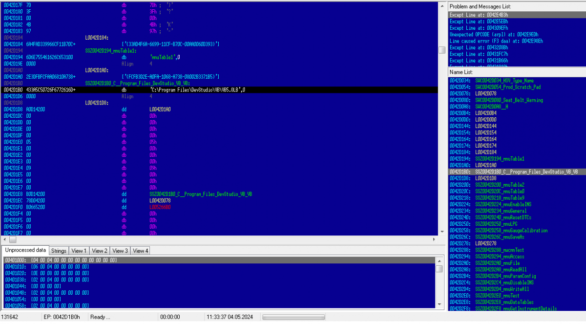

Apparently the above mentioned dash software is a no-no to talk too much about here on the forum so I wont get into too much
detail regarding it's potential/fucntionality, just mention what I found to work for me.
Firstly, using the wrong version of Common Controls gave me grief regarding functionality.
Secondly, the program has references to cache files that weren't part of it's download.
Apparently created by msvbvm when needed, though I'm thinking it's if VS is installed.
Thirdly, registering the program with regserver from the run command or command.com
eg:
|<------------Path------------\------File Name--------/
C:\Program Files\VYinsDiag\VyInsXXXXXXXXX.exe /regserver
command.com - Path\----------FileName-----/
C:\Progra~1\VYinsDiag\VyInsXXXXXXXXX.exe /regserver
It's targeted OS is mentioned internally, hence the path to the cache files.

I forgot to post a fourth step to getting it working in my post above, registering the .OCA cache files using regtlib.
just re-registered them again for the purpose of taking a screen of the outcome for the post here.
